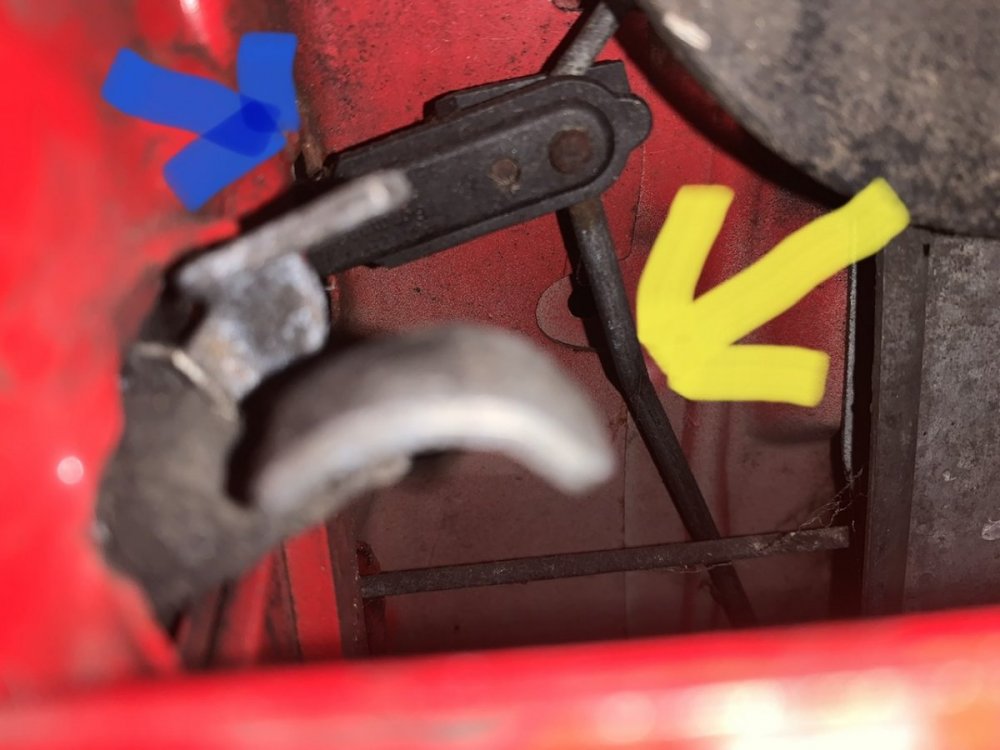

This might not help, but it might. The yellow arrow points to the lever that opens the door, nearest the outside, pushes down to open.
The blue arrow points to the locking lever...... down to lock, up to open.
Just in case you are trying to pull the front lever up the way, it needs to be pushed down

The lever pointed out in blue wont go up all the way. Ive gotten a coat hanger around it and pulled to no avail. The yellow lever moves but doesnt do anything with the door locked, neither does the interior handle. Looking at the working driver door, it doesnt seem possible to get to the latch from the inside.
I wonder if, as fendervg has suggested, that the lever(or a bit of it) has snapped off and is now jammed in above the locking lever? Maybe try pushing it down and see if anything drops out. I know it’s not exactly scientific but there isn’t much you can do except try a variety of what you’ve no doubt already been trying.

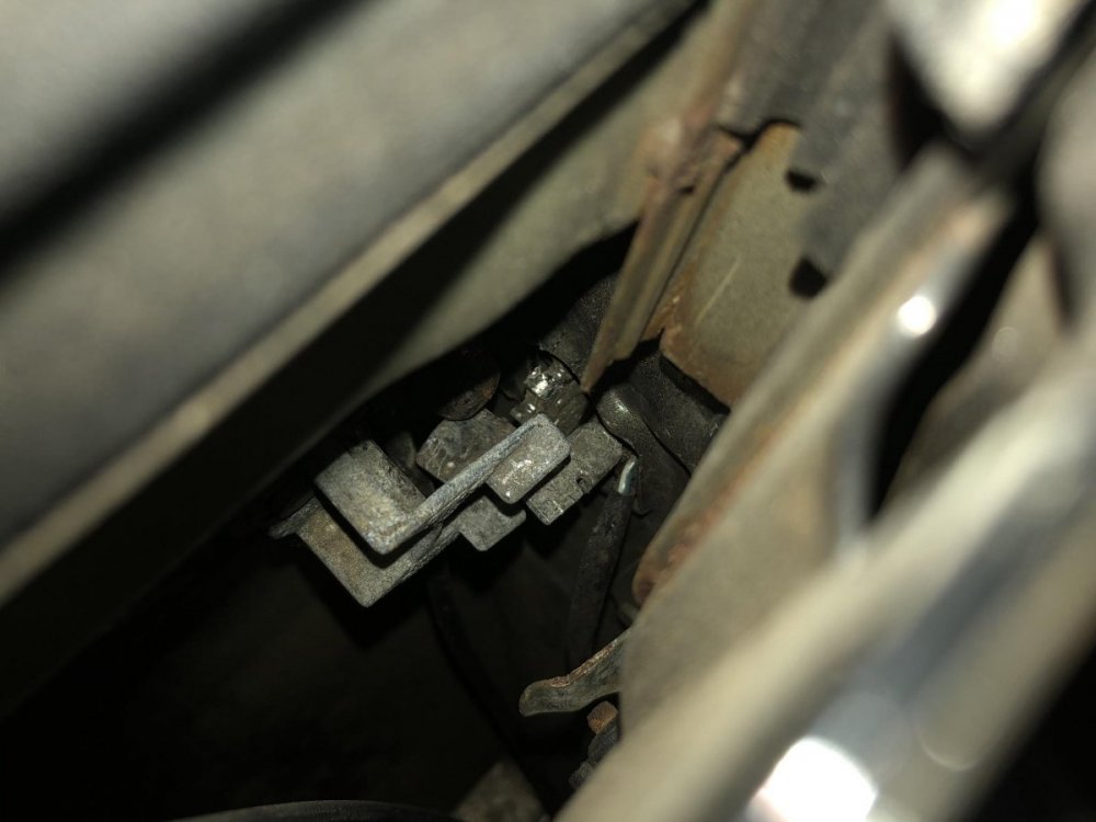

Can you get any pictures?
Can you see inside?
Heres the photo I got. You can see the push pin slipped off the lever but that isnt the problem. The lever with the notch in it is stuck in the lock position. I got a clothes hanger around it to pull it up and a screw driver to push down. It wont budge in either direction. I ripped the weather stripping out to get to the latch from the outside and try and manually get it to release. I practiced on the driver door and it is theoretically possible but I could not get it after trying for 2 hours. Looks like my next move will be to call a locksmith and if that doesnt work, start cutting. Anyone have any other suggestions?
