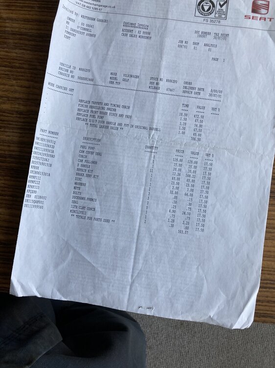

Keyo 49 Posted April 21, 2022 (edited) On 4/21/2022 at 11:03 AM, MJA said: Yeah you've done it right and can start from scratch treating it well. It really is pot luck without the rebuild if you're buying in at 150k like I did. I do expect the bill at some point! It is a bit of bad luck on your engine though, wonder why a SEAT dealer did it? Wonder how much experience they really have on that motor. At least it all behind you now though. I will dig out the receipt later and post - the only thing that worries me is the vsr flap failing and bits dropping in - famous on Bmw variables - they actually use a blanking plate aftermarket as have 6 flaps - must say though the vsr flap looks a lot more beefy snd well engineered then a Schrick flap . Happened to my mates shrick and bits rattled through block - well worth modding flap on a shrick to beefen up - Vince has a chap that can do it . There known as butterfly flaps in the automotive world . pictures illustrates Bmw butterfly and blanking plates . Edited April 21, 2022 by Keyo Quote Share this post Link to post Share on other sites

Keyo 49 Posted April 21, 2022 Not sure this is a second receipt could just be a head rebuild - but it says finish off building engine - could be a missing receipt . Quote Share this post Link to post Share on other sites
seanl82 23 Posted April 21, 2022 On 4/21/2022 at 12:16 PM, Keyo said: Not sure this is a second receipt could just be a head rebuild - but it says finish off building engine - could be a missing receipt . Finish rebuilding engine - £67.50! Bloody hell, I would have chanced it for that price! Lol Quote Share this post Link to post Share on other sites
Keyo 49 Posted April 21, 2022 On 4/21/2022 at 1:21 PM, seanl82 said: Finish rebuilding engine - £67.50! Bloody hell, I would have chanced it for that price! Lol Could of had a big bill before that invoice not sure . Quote Share this post Link to post Share on other sites
Keyo 49 Posted April 21, 2022 (edited) This is the next time chains was done - factory - seat 67k - Austin 156k - now stealth 160k with rebuild . I doubt seat would of used the uprated Mk4 as not even out yet ha , glad I got it on my newly built engine - so my car has had four sets in its life ., Note as this point I believe valves were bent all ready so a Damn waste of money by owner - perfect example of why I use stealth . Edited April 21, 2022 by Keyo Quote Share this post Link to post Share on other sites

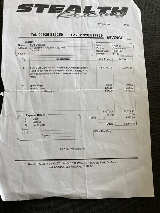

Keyo 49 Posted April 21, 2022 This is a tasty old receipt 👅. Quote Share this post Link to post Share on other sites
