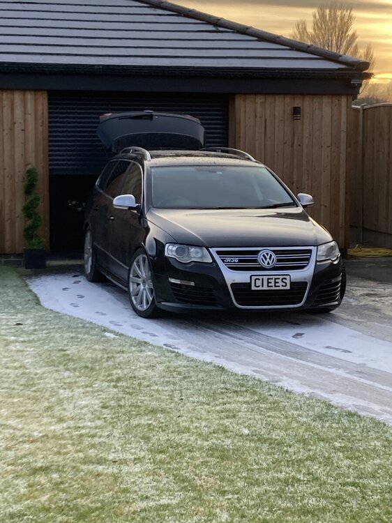

EJ Taylor 22 Posted January 18, 2023 This is the donor car. It is genuinely lovely. But she's nothing but a donor! lol. Quote Share this post Link to post Share on other sites
