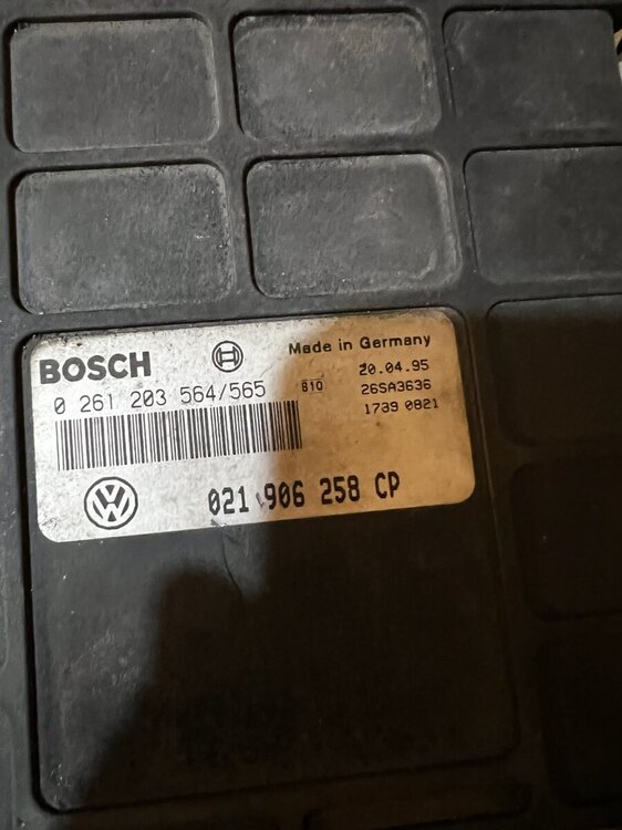

James. 9 Posted February 15, 2023 (edited) As per title. Delivered to Lancashire, or can collect if local. 021 906 258 B or CC prefix Edited February 15, 2023 by James. Quote Share this post Link to post Share on other sites

easypops 8 Posted February 21, 2023 (edited) 3 hours ago, James. said: That’s okay. The fact you’ve made an effort and got back to me is very kind of you. Thanks. Anyone else have an urban zoo they could navigate, and help get my car back on the road ? Closest I’ve got is 021 906 258 CP Edited February 21, 2023 by easypops Quote Share this post Link to post Share on other sites
fla 9 Posted February 22, 2023 Just a thought, the CP ecu has an immobiliser built in to it (like an obd2 ecu). Would it work to use the ignition halo ring in it, or perhaps an emulator? I assume it could then be used in place of other ecus, eg AG, B, etc Quote Share this post Link to post Share on other sites
