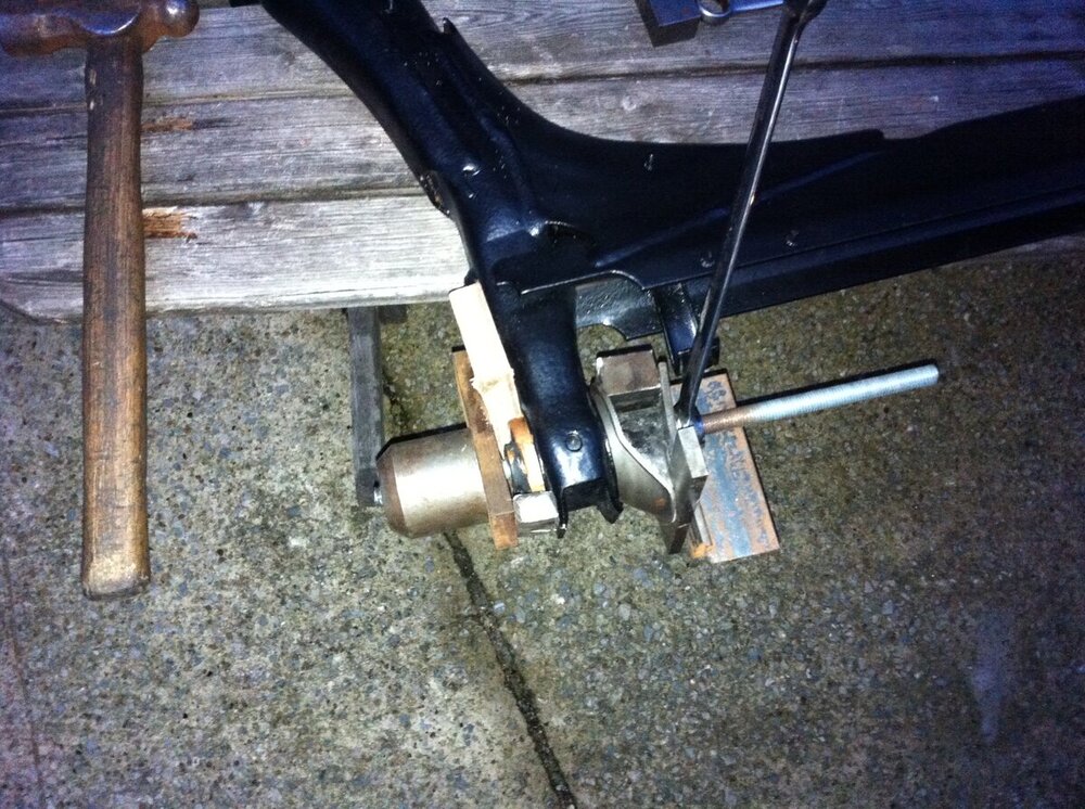

_Matt_ 26 Posted August 19, 2023 It is possible to do both in situ but is easier off the car.As for pressing in you'll need to get creative with what you have lying about to build something that ensures an even press across the bush's metal outer edge. You'll need some threaded bar and some washers and nuts as well.Sent from my SM-G990B2 using Tapatalk Quote Share this post Link to post Share on other sites
tonedef 8 Posted August 20, 2023 I took mine to the local VW independent who kept it a couple of days before phoning to tell me they couldn’t do it. So it was up to me to get “creative” as Matt suggests! The first one took a couple of hours getting all the steel blocks and packings set up, the second one took 10 minutes….I can’t imagine trying to do it in situ though, there really is nothing to be gained as you’ll already have disconnected the brake lines to lower it so there’s not much else to undo. The photo isn’t great but it gives the idea. Quote Share this post Link to post Share on other sites
