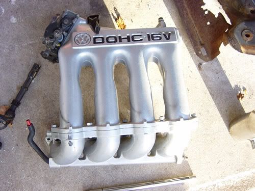

CazzaVR 0 Posted February 3, 2005 2 litre bottom end, 50mm golf inlet manifold, Weber Firebreather throttle body... if you can find one! Quote Share this post Link to post Share on other sites

Rossco 0 Posted February 3, 2005 I can vouch for the 50mm inlet fold doing the trick, ive jusr swapped over to G60 power so if you want my manifold just let me know looking for about 70 notes if your interested Quote Share this post Link to post Share on other sites
