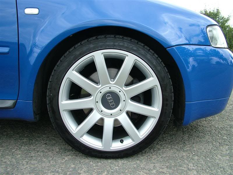

jedi-knight83 0 Posted August 23, 2005 i dont think they would go. those wheels... although they are 16s... dont leave alot of room inside. im away for a couple of weeks.. but presuming i still have the s3 when im back... we could meet and you could try the wheel on mine. Quote Share this post Link to post Share on other sites
jedi-knight83 0 Posted August 23, 2005 the 312's behind my lovely 18" RS4s think about it... the disc alone is 3.2 cm bigger than that disc... and the caliper will be the same if not bigger... i think your dreaming trying to get 312s behind there.... stick to 288s Quote Share this post Link to post Share on other sites

dinkus 10 Posted August 23, 2005 Ah cool, thanks for the offer Nathan, might have to take you up on that when you get back if I haven't sorted something out already. It's 3.2cm bigger in diameter, but it's only 1.7cm on each side, so they might just fit. It's going to be flippin close either way. Hmm, might be time to whip out Photochop... :lol: Quote Share this post Link to post Share on other sites

dinkus 10 Posted August 23, 2005 Um, yes it is :? :lol: Well I've photochopped it together and it's going to be very, very marginal, so I definitely need to try it out before spending money :? Quote Share this post Link to post Share on other sites
jedi-knight83 0 Posted August 23, 2005 haha photo shop wont show you anything cause the pictures will have been taken at different distances .... if i took mine from a mile away then the 312s would probably fit behind some nice 8" wheels! :D Quote Share this post Link to post Share on other sites
