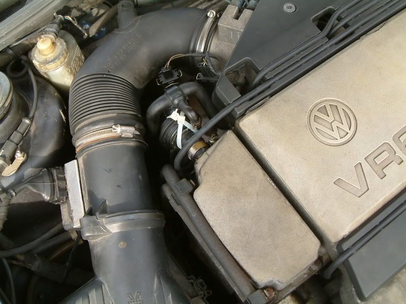

mic_VR 3 Posted March 12, 2007 Ok sorry to bother you guys but whilst trying to fix some issues I have with my braking I've accidentally broken something else on the car :( Its the bit currently held on with cable ties. Anyone know what it is/part number so I can get a new one? I've tried to repair it as best I can but not sure what effect it'll be having on the motor as it's still leaking oil/pressure under load. Any help would be appreciated. Quote Share this post Link to post Share on other sites

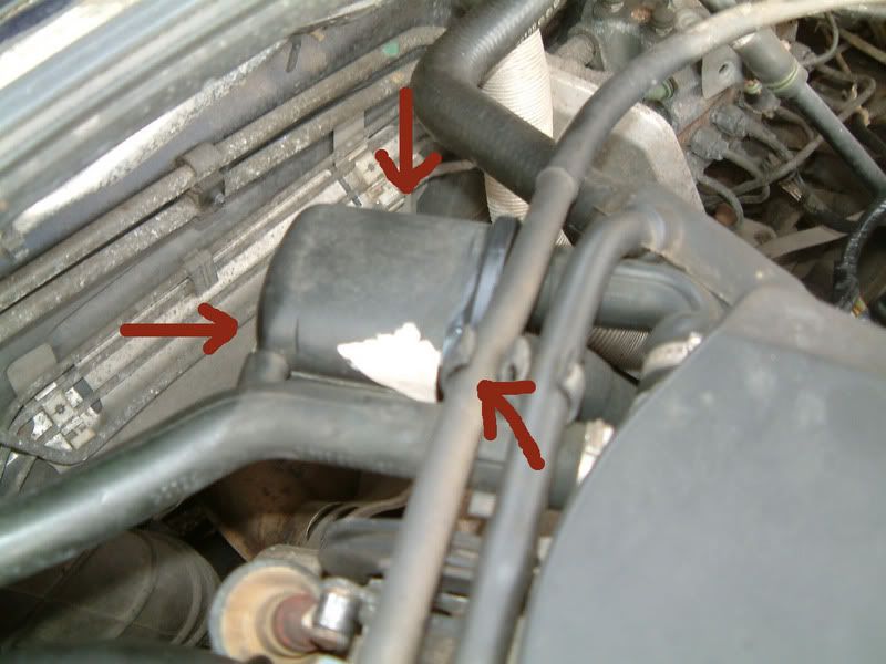

mic_VR 3 Posted March 12, 2007 oooh while we're on the subject of broken things, any idea what this is etc? It was already broken when I brought the car but seems like a good time to replace it Quote Share this post Link to post Share on other sites
diggerbucket 0 Posted March 12, 2007 Hey I just broke that thing in the second pic whatever that is :lol: Just where your leftmost arrow is pointing, the big lumpy bit broke off the pipe heading off to the left of that pic? Technical terms being used here :lol: Quote Share this post Link to post Share on other sites
mattkh 0 Posted March 12, 2007 Hi THe thing held with white ties is PCV. See my threads about it. Quote Share this post Link to post Share on other sites
KieranM 0 Posted March 12, 2007 the first pic is showing the pcv valve - vw want to sell you the whole intake part for lots of money, but the ford galaxy has the same part and ford sell you it for about £30 apparently (i need to get it too... ) check out this post: http://www.the-corrado.net/.archive/forum/viewto ... ht=#633616 It also has the part number from ford too. HTH Quote Share this post Link to post Share on other sites
tonedef 9 Posted March 12, 2007 I had a broken PCV for ages, tried a fix with super glue after cleaning it up first with brake cleaner and it seems to have held OK, it's lasted three months now anyway. I haven't yet managed to break the ISV so no comment there :lol: Quote Share this post Link to post Share on other sites
CrazyDave 0 Posted March 12, 2007 mic_VR, The broken part leaking oil / vapour is the engine breather hose and fuel vapour recovery system. It allows the fuel tank vapour to be burnt off when the engine is warm rather than just venting it to the air. Do a search for 'carbon AND canister' it can be removed easily and the vent piped either into the inner wing or the lower half of the air box so the vapour still gets burnt off. I've just removed all this stuff from my car and piped the engine breather from the rocker cover into the inlet hose, but I plan to add a catch tank to get rid of the oil before putting the vapour back into the inlet. Depends how much you get really. Hope this helps. Dave Quote Share this post Link to post Share on other sites

CrazyDave 0 Posted March 16, 2007 Pretty much remove most of it, seems to be a mix of opinions on if you should pipe the tank vent to the airbox or not? I'm going to give it a go as I don't like petrol smells. Leave the solenoid valve that's fitted to the inner wing. The ECU may throw a fault if you unplug it? But mine will be running a standalone ECU so I've removed it. Yes, carbon canister is below the airbox so ideal for cold air feed. Have fun! PS looks like you're missing the upper heat shield from the back of the engine bay? Quote Share this post Link to post Share on other sites
Taggart 0 Posted March 16, 2007 The second pic is the ISV damper. Quote Share this post Link to post Share on other sites

Critical_Mass 10 Posted May 5, 2007 Thread Resurrection...! Sorry to open this thread again. Looking at the 1st pic, my VR doesnt have the circular Valve. It has the thinner rubber tube coming out of an air intake, then theres a plug, THEN it goes straight into the block. Nor does it have the pipes going over the top of the thinner pipe that goes into the head- instead one single pipe goes under it and to another sensor in the air intake. But it doesnt split. Am i missing something which is necessary? Shown in pic- Quote Share this post Link to post Share on other sites
mic_VR 3 Posted May 5, 2007 Critical_Mass, I think some people just remove the pipe as it's pretty brittle in places and is easily damaged but TBH I would love to know what the best answer is for this because my VR is still not running right and I don't think having the broken tubing glued together as I have at the moment is helping matters. Anyone out there know what is the best solution? Replace vs Remove....... Oh and I've now replaced the ISV damper box (2nd pic) and put the leads on the holders in the correct layout (sorry Therapor) Quote Share this post Link to post Share on other sites
Critical_Mass 10 Posted May 5, 2007 Cheers mic_VR. Would that valve missing cause the car to run badly? Quote Share this post Link to post Share on other sites
mic_VR 3 Posted May 5, 2007 well as long as the tubing that was there wasn't leaking air then I don't think it would run badly. Its causing problems on my car because the engine isn't able to maintain the air pressure it needs. It's like if you start the car with the oil filler cap loose/off the engine, the car starts but tries to stall straight away unless you've got the throttle open and even then it'll run really rough. I am hoping to get a new valve and the pipework for it over the next few weeks so that I can clean up all the air intake and throttle body, which at the moment I can't do because its too badly damaged and I know if I take it off it'll never go back on! Is yours running rough at the moment? If not i'd be interested to see a pic of your setup to see if I can re-arrange mine. Quote Share this post Link to post Share on other sites

CazzaVR 0 Posted May 6, 2007 Critical_Mass, mine was set up exactly like yours is when I bought it. Ran fine, but I have since bought a new valve from Ford, because without the valve a little oil makes it into the intake. Also need the hose that connects to the top of the valve- trying to source one from a car being broken. Quote Share this post Link to post Share on other sites
KieranM 0 Posted May 6, 2007 My valve was completely shot, the car ran fine, and that didn't change when i replaced it with the new ford item. In fact, i went on a rolling road whilst it was still broken and got good power so i wouldn't think it would affect how well it's running too much! ps, if your wondering what the power was - 201bhp completely standard. Quote Share this post Link to post Share on other sites
