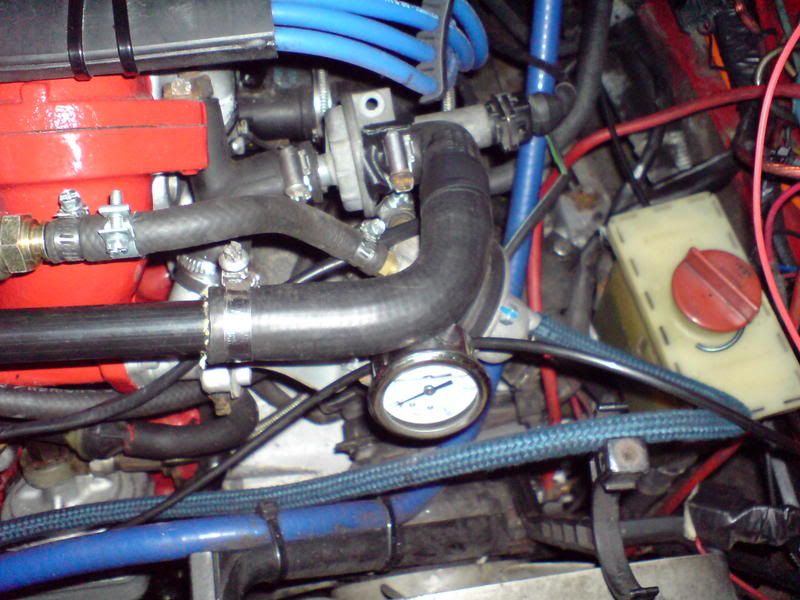

waynos 0 Posted February 24, 2008 right after much fiddling ive got the aux air valve on,suprisingly it works very well. heres a pic - if you follow the pipe above the pressure gauge (which comes from the intercooler) it goes through the air valve and into the inlet manifold now im having few more problems the first is that i cant get a factory like start. after a bout 5 or 6 seconds cranking it tries to start then gradually catches and idles nicely. is there any settings i can adjust to fix this? the next problem is that after its sat idling for a little bit .it starts hunting (afr readings fluctuating with it) then it just dies! if you restart it does the same thing. The final thing is if you try to rev it, its very slow to respond like a lag kind of feeling.im not sure what that could be. heres the log Quote Share this post Link to post Share on other sites
CrazyDave 0 Posted February 25, 2008 Nice one Wayne! Not been in here for a little bit, busy at work. Good news then! You've now only got a few weeks of fiddling with settings to get it running nicely (only kidding! But the temptation to mess now you can is just too tempting). Initial starting is all about ignition timing, crank pulse width and prime pulse. As the book says, don't try to adjust the prime pulse to compensate for crank pulse. It's just to get the fuel rail up to pressure and clear any bubbles etc in the (maybe very hot) fuel rail. It needs to be within about 1% or the required mixture to catch first time, and you only get 1 go at a cold start. Looks like the warm up enrichment is falling off too quickly. The AFR goes lean but just before your injector pulse width has started falling. Increase the warmup enrichment a little at that water temperature and try it. Revving up needs ignition timing and fuel. The ignition needs to advance when you open the throttle and I can't see any change in your logs. But also the MAP reading doesn't change much when you part throttle so you many need some more sites in your map at about 35-40-45-50-55 kpa. Then you can setup ignition advance of an extra 10 degrees ish when you crack the throttle open. Great work, feels good when you did it all yourself :D :D :D Quote Share this post Link to post Share on other sites

CrazyDave 0 Posted February 25, 2008 Warmup enrichment within 1%. Takes some getting right but it's the difference between leaping into life and what you have now. I forgot to mention that if you run the tuning of the ignition table you can watch the little dot moving around when you open the throttle. Watch how it moves and tune the sites it moves through with the more advance the closer to 100kpa it gets. Hope that makes sense? You're right though, get the idle stable first and then move on. Quote Share this post Link to post Share on other sites

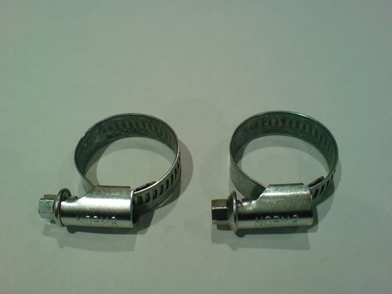

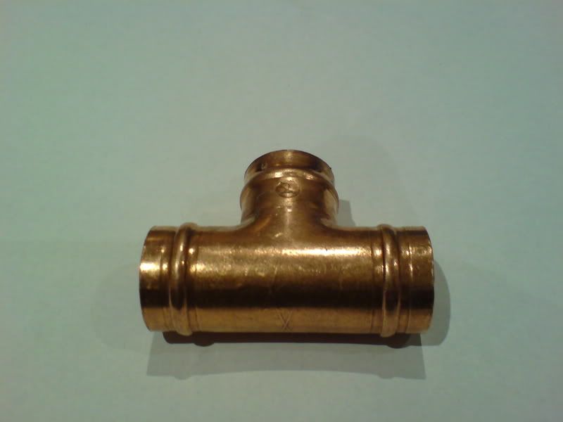

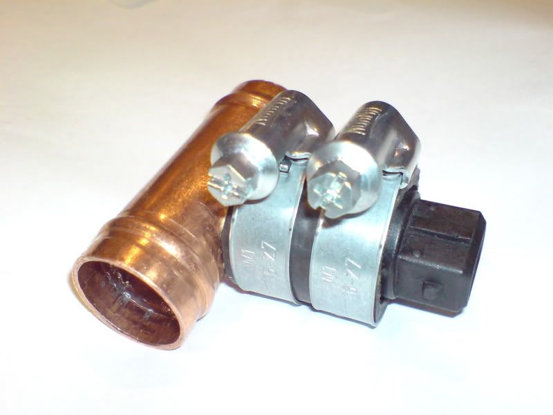

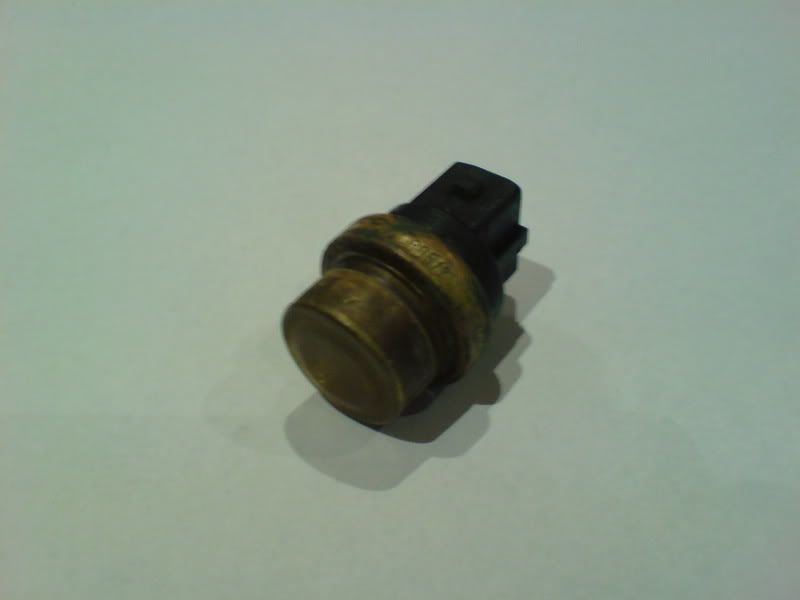

waynos 0 Posted March 1, 2008 oh and i almost forgot, the original coolant sensor was giving some strange readings before - like 160 deg c or more when warm! i had an old polo coolant sensor knocking around nd decided to give this a go. managed to get all the resistances at different temps to put into megatune. just a quick how to got a t piece from homebase some coolant pipe and two circlips heres the sensor and the finished article i placed this inline with the coolant pipe that comes out the side of the block. It reads much more acurate and responds a bit quicker to temperature changes Quote Share this post Link to post Share on other sites

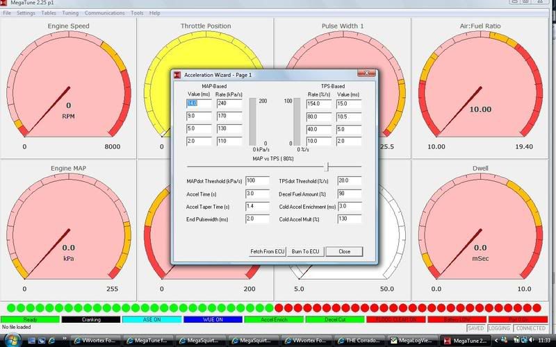

waynos 0 Posted March 8, 2008 lol this car is annoying me, i still cant get it to rev properly. ive tried loads of different ignition maps with no sucsess,even tried moving the dizzy to see if that made any difference. im pretty convinced its the acceleration enrichment settings but i have no idea what i need to do to get a better response heres the settings and a couple logs Quote Share this post Link to post Share on other sites
dirtytorque 0 Posted March 8, 2008 acceleration enrichment should only come into play with rapid throttle openings. if you just gradually open the throttle does the engine rpm increase in a linear fashion? Quote Share this post Link to post Share on other sites
waynos 0 Posted March 8, 2008 yea i can rev it very slowly but if i try to blip the throttle it hesitates then revs.if i could get my head around what everyhting means i reckon i could sort it. ive also noticesd the afr goes lean when you try to blip it Quote Share this post Link to post Share on other sites
dirtytorque 0 Posted March 8, 2008 i wish i could help more but I am a couple of weeks behind you. I would try and use the logs to home in on the point where it stumbles and see what the engine inputs are the telling you,i.e what is your lambda sensor telling you? Does it matter if the engine is cold or hot? Are you happy with your VE table? You should really tune VE b4 attempting Ae apparently. Hopefully Crazydave will chime in and help you. Good luck.You'll be an expert by the end of this,then you can help me get mine running. :) Quote Share this post Link to post Share on other sites
