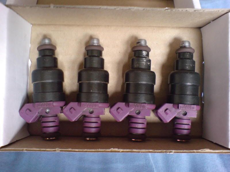

waynos 0 Posted March 14, 2008 i gave up on the cossie injectors, just bought a refurbished set they had for sale.they have quite a few more! they turned up today but i wasnt in so ill be down the post office early to get them! hopefully this time tommorow i shall have a nice little update for you all lol fingers crossed Quote Share this post Link to post Share on other sites
waynos 0 Posted March 15, 2008 got the new injectors the car stil needs a high required fuel to start but im not too fussed about that. Managed to get it to start without any throttle by messing with the cranking pulswidths. fuel pressure is at 3.2 bar now also. Ive stil got the problem trying to rev it. Log and msq below (change the end of the map file from .txt to msq) Quote Share this post Link to post Share on other sites
waynos 0 Posted March 16, 2008 good news at last!!!! i set up the fuel pressure regulator properly (see other thread in engine section) then i set my required fuel to what the calculator said. Turned the key and it fired up better than it ever did! The throttle stop has been wound back off so its almost closed and i also dont need to give it 20 percent throttle opening just to get it started! result!!! it now revs properly without any hesitation that i had before. the tuning begins as from tommorow (weather a bit crap today) heres my log and the updated msq (remember to rename the map file to .msq) Quote Share this post Link to post Share on other sites

waynos 0 Posted March 16, 2008 i think the injectors were fine to be honest. i wanted use high impedance ones anyway so that isnt an issue. once i get paid i will be on the lookout for some 400cc or more. I think the hesitation was down to the fpr not being hooked up correctly! my required fuel is down to a nice 13.6ms rather than 22s! Quote Share this post Link to post Share on other sites
