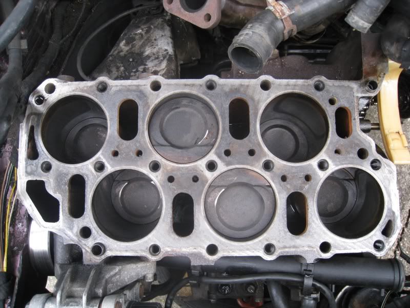

tandino 0 Posted August 17, 2008 Zak ive got a 2.8 you can have for 150 quid. My car had a 2.8 in it when i bought it and to be honest it doesnt feel any different to the ABV lump ive got now. In fact it was a better engine in reality as it didnt smoke on the overun!, it is in an Autobox'd Golf so i really dont think its had a hard time. 110k miles... I would guess the intermediate pulley bolt has worked loose, both sets of chains route round this pulley and if you do not torque this bolt upto 75lb/ft it will work loose. Dont ask me how i know,sometimes working with a mate who owe's you a few favours is not a good idea as you dont always know if they have done things up tight :shock: :shock: Quote Share this post Link to post Share on other sites

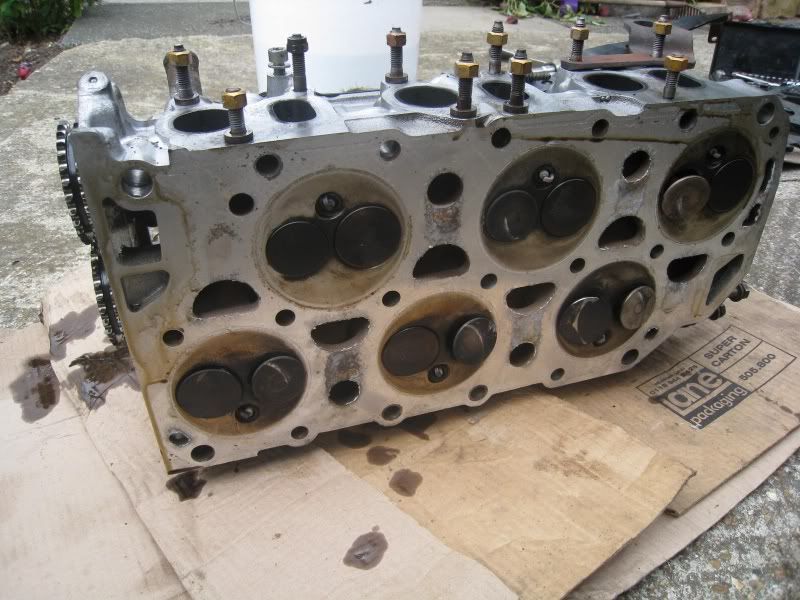

zak 0 Posted August 17, 2008 tandino thats exactly what happened, that particular day a mate came to help me out and i guess it wasn't torqued correctly. heres the damage 6 bent valves and a few marks to the pistons, the bottom end seems fine, turned it over a few times and the pistons all come up to the same level. I'm thinking of replacing the damaged valves and putting the head back, but this wont solve this smoking issue so not sure if this is the way forward. How expensive are valves? Hassans already offered to let me use the spare ones from his spare head, is there any issues with this? I hear you guys on the 24v route but i have a business that eats in to a lot of my time and i will be starting evening classes in september so really do not have much spare time to take on a conversion that might drag on. Quote Share this post Link to post Share on other sites
Toad 0 Posted August 17, 2008 :( Balls. Was your head pressure tested? I wonder if there's a crack allowing coolant into a cylinder? Quote Share this post Link to post Share on other sites
zak 0 Posted August 17, 2008 no it wasn't pressure tested, if i knew there was such a test i would have asked for it when the machine shop had the head, how much does it roughly cost? Quote Share this post Link to post Share on other sites
Toad 0 Posted August 17, 2008 Dunno on price, not a lot of money I wouldn't imagine, but I'd get them to do it before getting your new valves lapped in. Quote Share this post Link to post Share on other sites
