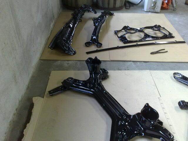

Black drivetrain + some front parts+fan frame:

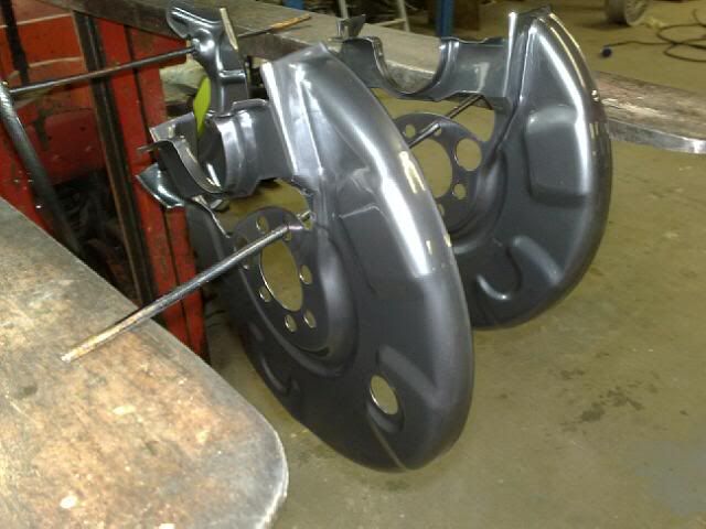

Black Chrome "dirt protectors"
290720091301.jpg?t=1248886271
serious bit of work you got going on here! nice one :D
What is the black chrome effect on the dust shields, is it something that comes in a can, powder coating or hot dip??
Looks cool by the way :)
Powdercoating - Color is called "Black Chrome", haven't seen it yet, but I think it's a bit "darker" in real life though....;)

Subframe almost finished assembled, with new R32 rear bushings, new front bushings:
New ball joint and swaybar end link:
The wheelhub and dirt shields:
More dirt shields and wheelhubs:

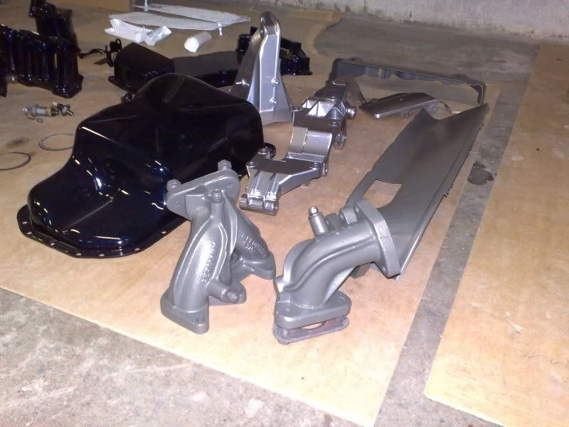

A small update with some pics from the powdercoated manifold ++++
Some of the stuff:
061020091402.jpg?t=1254864455
Manifold:
061020091408.jpg?t=1254864520

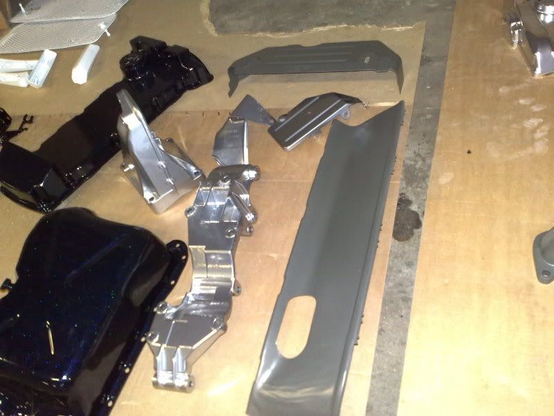

Oil sump:
061020091403.jpg?t=1254864454
Might not come out correct on the pic - in real life it seems almost black....;)
It looks to me like a funny mottled dark blue in the pics, which I think is immense. I'm sure it looks great in real life though.

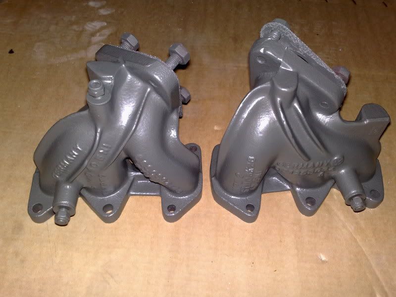

The exhaust manifold with ceramic coating:
251020091472.jpg?t=1256511940
some other bits with ceramic and powdercoating:
251020091474.jpg?t=1256511940
251020091471.jpg?t=1256511940

Finaly got my latest parts back from powdercoating and ceramic coating - so for any interested here is a few more pics:
Maybe the colors are a bit more correct here then the previouse pix - it still got some "spark" to it though...lol
Oil sump:
DSC_4032.jpg?t=1256930990
DSC_4033.jpg?t=1256930990

Exhaust manifold:
DSC_4039.jpg?t=1256931005
Engine mount:
DSC_4040.jpg?t=1256931006
Bracket:
DSC_4041.jpg?t=1256931007
