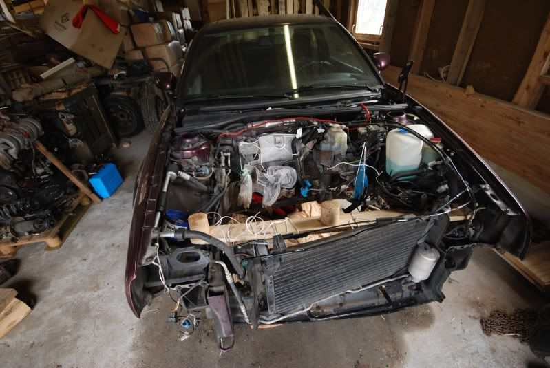

Mawrick 0 Posted August 26, 2009 Ok, can't remember exactly now but it might be a bit better room if you remove the fans and radiator also, I did this on mine (as I pretty much have disasembled the whole car), but not sure if you realy need to....my ac "radiator" is still on there though. As the car sits today: EDIT: apart from that the "undertray" thingy there is painted....:) Quote Share this post Link to post Share on other sites
