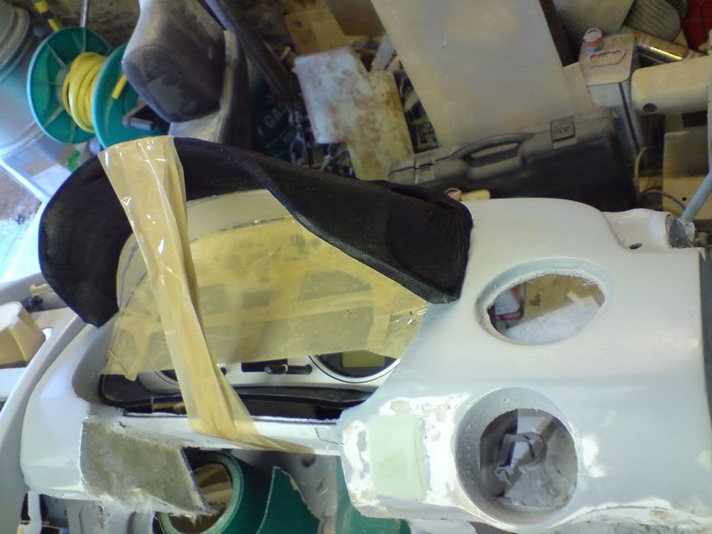

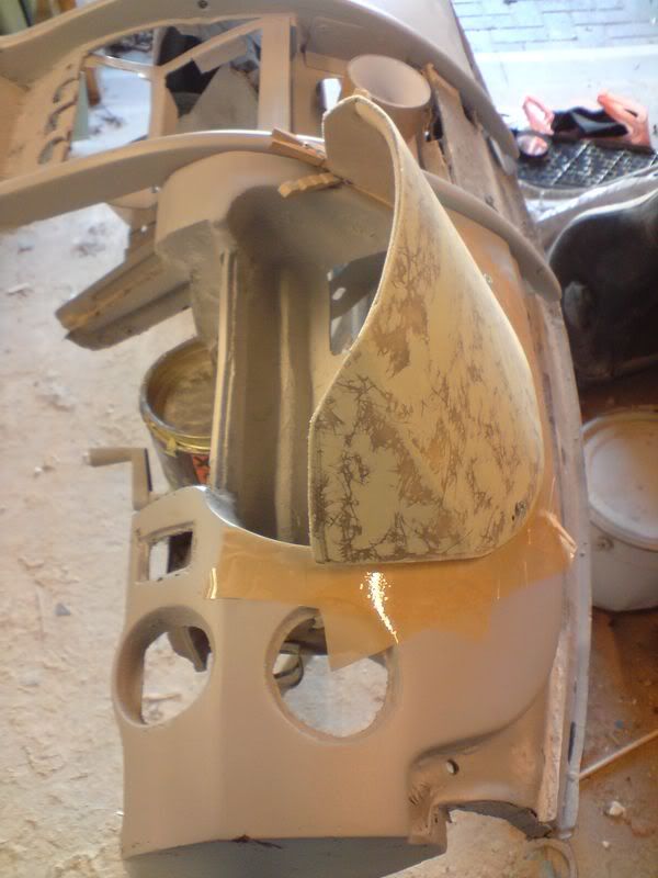

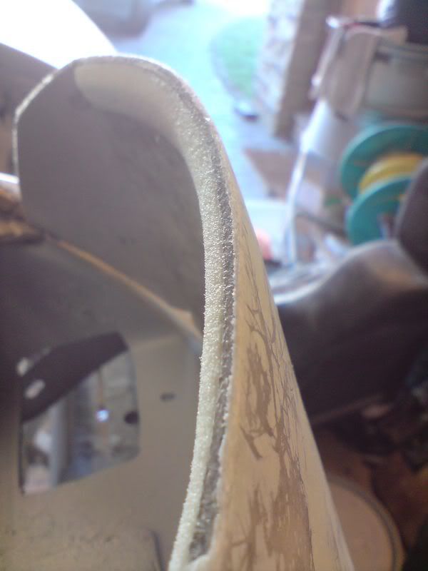

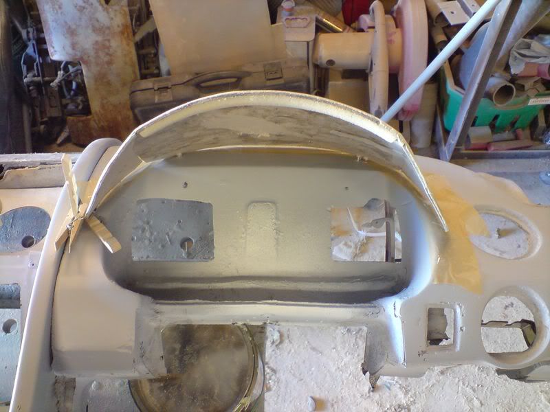

Here the pics of making the new binnicle, modeling foam was attache to the leading edge and then a small jig made up to form a constant shape to the front edge. I then added card to the dial cluster and stretched a pair of tights over the binnicle and pushed the dials in. Resin was then painted over the tights and left to cure a thin skin, it holds its shape now ready for a few layers of glass fiber. This would ensure a perfect fit later.

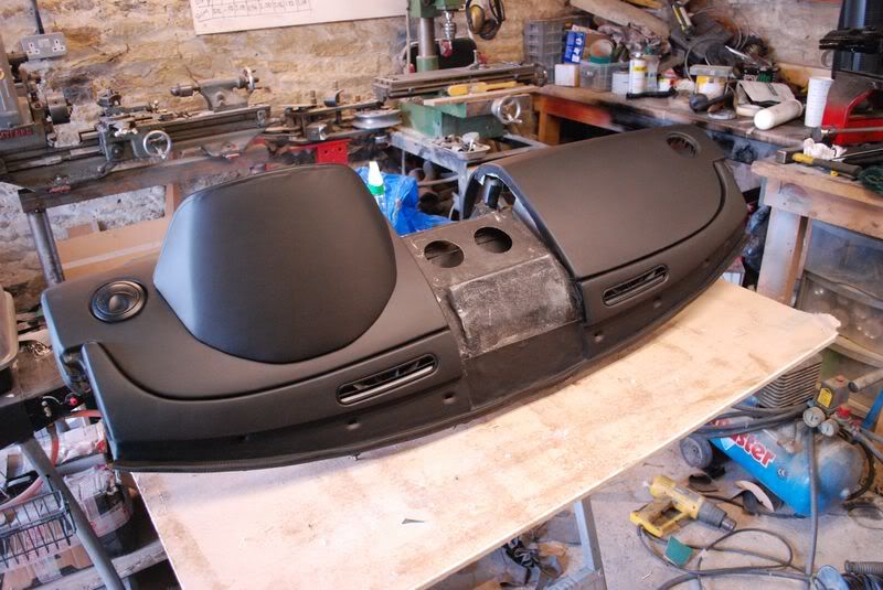

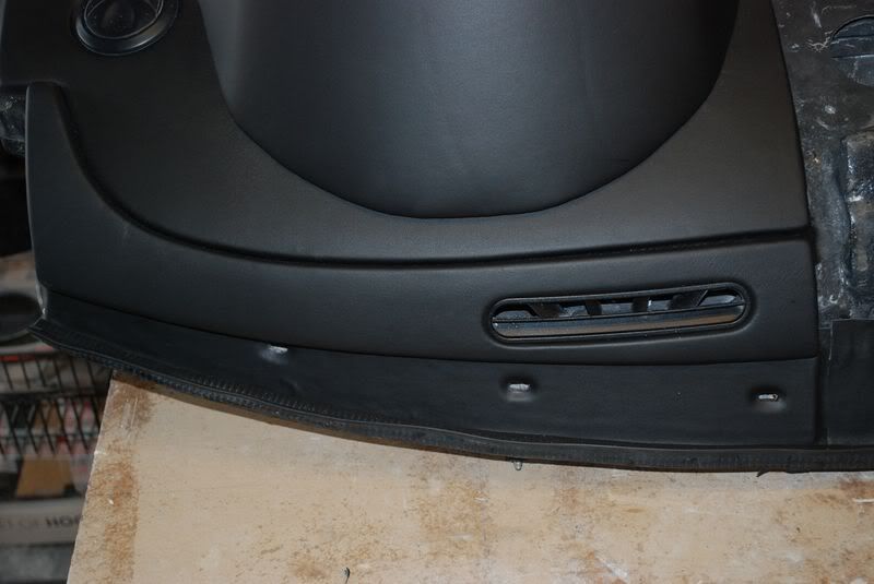

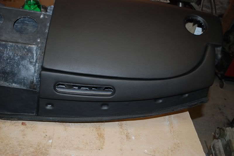

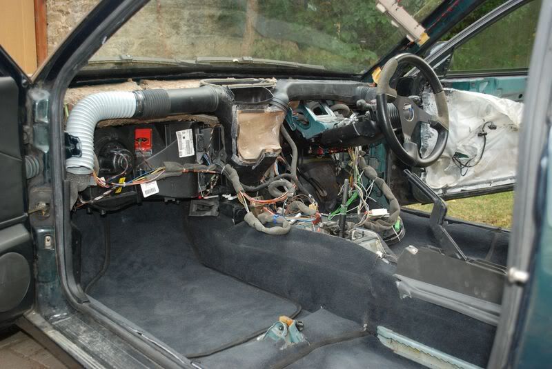

Didn't do much tonight but I have finally started to assemble part of the car for the final time (I hope!) heres a few pics of the dash. A few closeups of putting the flipseal on the front again, then the interior of the car showing the modified heater ducts, then with the dash fianlly fitted.

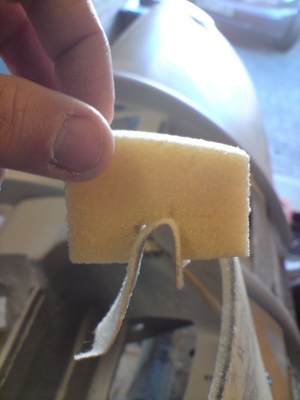

Oh yeah, these also show the carpets I made a little while ago, its BMW mini carpet in charcoal. Bought it on the roll, most of it is made from flat parts but there were a few bit I needed to pattern up and shape. Where I had to have a break, the edges were bound with webbing and the stitching hidden.
Need to hire a carpet doctor to bring them up again as I've been getting in and out of it for the past year making and fitting the interior!
best is yet to come.... ;-)

Thats the word - breathtaking. Nothing else to describe it. How did you do the whipping on the carpet edges Doug?

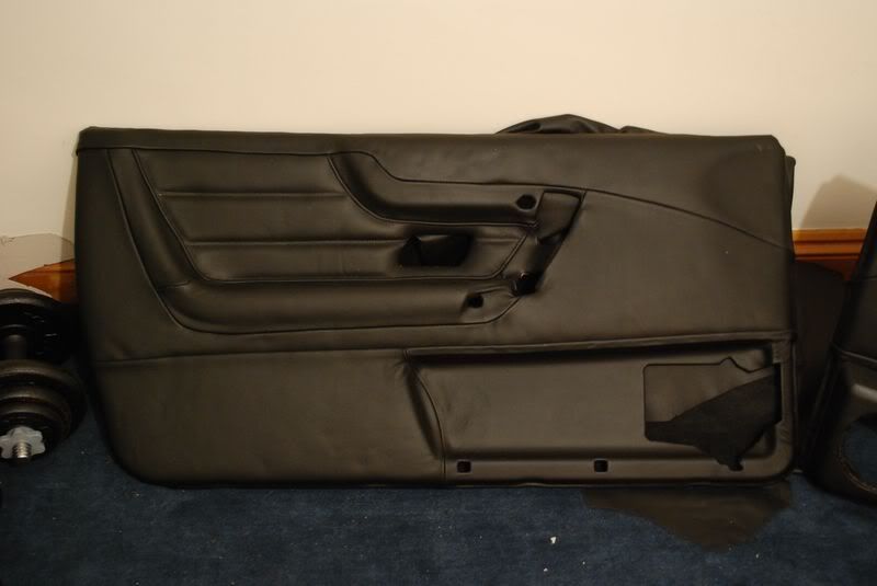

Heres a little bit more of the interior.....

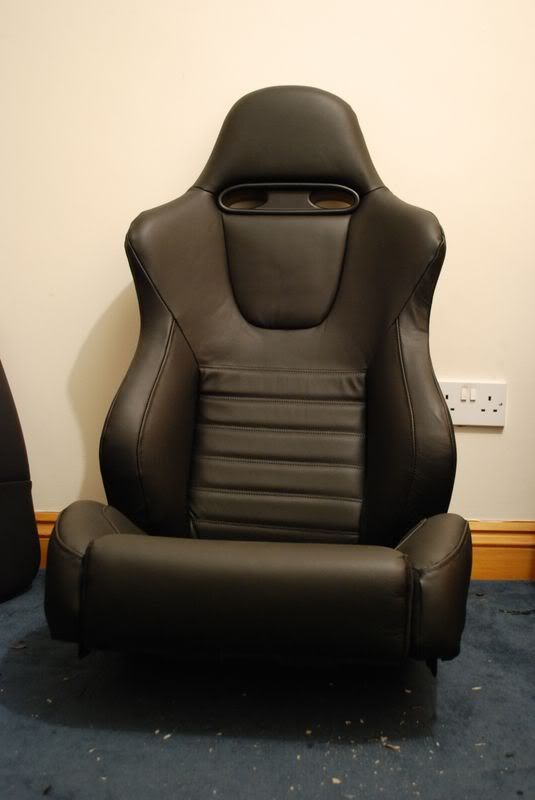

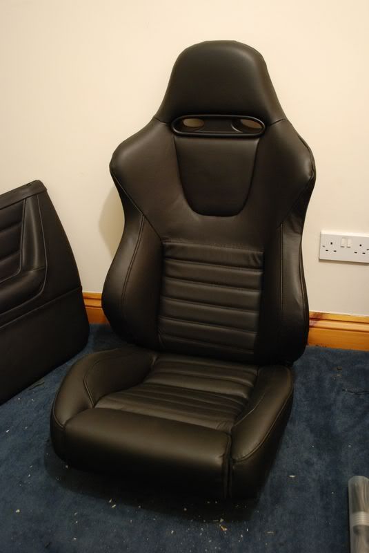

The seats are Recaro speedline seats with electric height adjust and twin lumber supports. They were the first part of the interior I re-trimmed and the paneling was inspired by the new scirroco. I also added extra panels to the bolsters which have helped to visually narrow the seat and I think make them a little more modern in style.

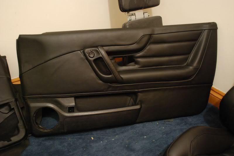

The door cards were a lot of work. I changed the the paneling to tie in with the seats and also changed it so that the panels ran horizontally, the panels around the arm rest were also changed so that the padded section didn't run over it. I've never liked the way the leather rucks up on the origonal leather door cards. Also all the edges of the plastic parts as well as the leather that will touch the paint have had anti squeek tape ran around the edges. This should help loose any squeeks or rattle when its finally assembed..... finally!
Fla, will try and get a few pics of the edging on the carpet later....

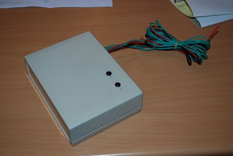

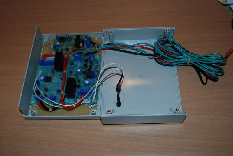

I got to maplins today and sat in there with all my circuit boards then emptied the shelves to find a box that they would all fit into. turned out to be quite a big box but I did a good bit of work consoldating some of the parts of the boards into smaller parts etc, as such I have less wires to connect up now.
If all this turns out to work ok and I pursue building a plug and play kit I reckon the circuits and components could be reduced be a much much smaller unit, it you can get double sided surface mount boards made at a sensible price this thing could be tiny. As for wiring it up, it only needs 5 wires connecting!
Heres a few pics...
The two leds will be tell tale lights to show me whats working and when - there would be no need for these in the finished module.

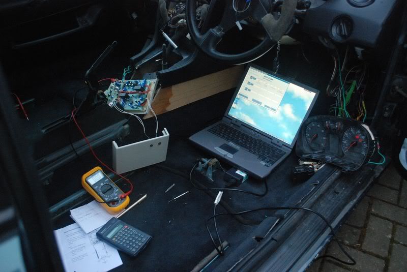

not much to report today, I got the 'CCU' in the car and wired it up. Here a picture of when I had it all in bits to set it up. This first test fit has shown that I could do with changing a few components to improve a couple bits but thats 'development' i guess.
I did a static test i.e. with just the multimeter connected to the output wires and to all toggle on at the correct time so the next thing to do is get the varable inlet wired in and then its time for a test drive!! I know I've said it before but this time I really think I could be booking it in for a rolling road tune this week and I'll finally see if it produces a drive similar to the mk4. Actually that had made me think, does anyone have any graphs of a standard 2.8 AUE engine MK4 golf for a comparison..?
