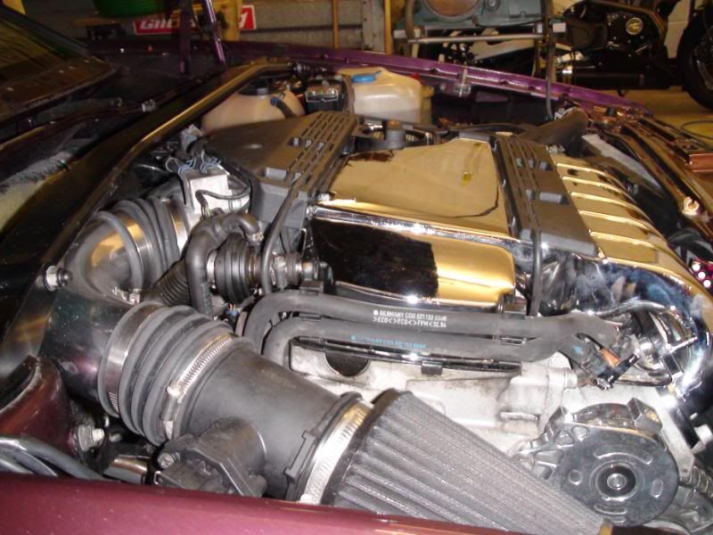

looking good as ever mate. really like the rims. are they really that hard to look after. im 2 minds whether to get my rims(any more analsol?) done the same

at present they are a kin night mare to look after but then i dont get tthem clean enought to stick any sealer or wax on them !!!
there was probably about 6-8 weeks of crap on them!! lol so pretty fecked!

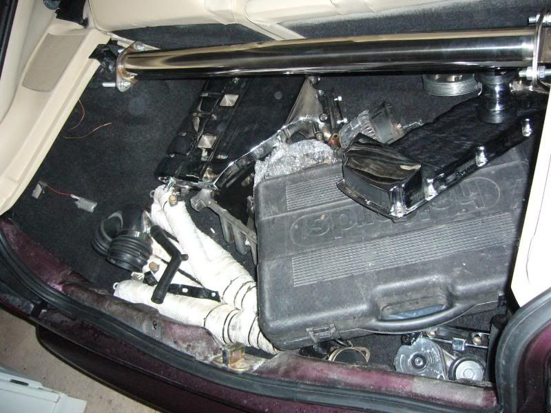

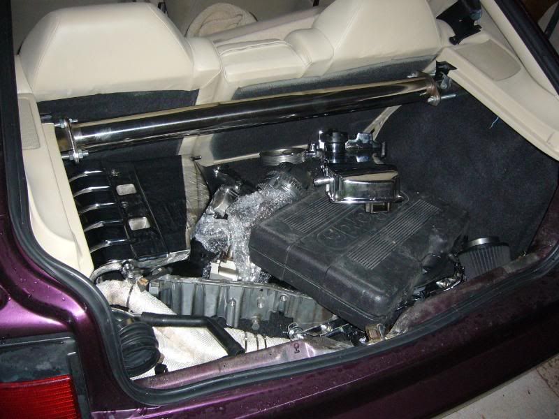

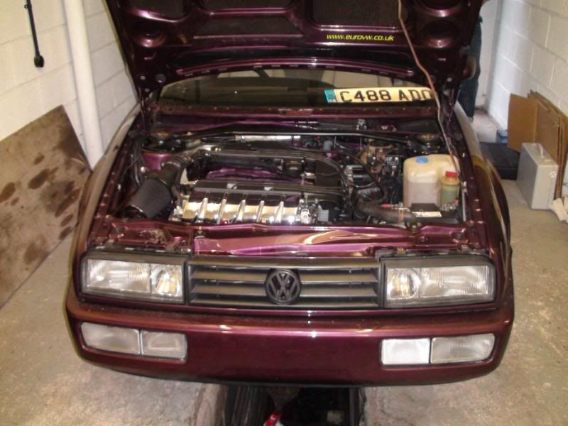

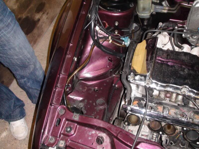

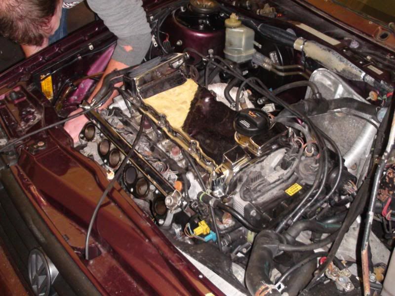

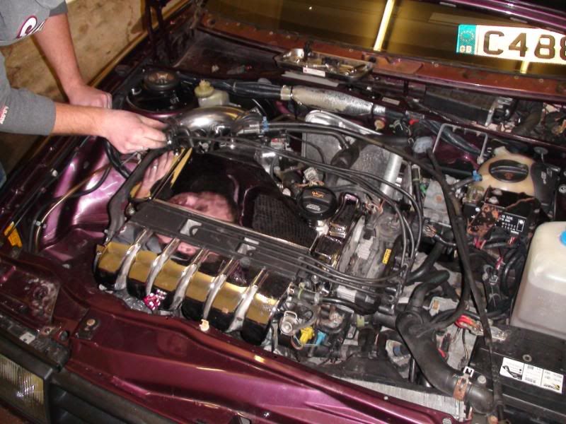

went over to robrados place and somehow managed to get up his drive still surprised my self at that one amd thought we would attempt some of this...

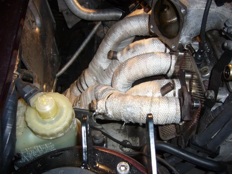

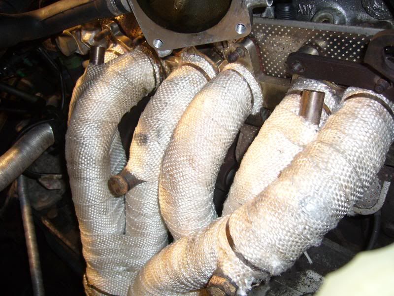

took this out which came out completly by itself almost couldnt have been easier nuts undone like soft butter and everything went too well to plan we were almost laughing how easy it was .................until we realised it was !! lol

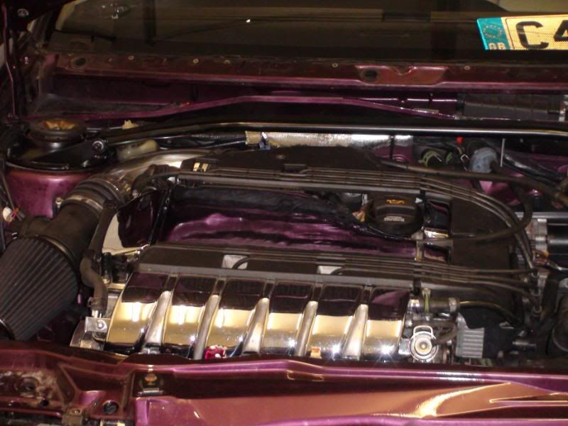

getting the 6 branch manifold back in was slightly different fitted no probs but doiung the nuts up on the studs what kin idiot designd it you have got to have hands like a small child to get in there it was frustrating and swearing was a must just to make it work.....
my arms are all fucked up after having some allergic reaction to the heat wrap!! lol big red rash up both arms were i was trying all angles to get my fingers in pissed right off with it but got it fitted packed up and fooked off home !! lol ran out of fuel as you do at the top of the hill on way to garage15 yds from the pump actually and then finally got home still now all the need to sort out is the blowing exhaust!!!!! grrrrr
lol
shes a beauty!! cant wait to hear it properly after the down pipe blow is fixed!

forgot to say, heat wrap is very itchy stuff lol, its all that fibre glass $hit, please forgive me for not mentioning nath, lol

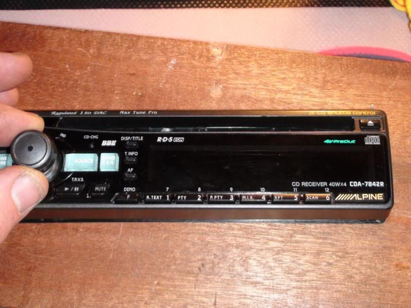

today i didnt want my cousin feeling left out so i decided to ransack his garage and fix ? some bits on the car...

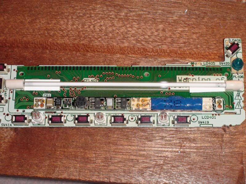

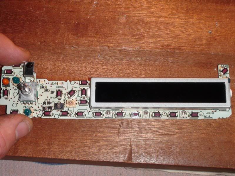

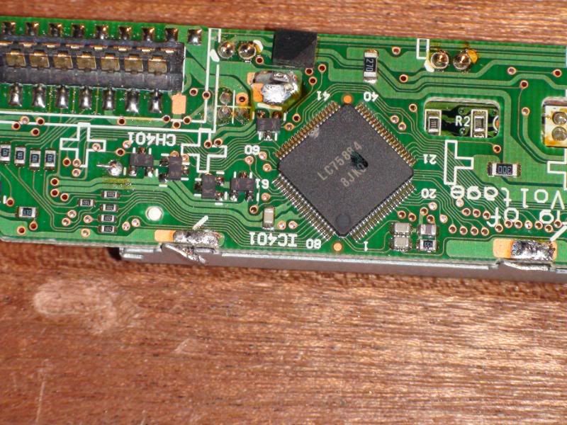

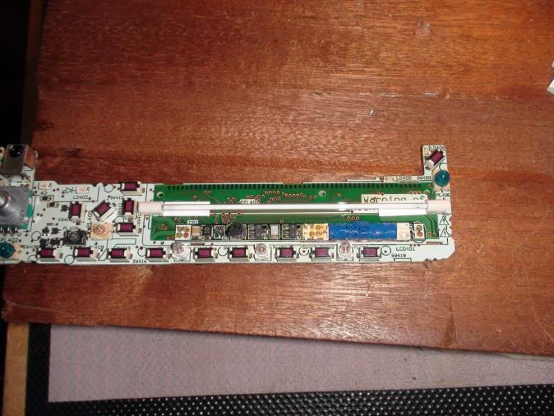

bought a alpine headunit for the timebeing and it had a dodgy display...
but i like alpine so i didnt care...
thought id better fix it
this is the bloody fault poxy little micro flourescent tube!!! gas filled blown.... normally caused by dropping the face plate...
the unit works fine but the display is goosed sound is awesome god damn part is discontinued!! so il use it until i fit the even more retro old skool shizz i got!

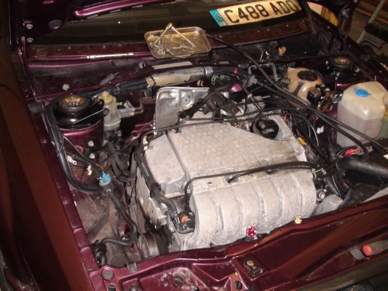

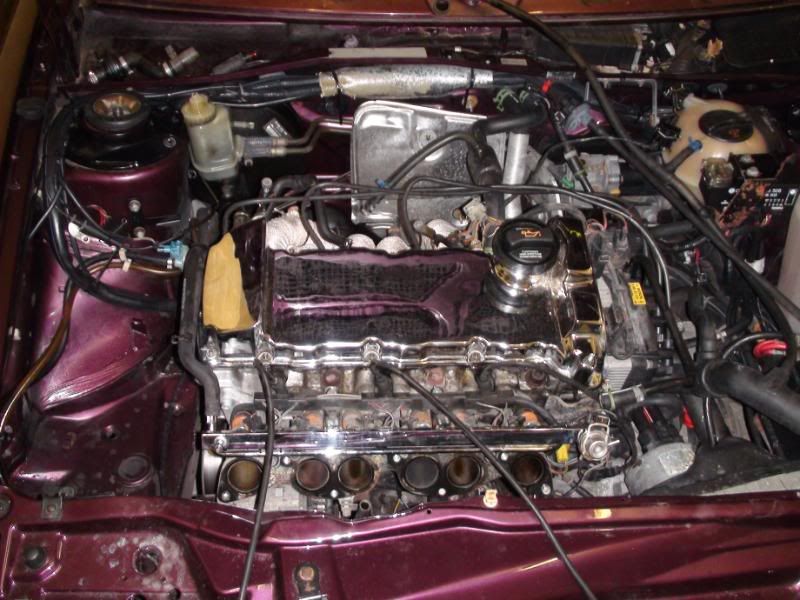

so back to the car, today was going to be a run of the mill routine total balls up type day (useually the case when i want to do something) (esp to the rado) wanted to fit the stuff i got from chris (il refer to him as limp wristed as its broken to save any confusion) limp wristed chris on here i hadc to go to exeter to pick up service parts for rado (didnt make it) ooops sorry john but i will be there lol
any way plan strip down inlet rocker alternator etc fix exhaust...

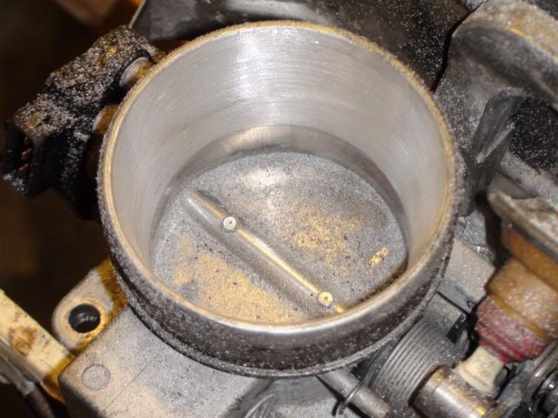

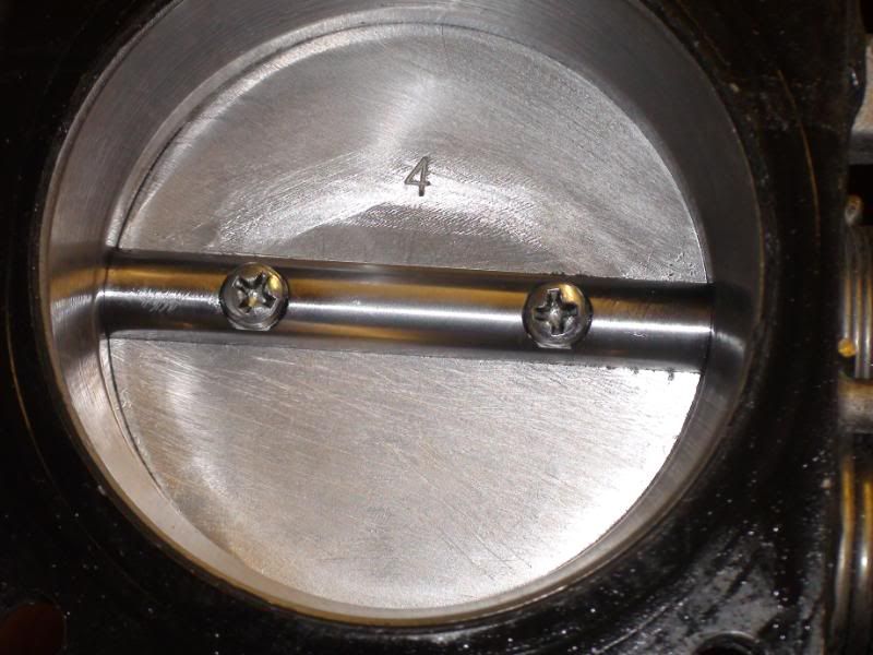

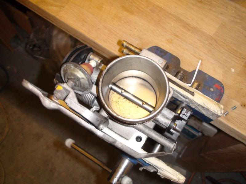

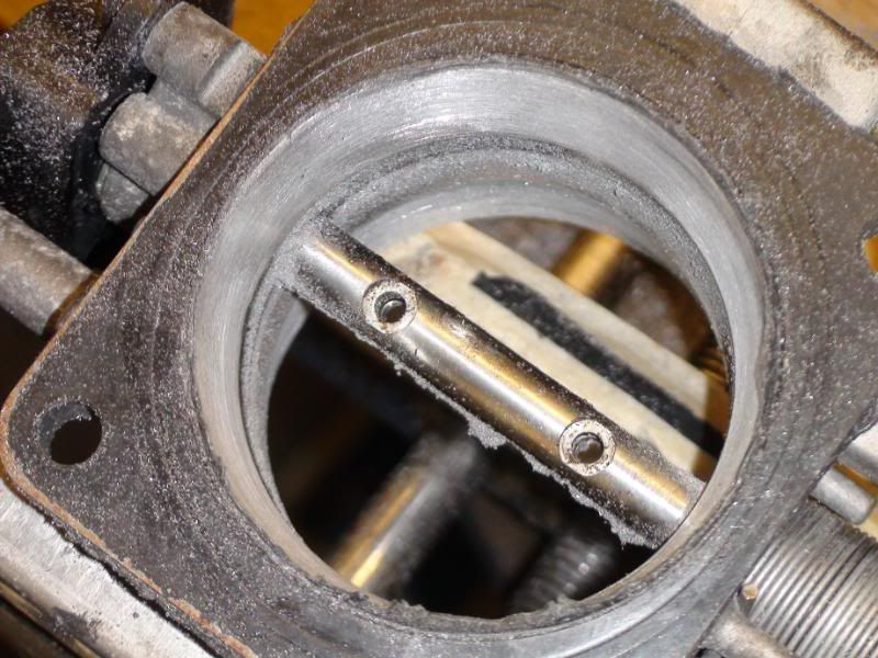

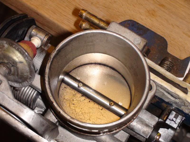

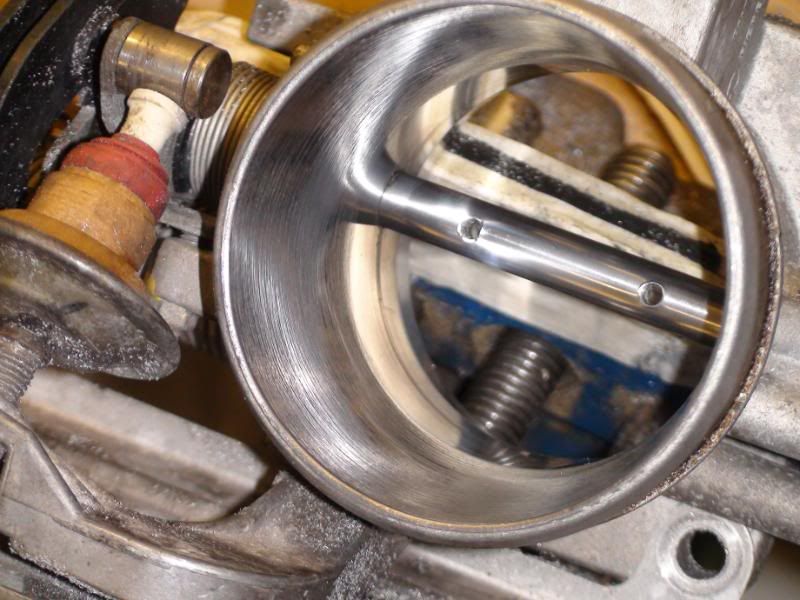

stripped down the inlet manifold and saw the throttle body ive been looking at this for a while and thought fcuk it il have a go ... so i did this off the cuff as you do lol
pictures are of the standard vr6 2.9 throttle body
i got a wheel and sanded/ground down the case markings on the inlet and exit i opend up the mouth of the body only slightly as this is my first attemt ( i am definatly going to do another one) i took out the definate line/groove on both sides of the body

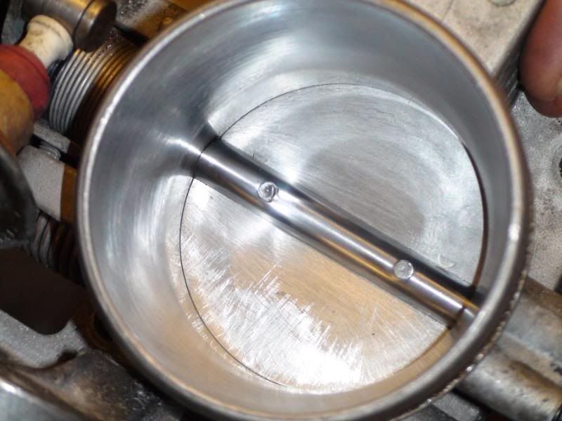

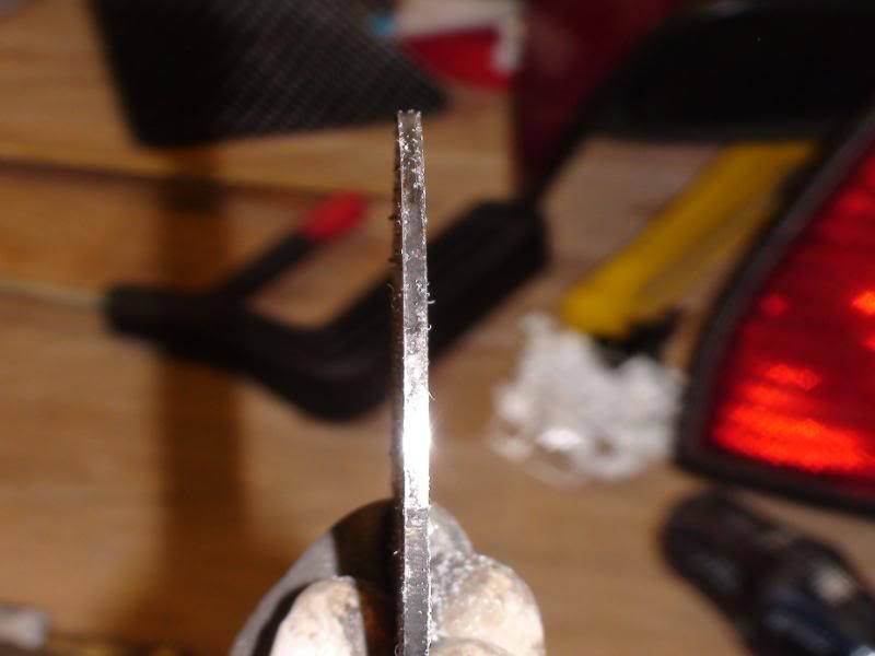

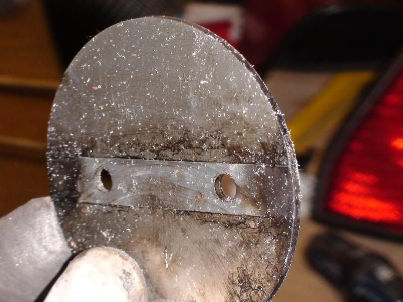

i thought id have a go at knife edging the butterfly itself...
i didnt go all the way with this as i wasnt sure of the outcome so i took it steady on the next one i will work it as much as i can...!! haha
this is the standard butterfly when its open fully the air hits the flat edge of the flap ok not that big hardly noticablebut i guess as with all air flow the smoother the faster the better!

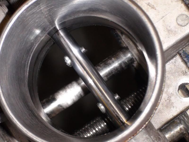

so what i did was to get rid of the castings and edges lines whatever i opened the bell mouth a little bit not too much as i wanted to see how this runs il save the beast for the next one...!!
you can just make out the butterfly with the leading adges a lot thinner than it was before the trailing edge is the same (airflow)
it shuts phew!!
im going to get another one of these and go to town on it i think ive re-fitted and it has made a noticable difference ....no i havent gained 50 bhp etc but i have gained increased throttle response much smoother idleing and better pick up through rev range much better very responsive now very pleased , on the nest one i will get the edges sharper and use flat screws to help wit the flow....

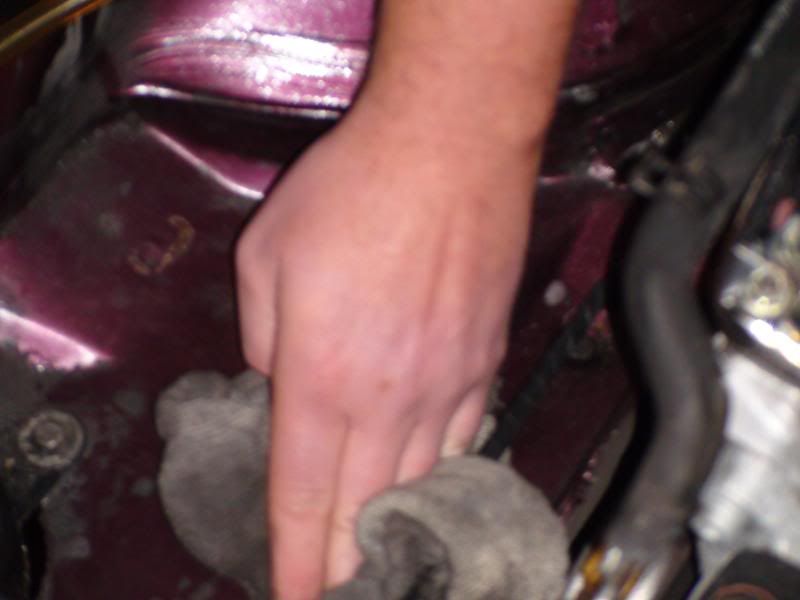

notice how soft and smooth bens hands are look how he can handle such a small impliment with ease .hes a pro!!!
actually he is a model a hand model his real job is to do body part doubles for mens gay porn movies he specializes in jacking off......this must be why he was so good at this today??!
as you can see form the next picture he is demonstrating how to enter someones anus with your hand....

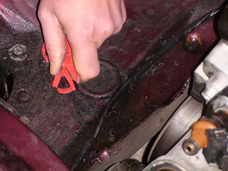

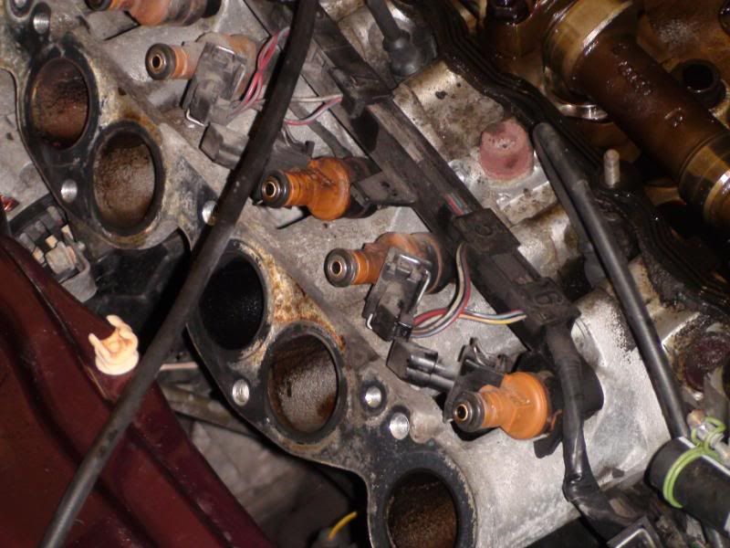

this is put back together the first time onlty to find out i hadnt tightened up the fuel rail and the fule pissed out every where!!!
i can see my wing again cheers ben!
thats it for today folks! oh apart form makin gth blowing on my exhaust even worse im getting there!
