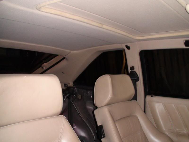

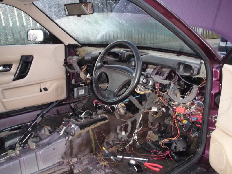

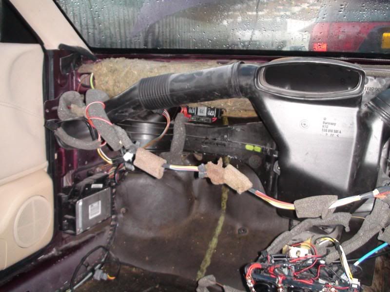

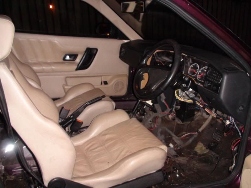

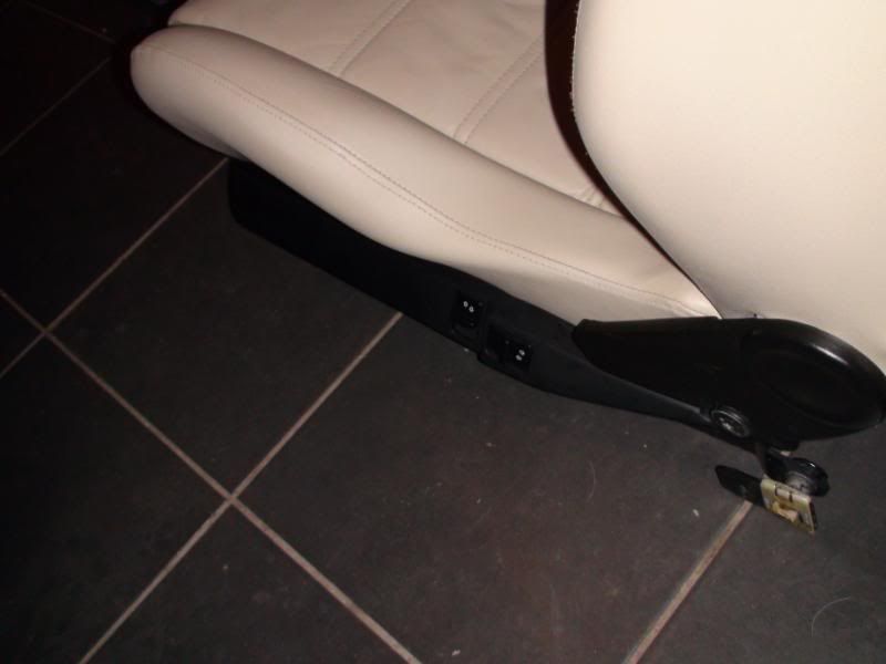

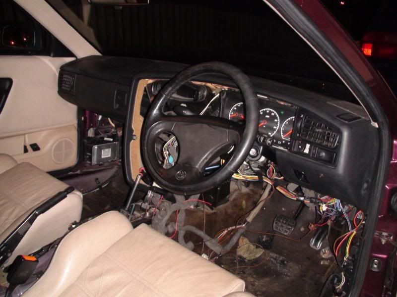

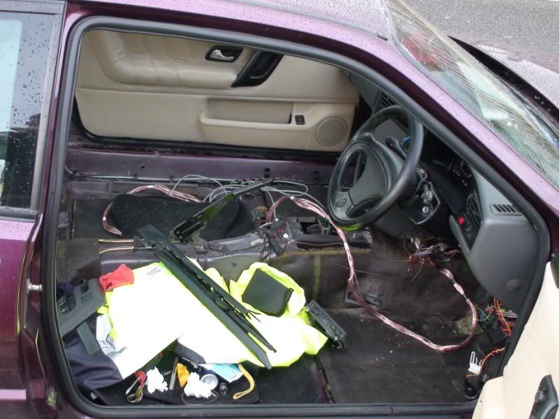

C488ADO 0 Posted January 31, 2010 thank you to rob for coming and getting the old interior bits and pieces today and thank you to matt for helping t=with the dash etc what a bloody day not really a good idea to strip the dash out on a late sunday afternoon.... done it though and got some of it back in! i hate looking at this its just where the hell do i start now.... lol removing the p.c bllocks lets take the dash out ...............what a good idea that was.. rob are you scared yet! hahah i had to pick the missus up so i chucked the seats in and off i went.. got the black dash in now so itl look better when finally converted all to beige quick piccy of the seats before any cleaning commences.. also got the b and c pillars in so the headlining etc all finished and looks very good... Quote Share this post Link to post Share on other sites
C488ADO 0 Posted January 31, 2010 double post?!! Quote Share this post Link to post Share on other sites
robrado974 1 Posted January 31, 2010 seats look sweet mate nice one i dumped all the stuff in the car ,and on it and at the back of it could not be arsed to drag it up to shed!! cant wait to fit the interior dont forget that geezers number for me .be nice to see urs when finished mate :) Quote Share this post Link to post Share on other sites

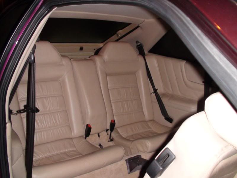

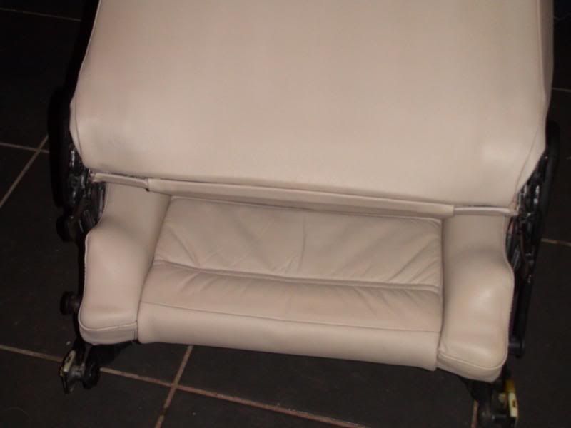

C488ADO 0 Posted February 4, 2010 as i am online here are some of the pics of the rear seats ive fitted... Quote Share this post Link to post Share on other sites
James. 7 Posted February 4, 2010 I like this a lot. Can't wait to see it all put together. Quote Share this post Link to post Share on other sites
C488ADO 0 Posted February 4, 2010 lol nor can i bud nor can i!! Quote Share this post Link to post Share on other sites

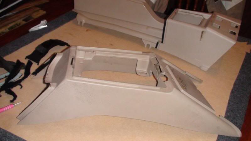

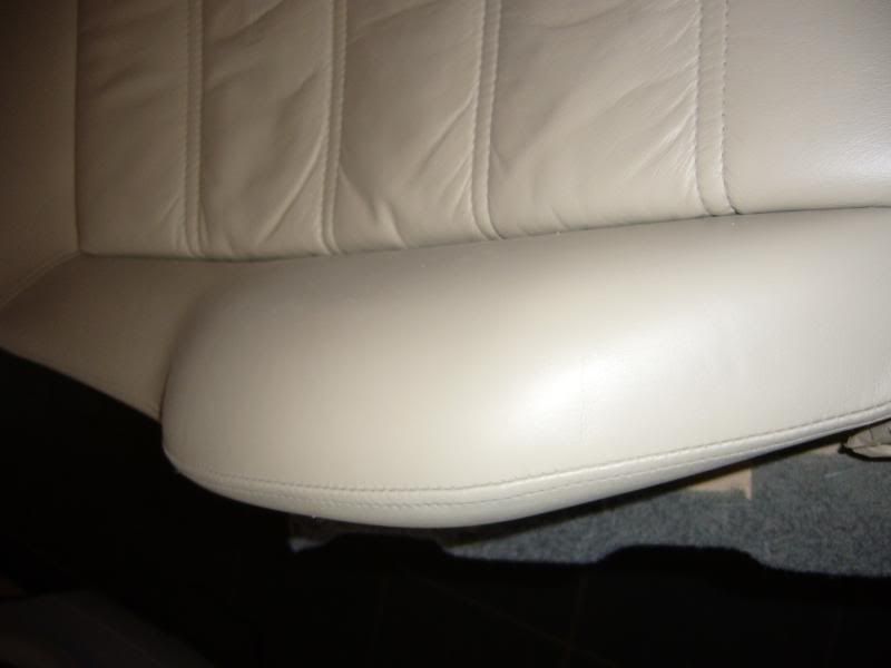

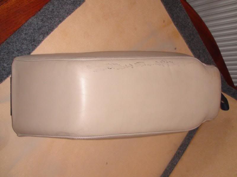

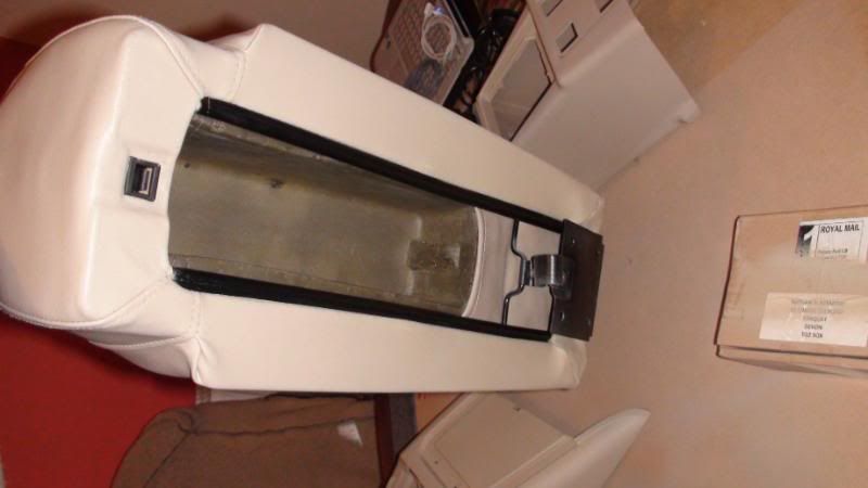

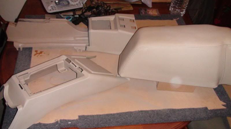

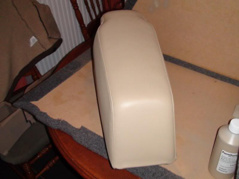

C488ADO 0 Posted February 4, 2010 cheers guys yes they are the same as what i had before ..... but in beige...i always wanted the beige but they were either tooo much money or they never turned up , ive gone back to the recaros only becasue they are a more desirable seat , they are certinaly not as comfortable as the porsche recaros...... anyway ive got my kit to dye the leather and plastcis yesterday so today i thought id tackle a little bit1 as it happens i love doing it and its turning out absolutly amazing!!! i thought id try my luck with the gear stick centre console bottom layer as it was quite grubby and i needed to practice on plastic first rather then staright into the leather..... you will have to excuse the pics as they dont pic up just how dirty the plastics are even after the wash ive given them.... you might just see faintly top left of the plastic its a bit dark well it is and in the flesh a bit grubby looks tierd... just stripped the black material off that stops the squeaks and the foam. cleaned with leather prep, yes leather prep cleaned with alcohol solution painted leather finish high gloss lol painted leather finish satin effect scratch resistant as you can see (well maybe ) lol it looks fresher but theres not much telling between the pics not sure if its the light etc to say im pleased with the result is an understaement.... i am attempting the centre arm rest next.............. i still have bits of the black fabric i took off but i would like to try and source a similar material so i can re trim the edges to reduce the squeeking... i have some spray glue and some carpet tape im sure something can be made up... il try and post up as and when cheers Quote Share this post Link to post Share on other sites

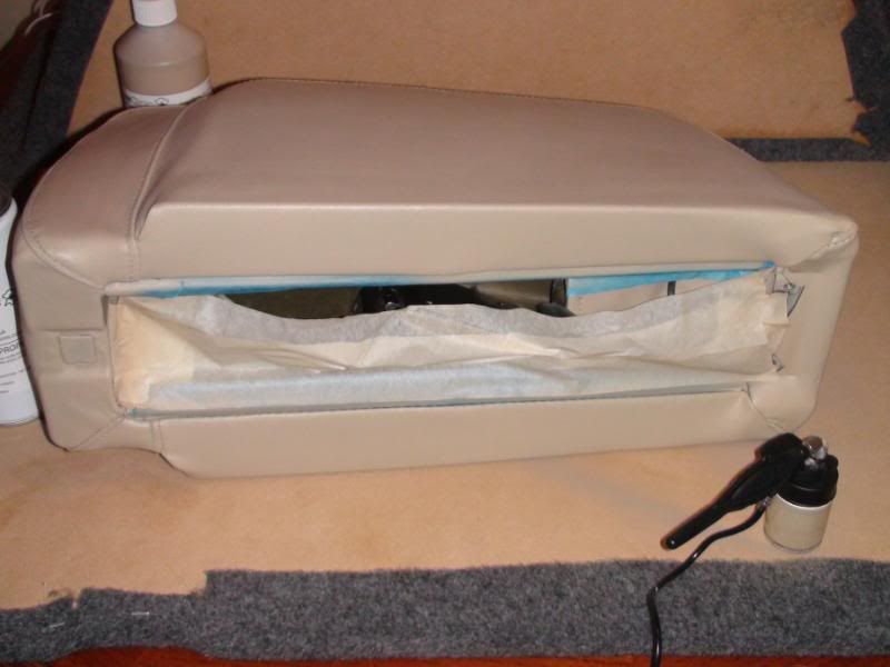

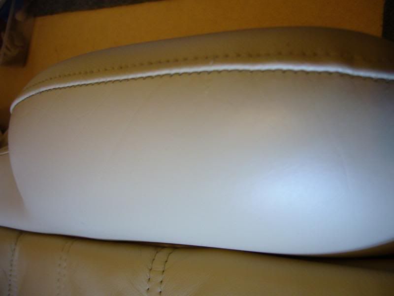

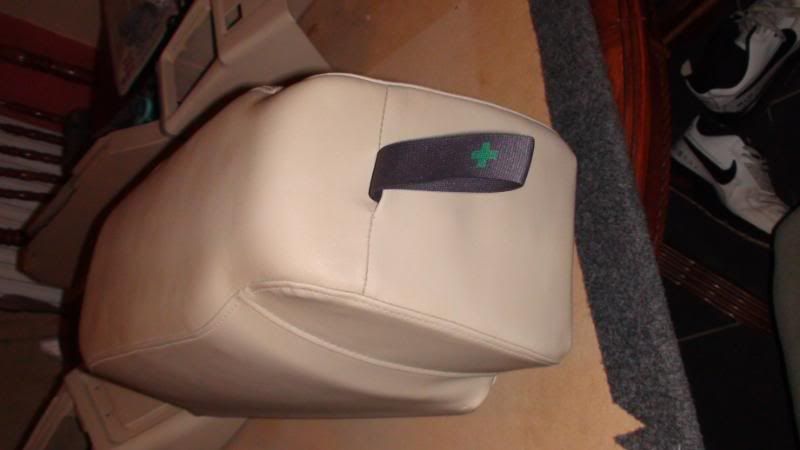

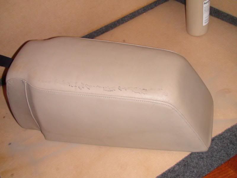

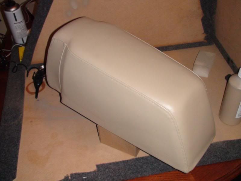

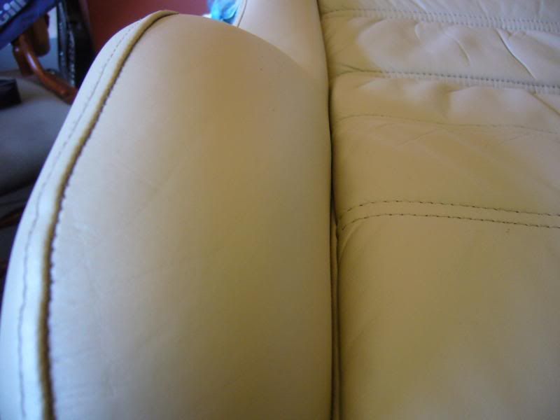

C488ADO 0 Posted February 4, 2010 prepped the arm rest and then did the same process with the leather as i did with the plastics,its turned out very well but............................... the colour is different!! lol not bad really in the flesh it is the same colour but its just a lot fresher obviously looks new and clean the only problem is it really shows how tierd the rest of the interior is so i kinda expected it realy im going to go the whole hog and do the rest.... bit of a mission i know but i have a week off next week and il give it a shot to complete it then!! fingers crossed.... bit gutted about this only becasue it means ive actually got to pull my finger out and get it sorted sooner rather than laer... Quote Share this post Link to post Share on other sites
robrado974 1 Posted February 4, 2010 this is comin on realy well mate have to say im a bit green with envy!.just lookin at mine gives me the ump.interior has come up sweet as, looks wicked you must be well pleased,cant wait to get mine runnin sunday :clap: Quote Share this post Link to post Share on other sites

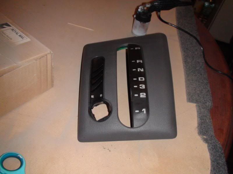

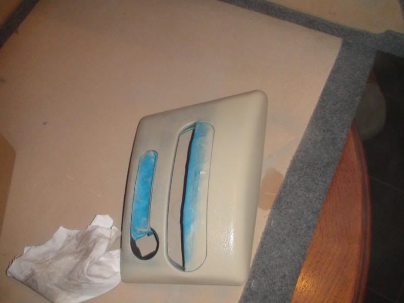

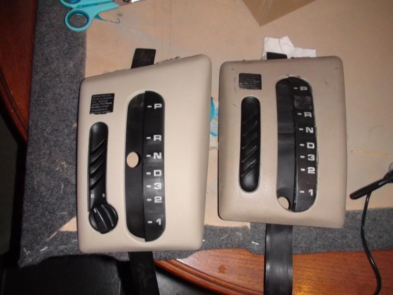

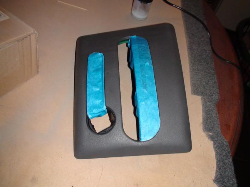

C488ADO 0 Posted February 4, 2010 cheers rob!! lol so are you staying grey going black or do you fancy beige??? lol got the compressor this evening and wow what a difference... so much quicker. got some more plastics done this evening and this is for the possible non belivers... lol here we have my original GREY auto gear shift surround prepped and masked up first coat of colour as a base coat first spray coat finished article.. old beige surround just bought verses new colour changed one. so there you have it possibvle to change any colour to any colour and in the flesh it looks just like new and extremly good... Quote Share this post Link to post Share on other sites

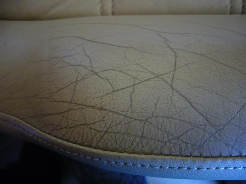

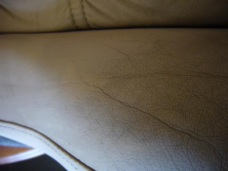

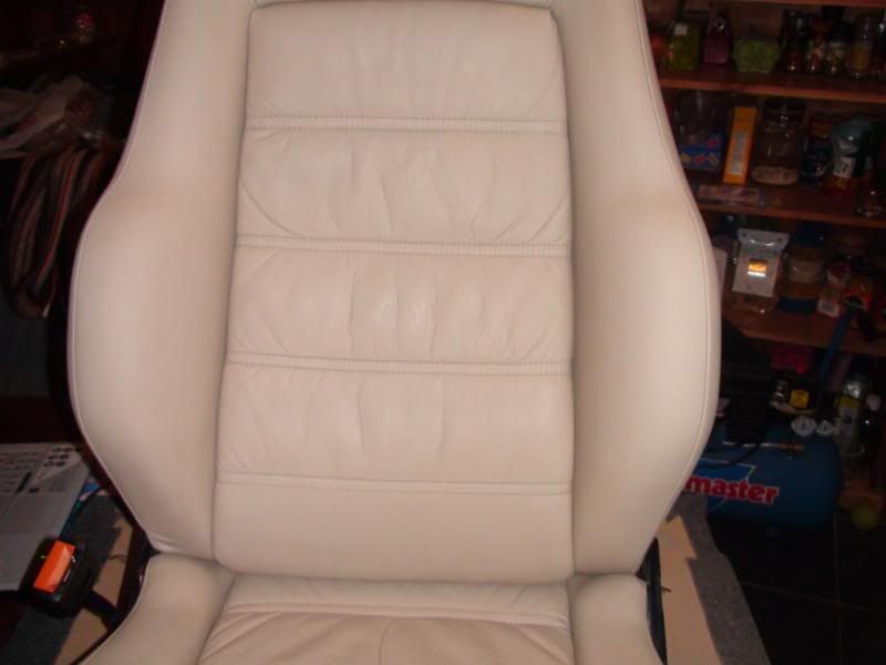

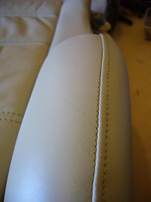

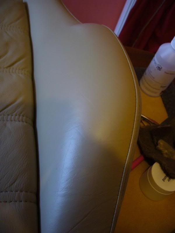

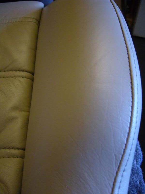

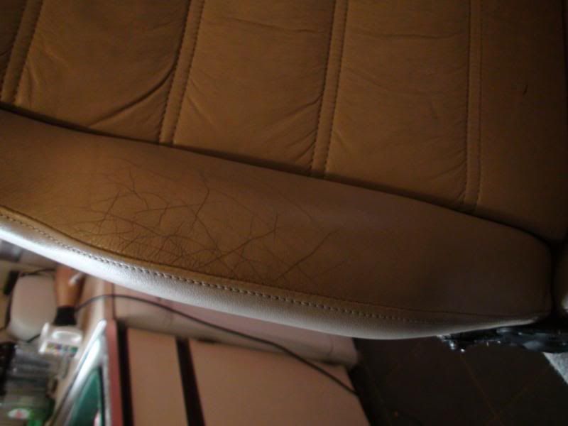

C488ADO 0 Posted February 8, 2010 well started on some more interior plastics this morning took out all of the boot plastics i have prepped them and sprayed them all i need to do is put the satin top coat on then they are finished.... i took a chance and ripped out the passenger side recaro seat today and thought bugger it im gonna go for it and see what happens.... , now they look ok dont get me wrong they are clean is not tatty but the leather is good, they have the useual bolster problems.... you can see hte ground in dirt you just cant get it out...... also in the above pics on the bolsters you can see the PAINT cracking i always used to think that this was the leather cracking and therefore shagged and need a re-trim, read on.................... you will have to excuse some of the pics as i wanted to try and picture it in natural light no flash the flash just makes everything look white!! you might be able to see on the varying photographs the different stages of the leather being prepped, you will notice that the cracks have almost dissappeard and the leather looking a lot lighter, thats because when you prep it it takes all of the shit off the leather revealing the colour uinderneath, even after the prep they looked good, in some areas i took all the paint off (by accident ) but it doesnt matter, on the upper part of the seat bolsters on the left hand side the leather had cracked just a small crack about 5mm long i used the repair filler and now its gone totally!!! i cannot stress enough how good this stuff is to use i really cant and easy wow ,so easy............ anyway the pics dont do it justice and it looks something like this.................... even the back after cleaning is still grubby so i did the back as well! before il stick the after ones up when i find the lead!! Quote Share this post Link to post Share on other sites
C488ADO 0 Posted February 8, 2010 ok back to my camcorder pics i prefer them to the camera we normally use.... balls i forgot to take a pic of the back but anyway you know what im getting at..... ive orderd some more colourant and finishes i havent airbrushed for years and years got me right back in the mood today i might even try and do something with my swg scuttle panel....... Quote Share this post Link to post Share on other sites
Jim 1 Posted February 8, 2010 Wow - that came up a treat! Really nice work! :shock: Quote Share this post Link to post Share on other sites
C488ADO 0 Posted February 8, 2010 i know can you believe it in the flesh they look so so good the drivers seat is in worse condition but hopefully i can bring it back to life!,, i will never look at worn leather seats in the same way again!! Quote Share this post Link to post Share on other sites
