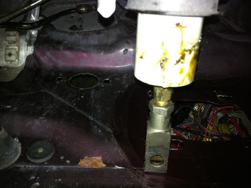

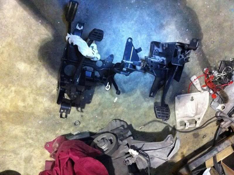

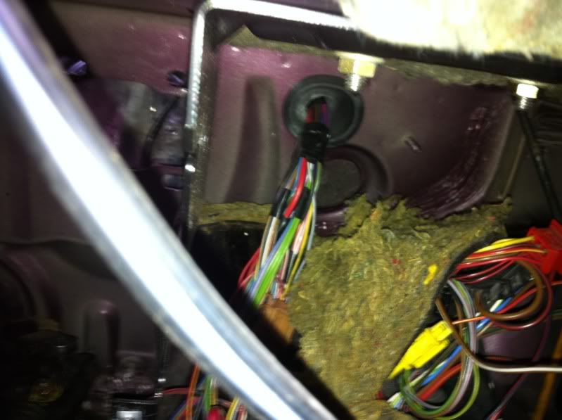

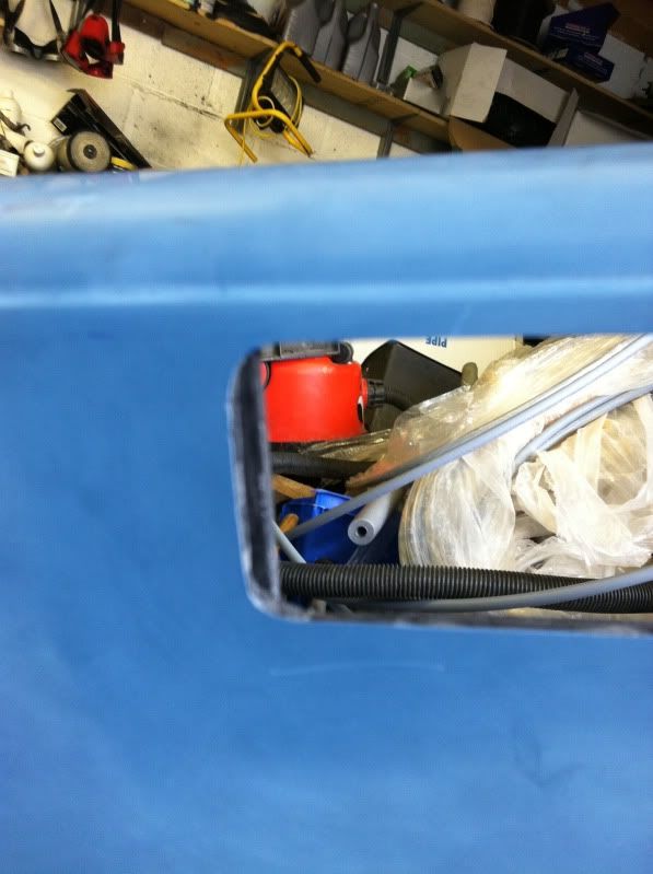

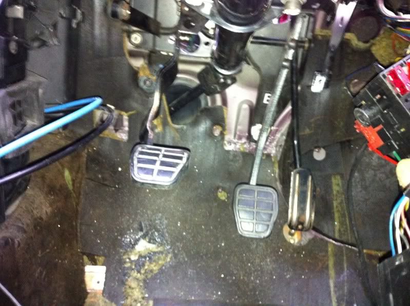

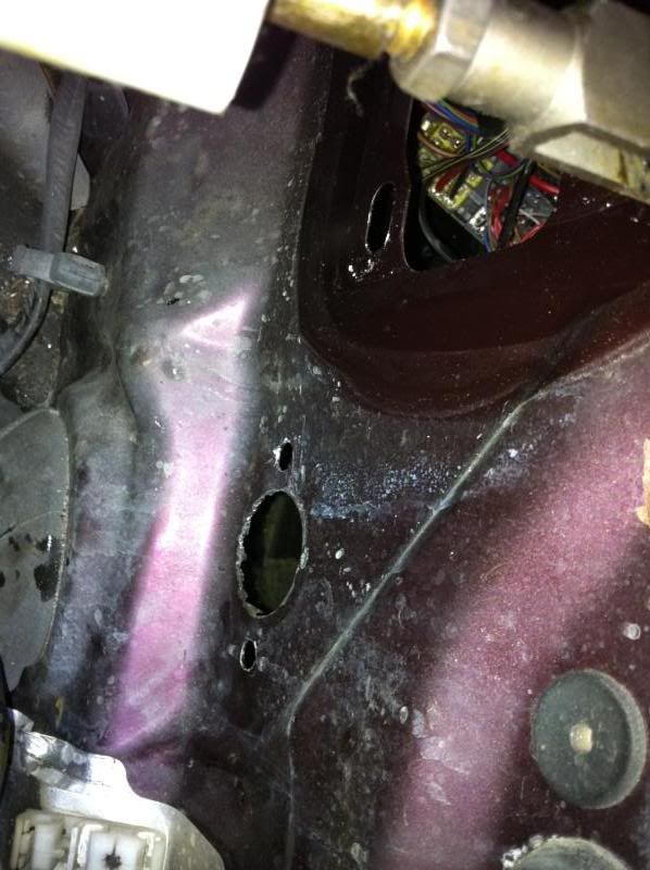

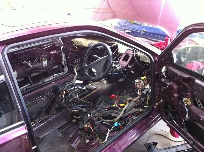

C488ADO 0 Posted October 21, 2010 rob came round and helped me the other night , we decided to take out the pedal box ......what a shiter of a job, i never want to do that job ever ever again!! here are som epics. hole drilled.. where the main looms come through the bulk head pedal box out! as it stands....realy want to tidy the bay wiring up there you have it just another little update slow burner this one tedious never want to do it again, but iam ... Quote Share this post Link to post Share on other sites

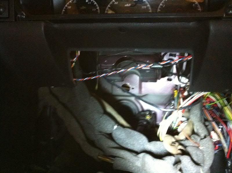

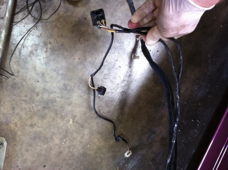

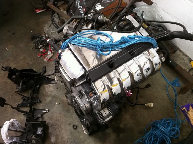

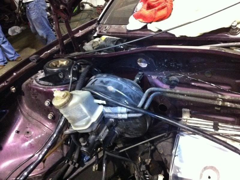

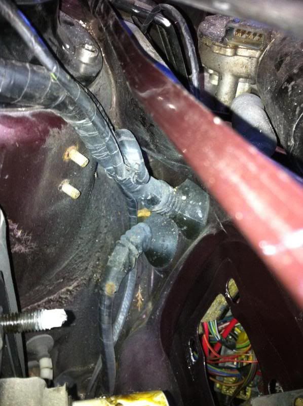

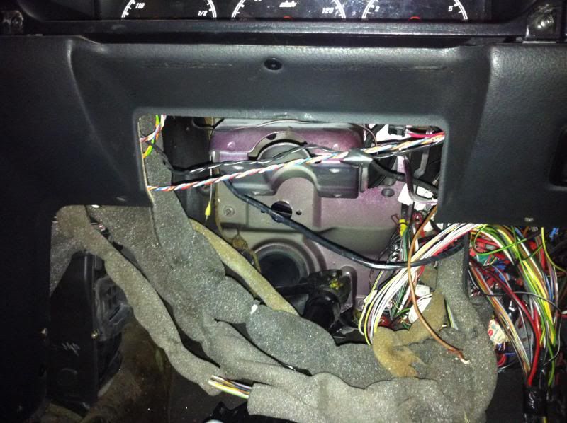

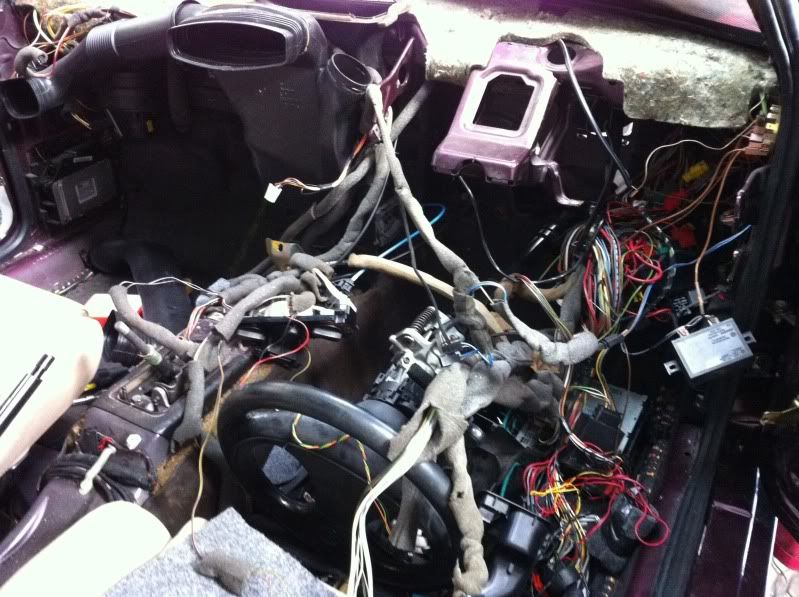

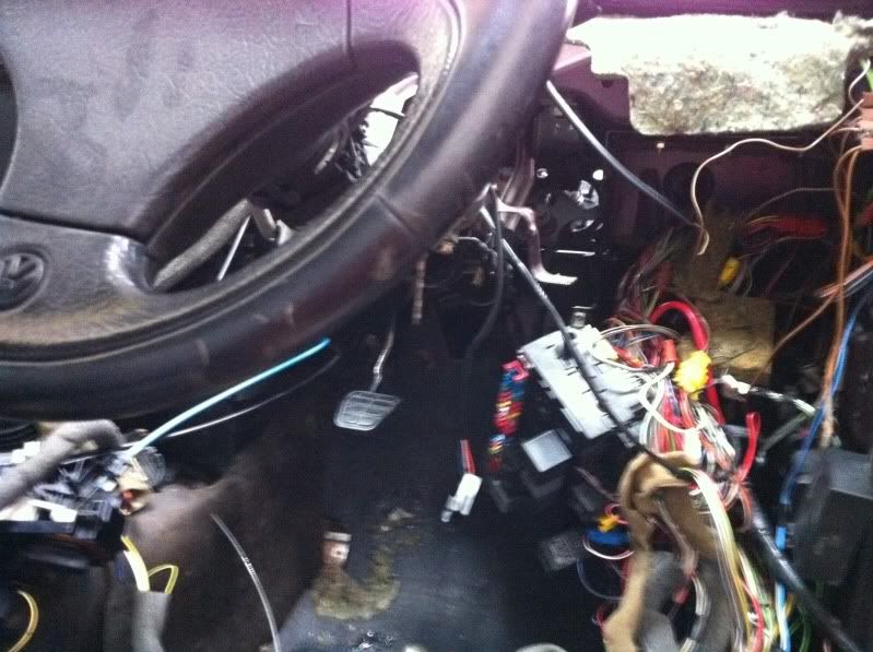

C488ADO 0 Posted October 25, 2010 another couple of hours today just a random shot of the engine... i pulled the drivers side loom back through into the cabin im thinking of joining the loom here to extend the wires down to the headlights etc the hole where the loom was... manual pedal box in place steering colum back in!! a bit daunting but hey ho random shot of one of the seats i refurbished!! so thats it started on the re routing of the loom fitted the manual pedal box re-fitted the steering colum.....long way to go ! Quote Share this post Link to post Share on other sites

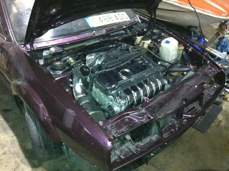

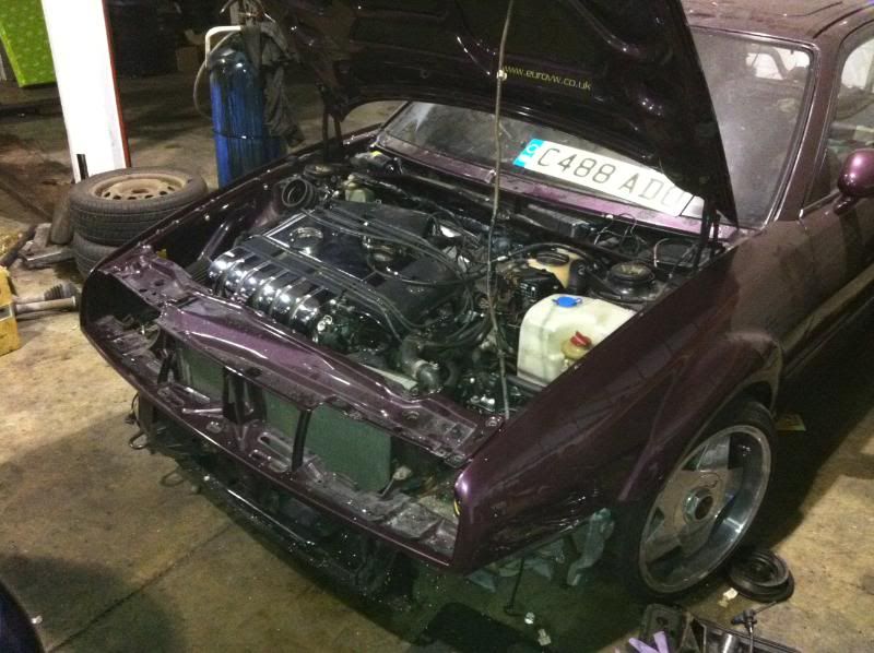

C488ADO 0 Posted January 30, 2011 project has well over gone its due date and my patience with it ran out several times but soon now we are on the road to recovery.... got the fron tend back on... car looks a total mess!!!!!! just got to finish wiring in the reverse lights and then the starter motor when thats done il then be able to fire it up!!!!!! cant wait anyway next after this is the front bumper i need to retro fit the side markers.... Quote Share this post Link to post Share on other sites

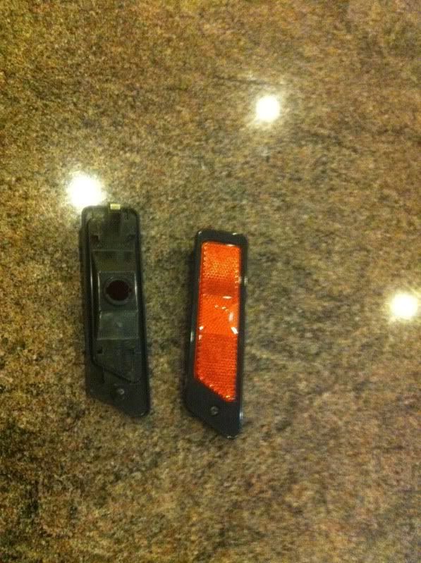

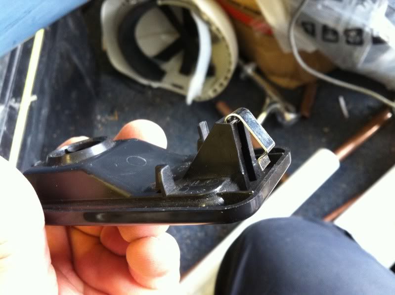

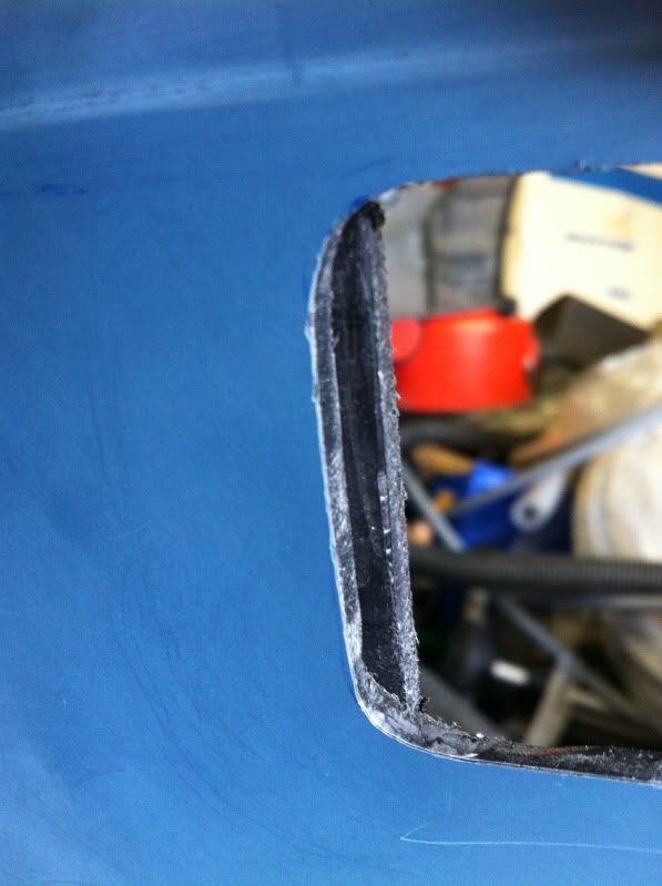

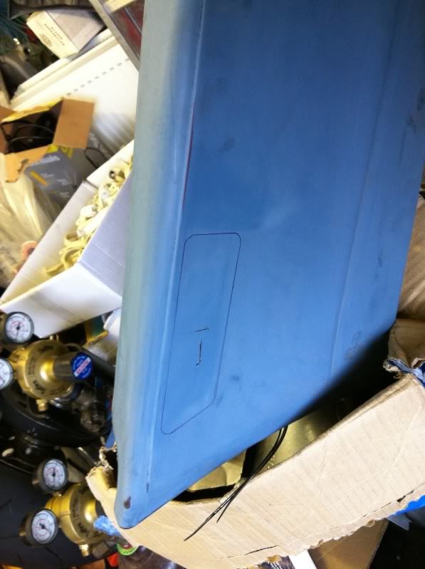

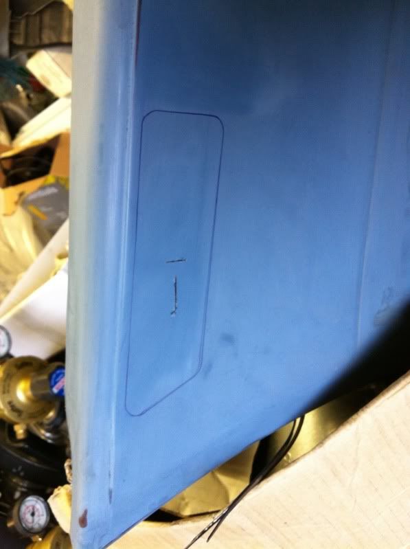

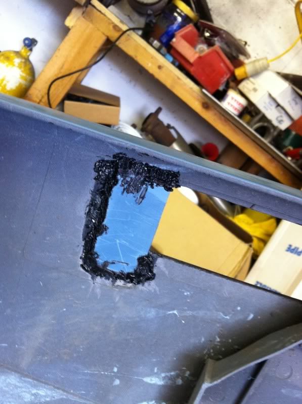

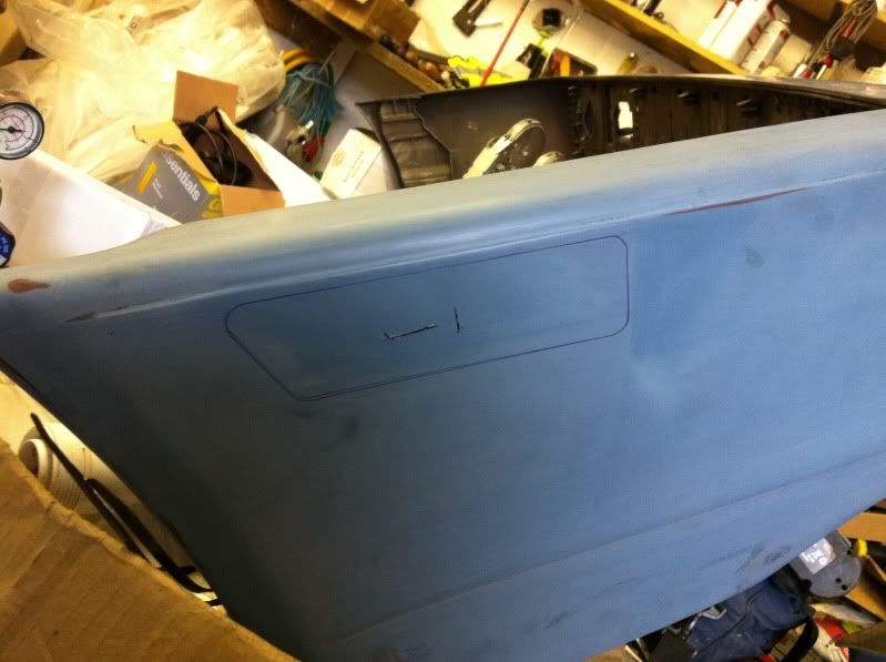

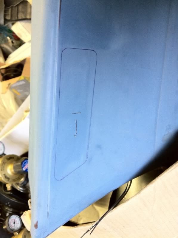

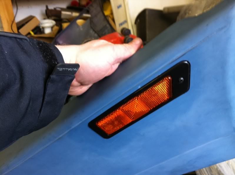

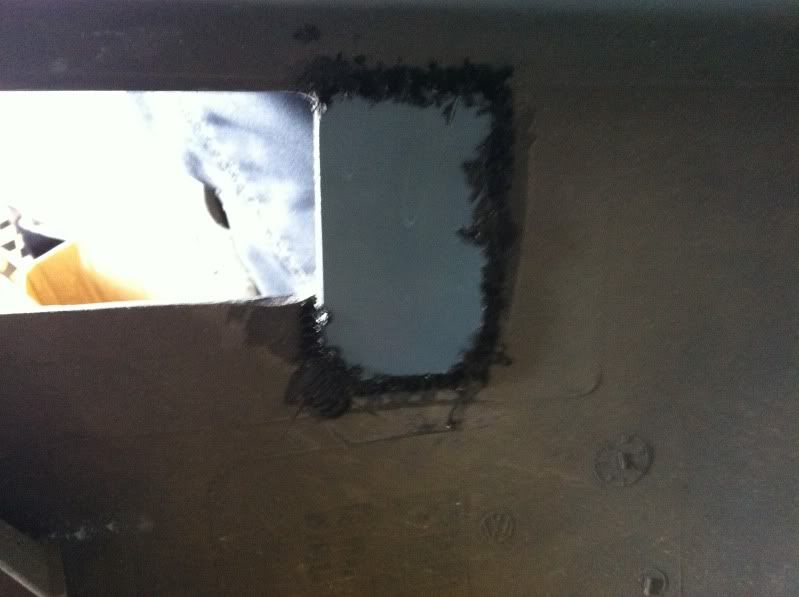

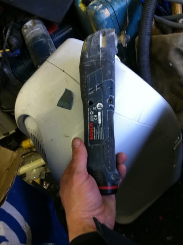

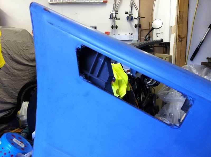

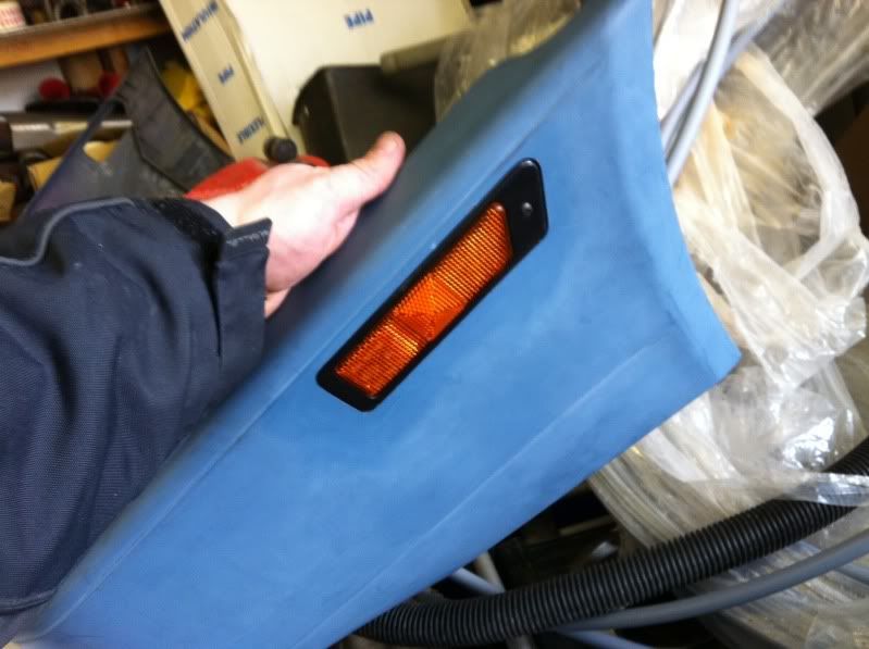

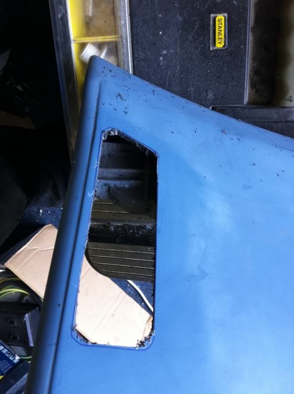

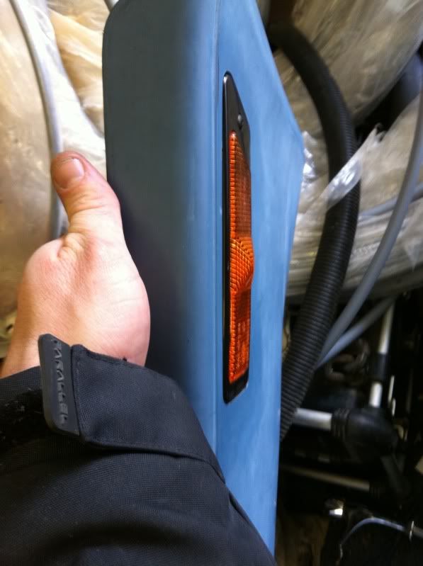

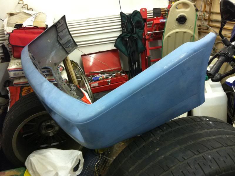

C488ADO 0 Posted February 13, 2011 right another day!.................. quite literally today ive been off work ( my day off) ....(ill) needed to get this done been putting it off for ages and wasnt really sure how to go about it , so in a true me fashion just went with it and see how it went.... im sure someone out there will have better way ? easier way of doing this , but with limited brain power due to being ill and generally not very bright i kinda just done t this way. ok step 1! first and formost get yourself an slc bumper from the states and save yourself all this hassle!! screw in the side markers extend the loom job done! lol i wish it were that simple... get yourself some sidemarkers... i got mine from tps took like 3-4 days so not too bad also get the bulb holders and screws too asthey are only pence then what you need to do is to mark out where you actually want the lights... on mine i wanted them to look as factory as i could make them useing my limited skills and budget, i reaserched the images on google and forums etc and finaly decided where to put them and how to line them up.. after all who am i kidding its touch and go wheather or not this is gonna work... i made the stencil from cardboard i took some card made a rough hole in it stuck the light in it and then drawing a line round the outside of the light unit gave me a fairly decent stencil... ok so when ouve finished arseing about with where ou are going to put them you just need to get stuck in and go for it..............bring on the nibbler!! the nibbler this little beauty is brilliant variable speed and diffeent heads its awesome so i naturally just started hacking away thinking **** if i f this up i need a new bumper..... so its a trial and fit trial and fit process time consuming i guess so holding the side marker in position try and get a decent gap between that and the bumper remember you have got to get it out... i then needed to locate the unit in the hole and stop it from falling through so i thought about plastic welding in some tabs.. for the spring on the back of the marker using a bit of the off cut bumper i made the tabs Quote Share this post Link to post Share on other sites
