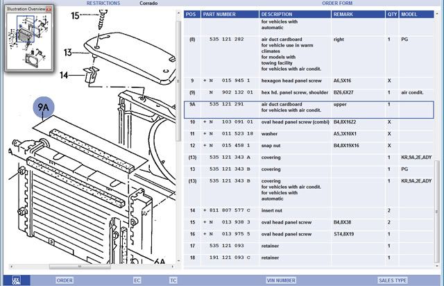

Mawrick 0 Posted May 26, 2010 Anyone have any pics showing how those angled brackets (2) sits on the radiator/AC radiator. Also interested in seeing how that "cardbord" plate with some foam on it on the top sits. EDIT: VR6 model Quote Share this post Link to post Share on other sites

Mawrick 0 Posted May 26, 2010 those where the first things I was thinking of - figured those out. But there is a "cardboard" thingy (with some "foam" on it) on top of the 2 radiators - was wondering how that is supposed to sit, but I put it in one way - not sure if it's correct though....:) Quote Share this post Link to post Share on other sites

Mawrick 0 Posted May 26, 2010 Not able to take pic just now, but the thing I'm talking about is this one: Quote Share this post Link to post Share on other sites

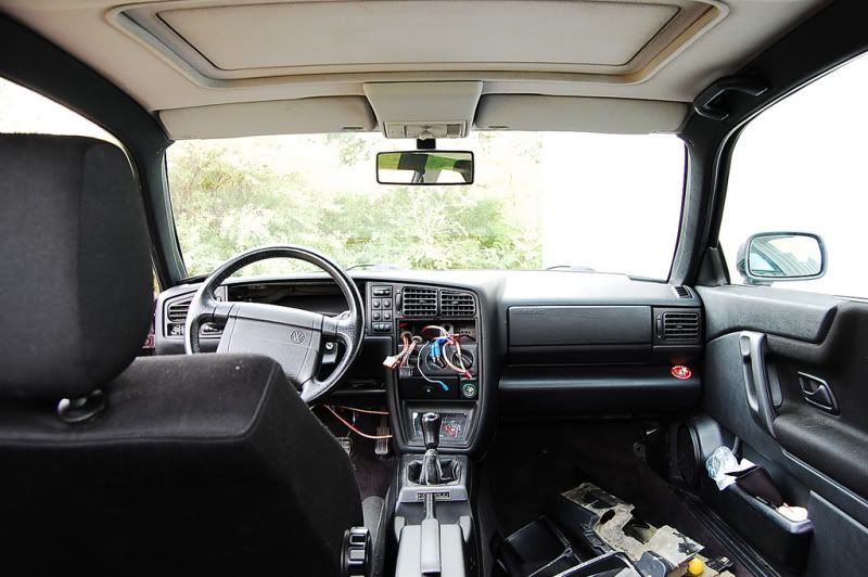

volksworld13 0 Posted May 26, 2010 a bit off topic, but i have a/c aswell and it looks as if im missing that top foam/cardboard peice, a pic would be awsome, and with all a/c corrados is the passenger shelf been cut and shortened to allow for the blower motor and a/c pipes ect, a picture of that would make my day, my looks so bodged in there, and is there any way to get the plastic bits the remake the shelf with? Quote Share this post Link to post Share on other sites
Mawrick 0 Posted May 26, 2010 Not sure if the shelf have anything to do with the A/C system, or if it can be fitted. Mine got A/C - but also have airbags so might be the reason for no shelf: Quote Share this post Link to post Share on other sites
joebloggsVR69 0 Posted May 27, 2010 a bit off topic, but i have a/c aswell and it looks as if im missing that top foam/cardboard peice, a pic would be awsome, and with all a/c corrados is the passenger shelf been cut and shortened to allow for the blower motor and a/c pipes ect, a picture of that would make my day, my looks so bodged in there, and is there any way to get the plastic bits the remake the shelf with? Yeah, all the passenger shelves I've seen look like a complete bodge. I did mine myself, chopping away the excess plastic from a non-butchered shelf with a jigsaw until it all fit perfectly. Then used some of the excess plastic (with the flocked texture) to create a new piece for the back of the shelf, which I plastic welded into place with a soldering iron. I don't like to boast, but it looks pretty good :lol: Takes a few hours to do, which is why they were probably all rushed/bodged in the mid 90's... Quote Share this post Link to post Share on other sites
