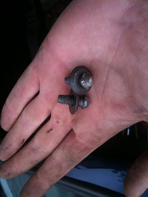

poll250 0 Posted October 2, 2010 So I did this mod today hurrah! Couples of notes: All 3 shear bolts come out using Irwin bolt grippers, so no drilling needed there! I bought a polo column 2nd hand, then all the parts listed on the first page, including both bearings. The bearing that fitted mine was the thinner one, but the wedge type ring that goes on before wass too big for it, and the polo column didnt seem to have one at all (that I could find). I put it together without the wedge before the bearing, and now now I have a wobble that I can trace to the end of the shaft, so I guess it's all got to come out again to fit a wedge thing in. Does anyone have a part number for the thinner wedge ( I have contact ring 811 419 548 A which is too large and just slides down the column!)) Overall impressions are really good, I'm sure it'll improve even more once I've got the contact ring fitted properly. The fixed cowling is so much sturdier than the adjustable one, everything feels so solid! Quote Share this post Link to post Share on other sites

davidwort 0 Posted October 3, 2010 ... All 3 shear bolts come out using Irwin bolt grippers, so no drilling needed there! have to say, pretty impressed by that, I'm still picking swarf out of my carpet :lol: Quote Share this post Link to post Share on other sites
