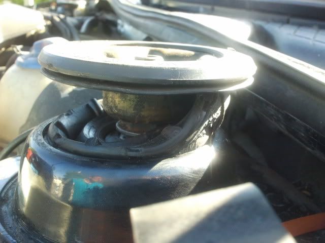

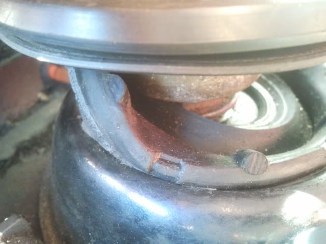

sharpy-vr6 10 Posted June 29, 2012 Hi i recently fitted some weitec coilys, and changed my top mounts. The company i usually use didnt have the top mounts in stock so i brought some off ebay. This is the result after just a week on the car [ATTACH]67493[/ATTACH] [ATTACH]67497[/ATTACH] :banghead: As you can guess im not happy and will be sending an angry email to the seller :mad: In the meantime i would like to know what top mounts everyone has im after some top quality mounts preferably poly mounts if you can get them just for peice of mind. Thanks Quote Share this post Link to post Share on other sites
Kevin Bacon 5 Posted June 29, 2012 What in the name of all that's holy?!? Just use OE mounts mate. It would appear your ones there have no metal structure inside the rubber donut to prevent the strut punching through the turret, as what's happened there. That ebay seller should be strung up. That's bloody dangerous. Quote Share this post Link to post Share on other sites

sharpy-vr6 10 Posted June 29, 2012 Always stick to genuine VW for suspension components! That's seriously dangerous - did it damage the bonnet also? The bonnet is okay the suspension hasnt come through that far yet luckily. Get OEM. No need for poly, the damper and spring should do all the work. If an OEM top mount is getting destroyed something is wrong with the suspension setup, its only there for isolation from the shell. Poly ones are fine if you are after a bit more control over position of the strut during loadin, at the sacrifice of body isolation. Jay I was just thinking for longer life?? And the bonus of a bit of extra rigidity? Im lucky my suspension hasn't come through the bonnet and i hope this helps other people from being less lucky :/ Sent from my GT-I9000 using Tapatalk 2 Quote Share this post Link to post Share on other sites

Jim Bowen 1 Posted June 29, 2012 I've looked at those pics and looked again because it was so wtf. Are you sure the rubber part isn't upside down? Sent from my X10i using Tapatalk 2 Quote Share this post Link to post Share on other sites

Kevin Bacon 5 Posted June 29, 2012 I was just thinking for longer life?? And the bonus of a bit of extra rigidity? The OEM ones are fine mate. Been using them with coilovers for years with no issues. Looks like yours are chinese copies but they forgot to put the metal cup inside them!!! Quote Share this post Link to post Share on other sites

sharpy-vr6 10 Posted June 30, 2012 I've looked at those pics and looked again because it was so wtf. Are you sure the rubber part isn't upside down? Sent from my X10i using Tapatalk 2 The mount is in correctly the other side has seated okay and works fine. They went on the same way as my old ones came off Hi bough ones on eBay and the same happened to my ones also pm me the supplier to see if there the same I have to get my bonnet repaired now not happy also . sorry to hear that, the seller was "euroautomotive10" I guess im lucky i spotted it before it got any worse. Quote Share this post Link to post Share on other sites
