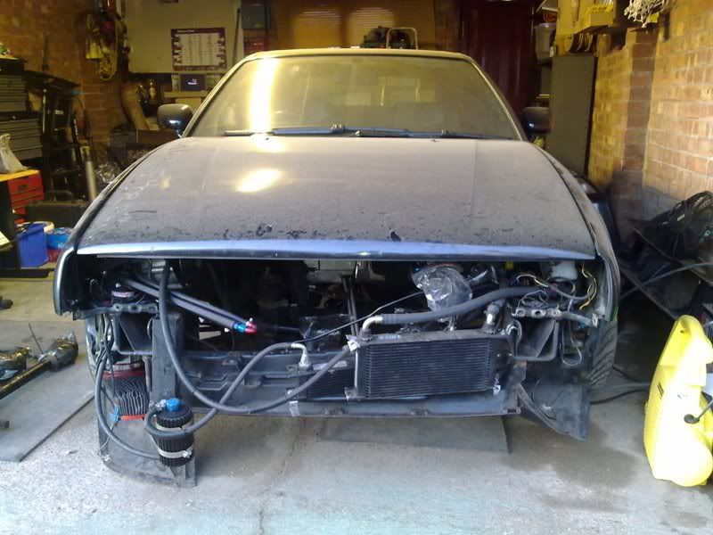

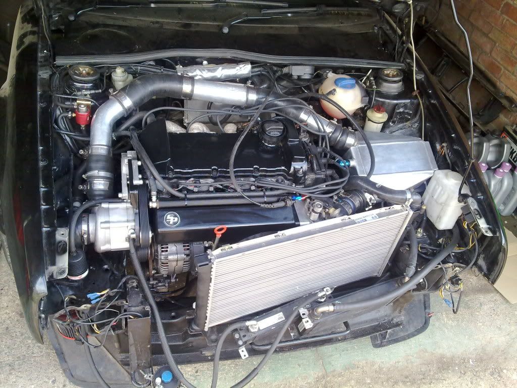

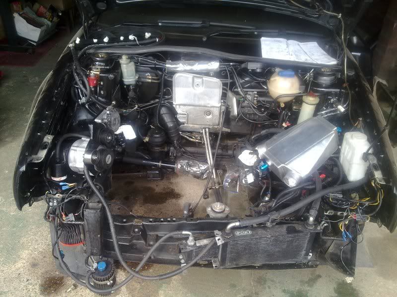

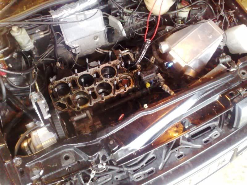

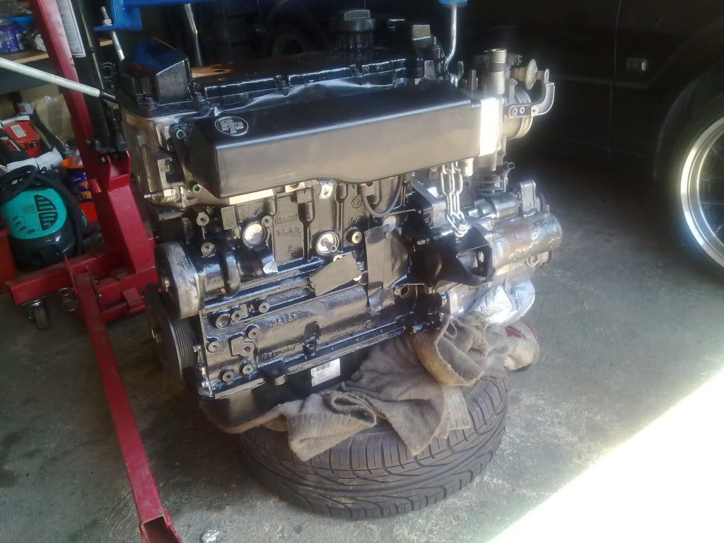

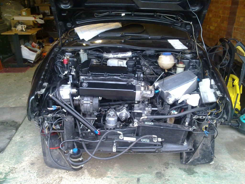

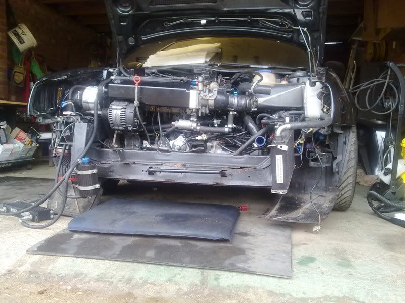

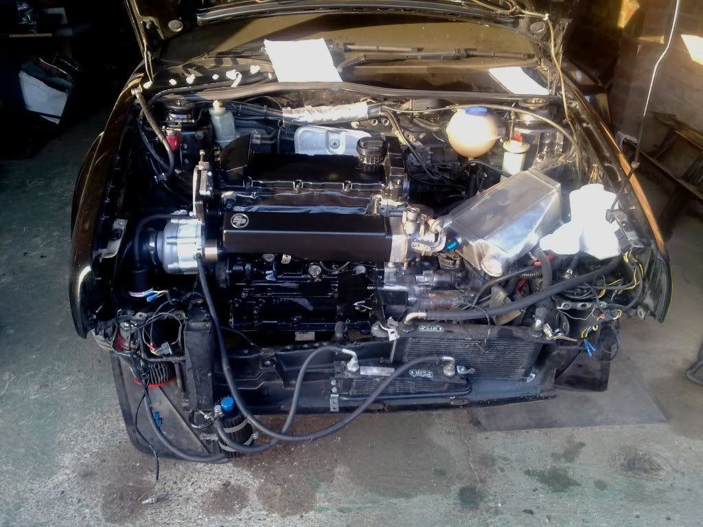

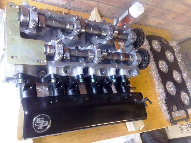

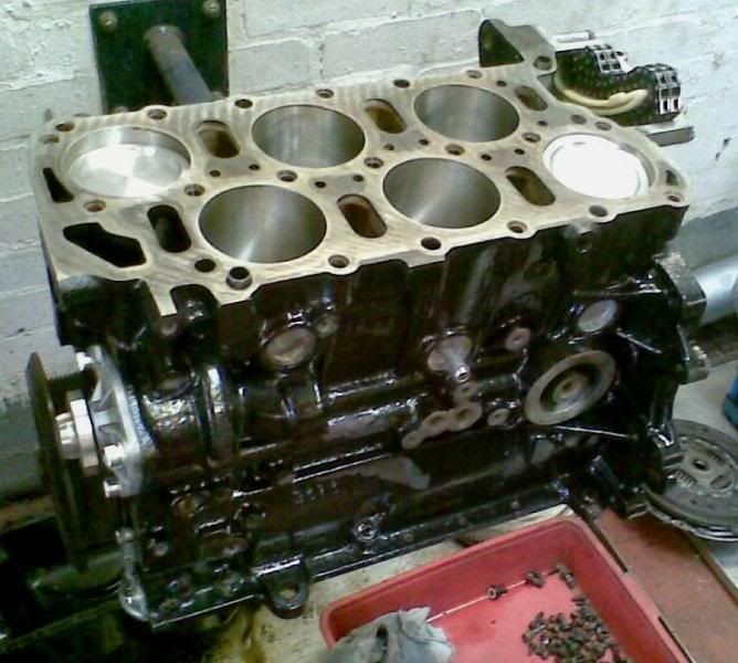

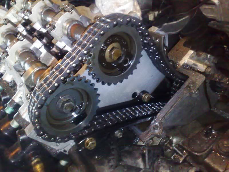

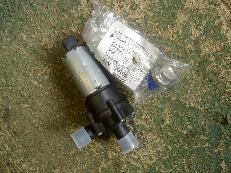

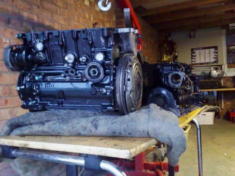

B5VWC 0 Posted August 2, 2009 (edited) Update… Cars been running on 5 and a bit cylinders despite pulling 430hp on the rollers So after 14 years and 125k so it was time to get the bottom end rebuilt. Pulled out the bottom end – painted it up then got it rebored to 2897cc. Went for Wossner Forged Pistons with H-Beam Con Rods - Schimmel Big Valve Head on top At the same time added Cromoly 9lb Flywheel and Helix Clutch as the standard ones were pretty worn from the power. Engine built backup with BVH, 263 Cams and other bits while im at it... Spent the last week building it back up and now its up and running – did have a few issues - gear linkage and power steering – but nothing major Also sorted a few other bits like new Water Pump & Oil Pump plus CrazyDaves Spal Brackets and new Radiator. Running 14s on the PLX with no engine faults and idle is spot on Not too concerned with the power right now but its good to know engine can cope with over 400 horses so just got to run it in over the next few weeks then may go for a 70mm pulley. Edited April 1, 2012 by B5VWC Lost Links Quote Share this post Link to post Share on other sites
