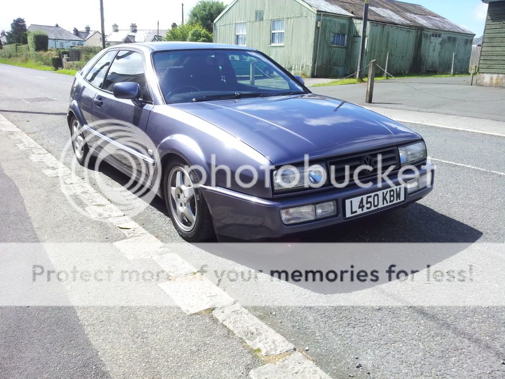

Aqvila 0 Posted September 11, 2013 (edited) Hello All, So bought myself a rather conspicuous Corrado a little while ago thought it was about time to start a gallery! Here she is: And here is what she is hiding: Other notable upgrades are Quaife limited slip diff, KW V3's, 288mm brakes, Jetex 2.5" The list goes on... Mainly just been enjoying driving her she goes like the wind and has been very well put together, which the credit must go to a Mr Kev Bacon. Have raised her off the ground slightly as the roads are a bit to bumpy to be running so low around here I have a plan for her but its top secret! Edited September 11, 2013 by Aqvila Quote Share this post Link to post Share on other sites
