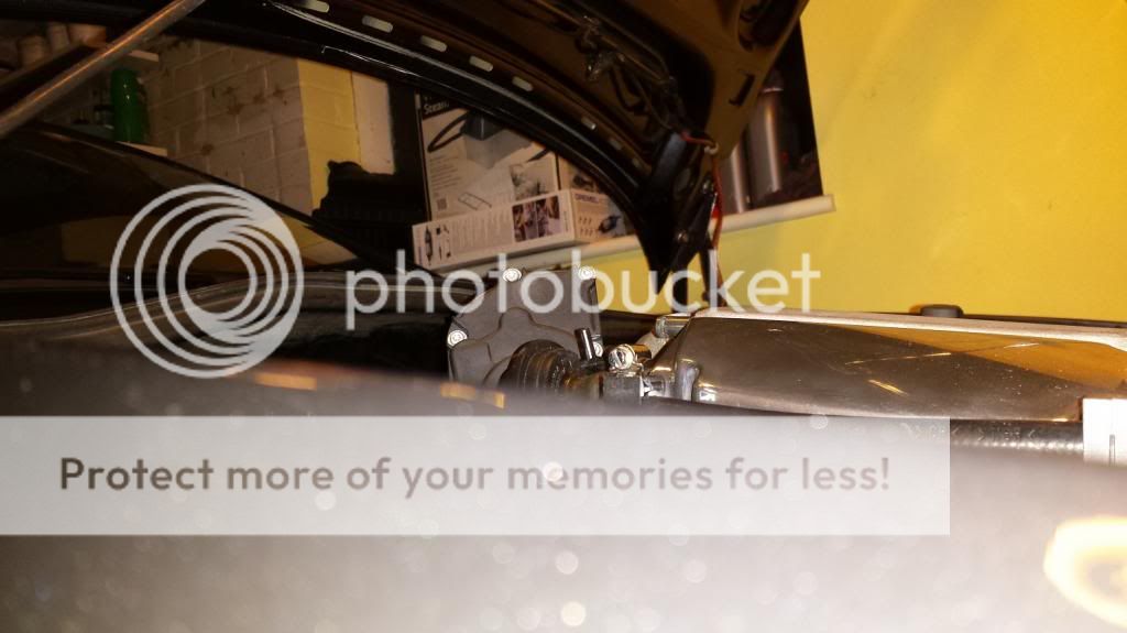

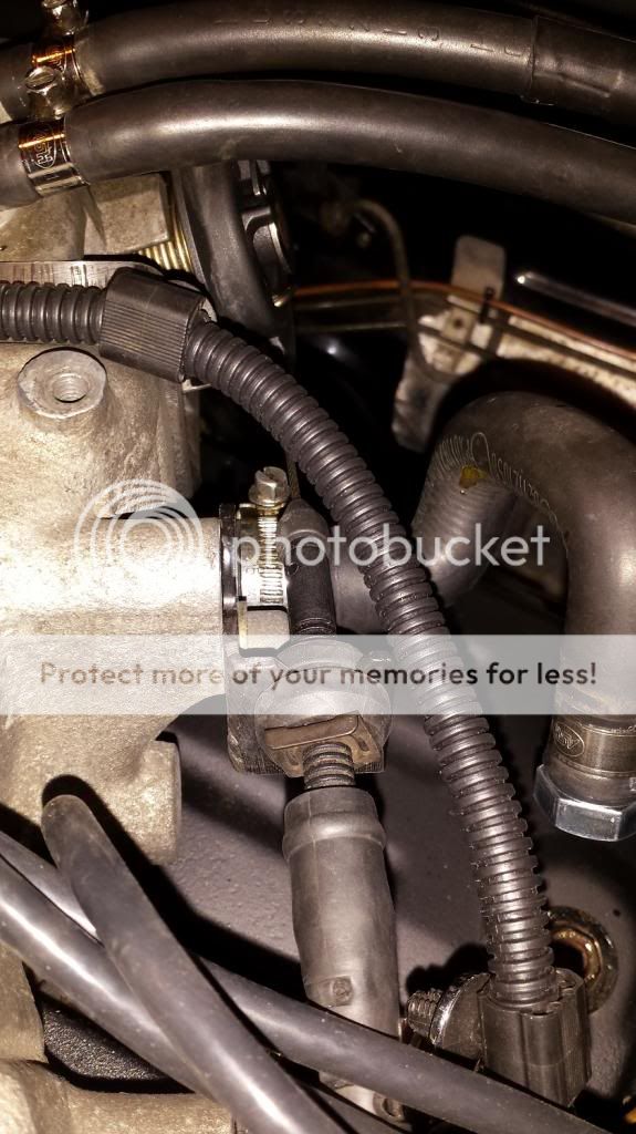

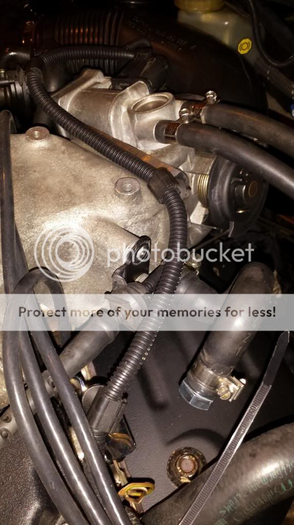

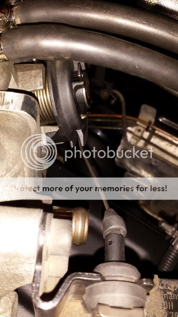

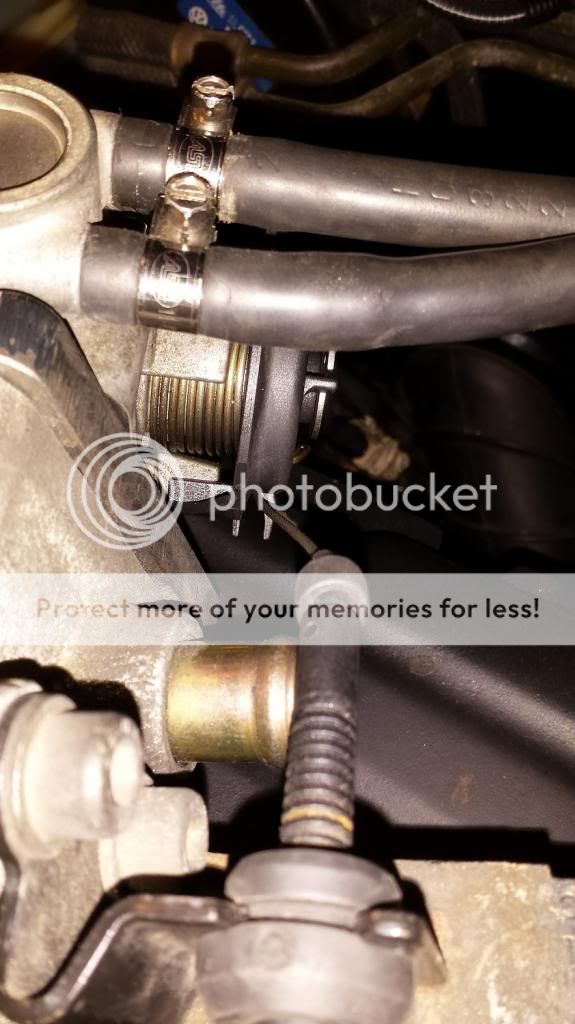

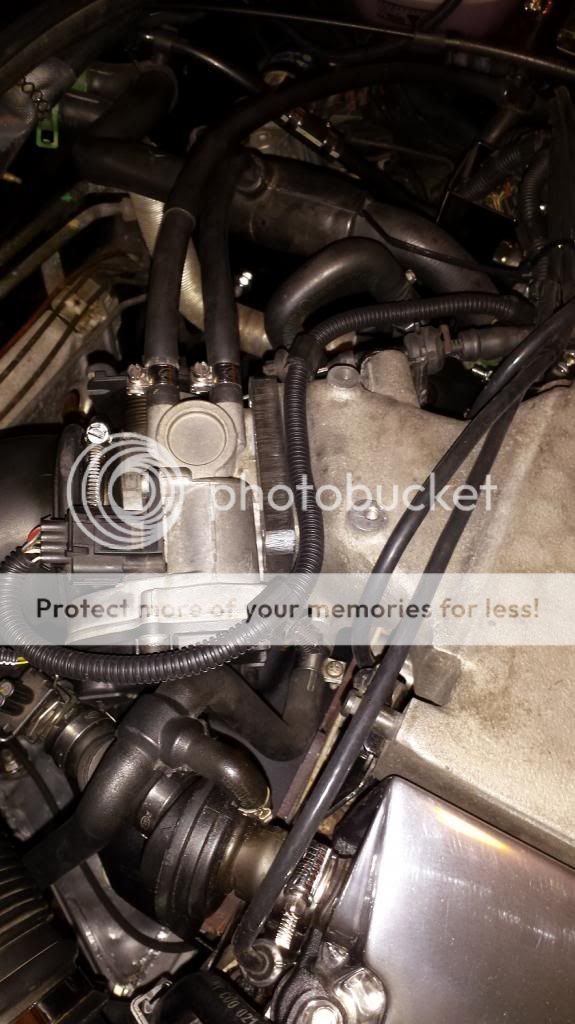

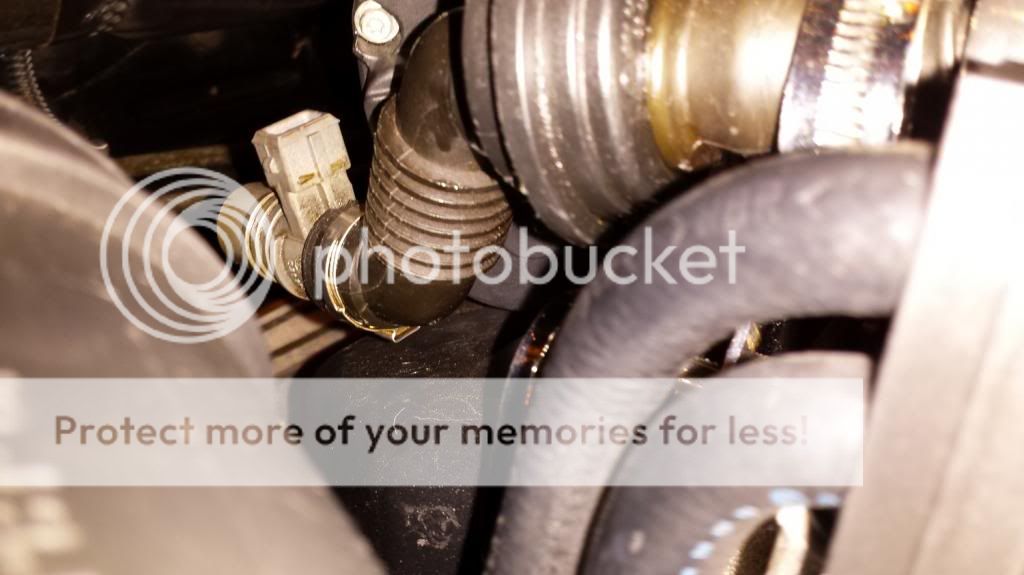

daves16v 1 Posted May 5, 2014 Got around to fitting this set-up, been out for a test run and if I'm honest it didn't inspire me with confidence. Firstly it sound different which I suppose there was a chance of, there was also a strange ticking noise going on which didn't sound too healthy. It also didn't drive as well as before with the OBD2 manifold, seem to have lost some low down grunt and there wasn't any noticeable difference at the top end either. As far as I know I'd fitted everything correctly, blanked off any unused vac ports in the OBD1 manifold and made sure the adapter plate was fitted correctly with gaskets. I can't help thinking there was a reason VW changed the manifold when going to OBD2. Maybe there was something not quite right with my set-up and others who have attempted this have had more success. I'm quite happy to continue to use the OBD2 manifold as I don't think there is a big enough improvement if any using the OBD1 manifold and there are some issues that need addressing before I feel really confident with the new set-up. Anyway I'll talk about those below the photos. Overview of the set-up. There are 2 orientations of fitting the throttle body due to the differences in the throttle body mounting holes in both manifolds. You can see the this in the photos with the throttle body mounted both ways. In both cases the cable doesn't align with the guide on the side of the throttle body and rubs quite a lot when the pedal is pushed. There are disadvantages in both orientations in that one way it's very close to the bonnet - see here. And the other way the throttle body is very close to the exhaust manifold heat shield and in my opinion too close, about 5mm away - can't see it too well in this photo. I had to cut and weld the throttle cable bracket and tilt it down to maintain correct cable alignment with the throttle body cable guide - see here. I ran the car with the throttle body orientated with the water pipes pointing upwards. I think the ideal set-up is to cut and weld the OBD2 throttle mounting to the OBD1 manifold, that way the orientation of the throttle body is not upset and no need for an adapter. For me I'll be sticking with the standard OBD2 manifold. Quote Share this post Link to post Share on other sites
science 0 Posted May 5, 2014 (edited) Cheers Dave, that's some good info. Did you make a twist adapter like the one in the link; http://store.034motorsport.com/products/engine-components/vw-vr6/throttle-body-adapter-obd1-vr6-to-obd2-vr6-tb.html [ATTACH]78499[/ATTACH] I was trying to make an adaptor without the twist. Haven't got around to fitting yet should be a couple of weeks till I know. Do you have any other engine mods, cams ect? Edited May 5, 2014 by science Quote Share this post Link to post Share on other sites
daves16v 1 Posted May 5, 2014 Yep I made one pretty much the same as that one. I've got 263 cams, cone filter outside of the bay and a 2.5" exhaust. Quote Share this post Link to post Share on other sites
