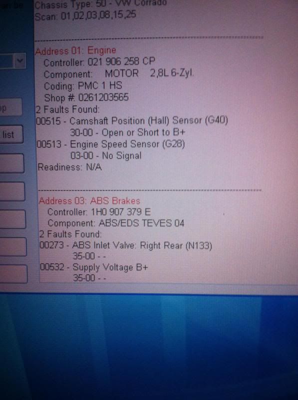

Roger Chatfield 0 Posted November 28, 2013 It needs scanning for codes Little update, Sean has kindly lent me his VAGCOM, here is the ABS code. So, what's my next move?? I take it the supply valve is internal to the abs unit, is it possible to repair? should I try a fluid change first? Forgot to say, the supply voltage problem has cleared, it's just the valve code that remains. Many thanks Rog. Quote Share this post Link to post Share on other sites
dr_mat 0 Posted November 28, 2013 Correct, the valve mentioned is internal and cannot be repaired. Pick up a used one - the modules are actually extremely reliable so the odds of getting a duff one are small. Quote Share this post Link to post Share on other sites

dr_mat 0 Posted February 10, 2014 Supply voltage gets recorded any time you disconnect the battery. Or if you have a really bad connection on the top of the ABS ECU (they can get damp and corrode sometimes). Quote Share this post Link to post Share on other sites
