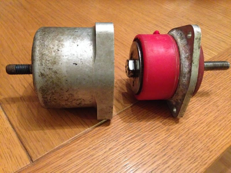

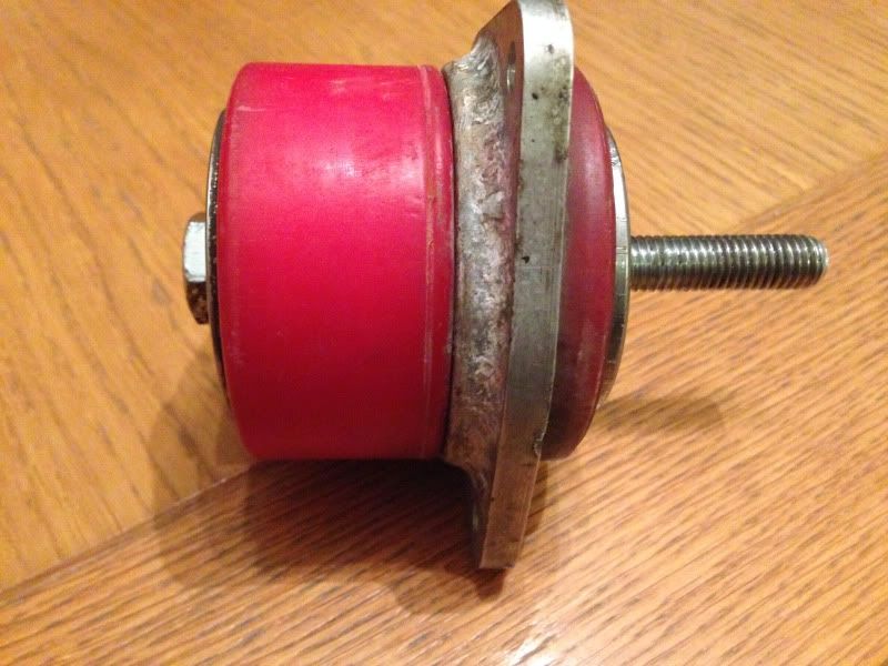

Jamie 1 Posted November 14, 2013 Little update for you gents just in case any of you find yourselves in a similar predicament to me. I took the mount apart and it's basically a long bolt with a plate, steel bush, poly bush, the top mount cover, another poly bush then the top plate (which is threaded and holds it all together). The bolt on mine had snapped so I just broke it all down - took a bit of heat and a fair bit of brute force but it came apart in the end - and replaced the bolt. Job done :) Quote Share this post Link to post Share on other sites
