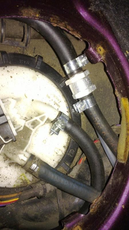

After my own "nightmare" with starting problems (though always did start, and was especially cumbersome when hot) and after changing out several more expensive parts this is the thing I would check first:
Didn't have total failure of start myselfe - but tried and changed out quite a few parts before I found the culprit on my Corrado.
I had intermittent starting issues with the C from the day I got it (the guy selling was honest about it) - but especially when it was warm it was a hard car to start.
Turned out it was the "non-return" valve in the fuel pump that's not doing it's job - actually VW issued a "fix" for this problem - which is basically a hose with an inline non-return valve builtin, but sadly discontinued.
I ficed mine with a non-return valve from e-bay and some extra fuel hose (so I didn't have to cut the original hose) - took of the original hose from the feed line, and inserted the non-return valve in between the pump and the original fuel hose.
Never had any starting issued after this
Image of fic on my car:
