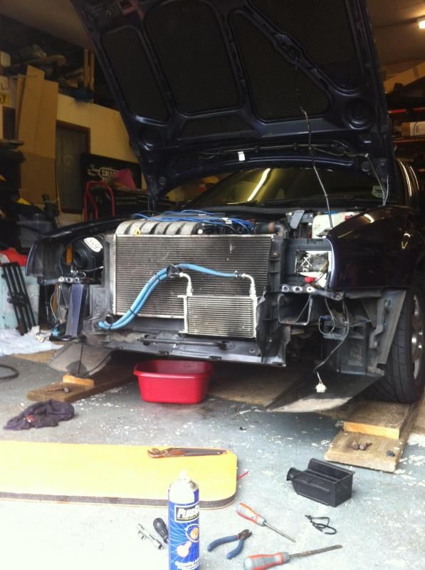

Roger Chatfield 0 Posted August 15, 2014 Hi all, As some of you know I'm currently sorting out a few cooling issues with 'Stormy' So, while I have the front off I thought I would sort out the oil cooler. I'm thinking I may move it to a different location so it gets better airflow, currently it sit in-line with the number plate. So I'm thinking either move it up which would mean mounting it upside down or move it to the side which would mean mounting it sideways. Would there be a problem with upside down or side mounting?? I'm thinking possible air locks etc. Or should I just leave it where it is. Rog. Quote Share this post Link to post Share on other sites

Roger Chatfield 0 Posted August 16, 2014 Well I've had a quick look round the inter web and there seems there is no reason why I can't run this cooler upside down so I've decided to mount it under the slam panel. Rog. Quote Share this post Link to post Share on other sites
