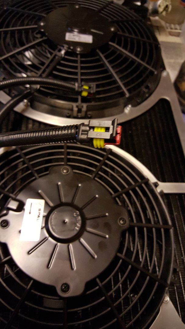

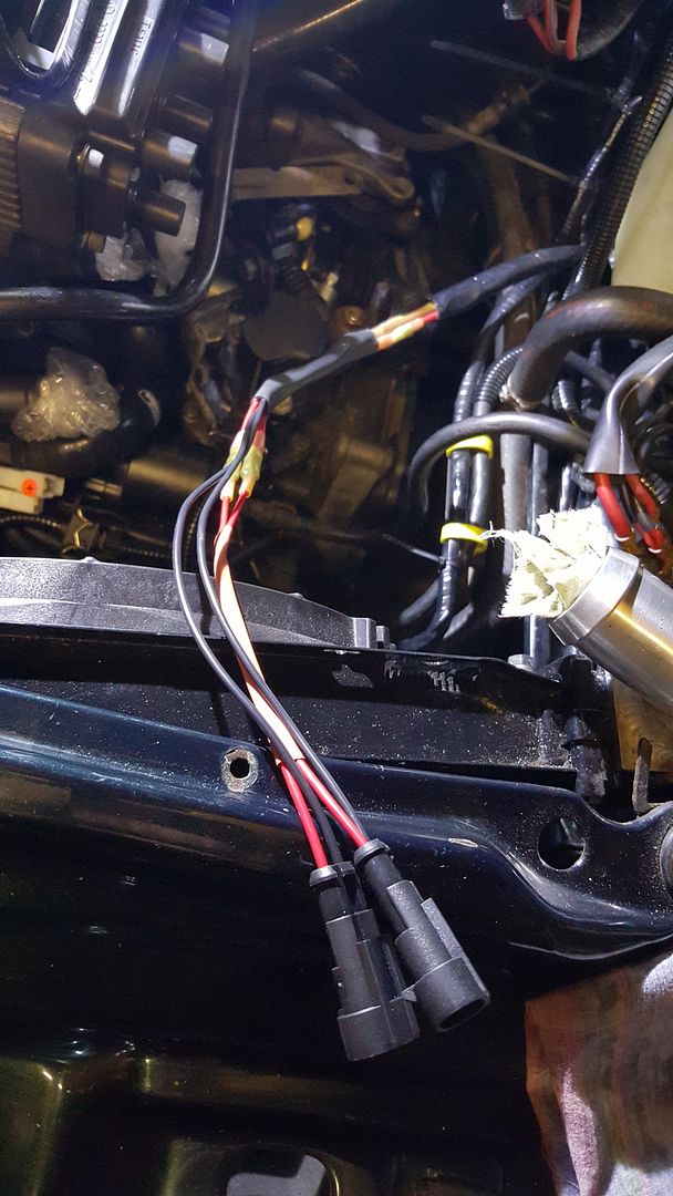

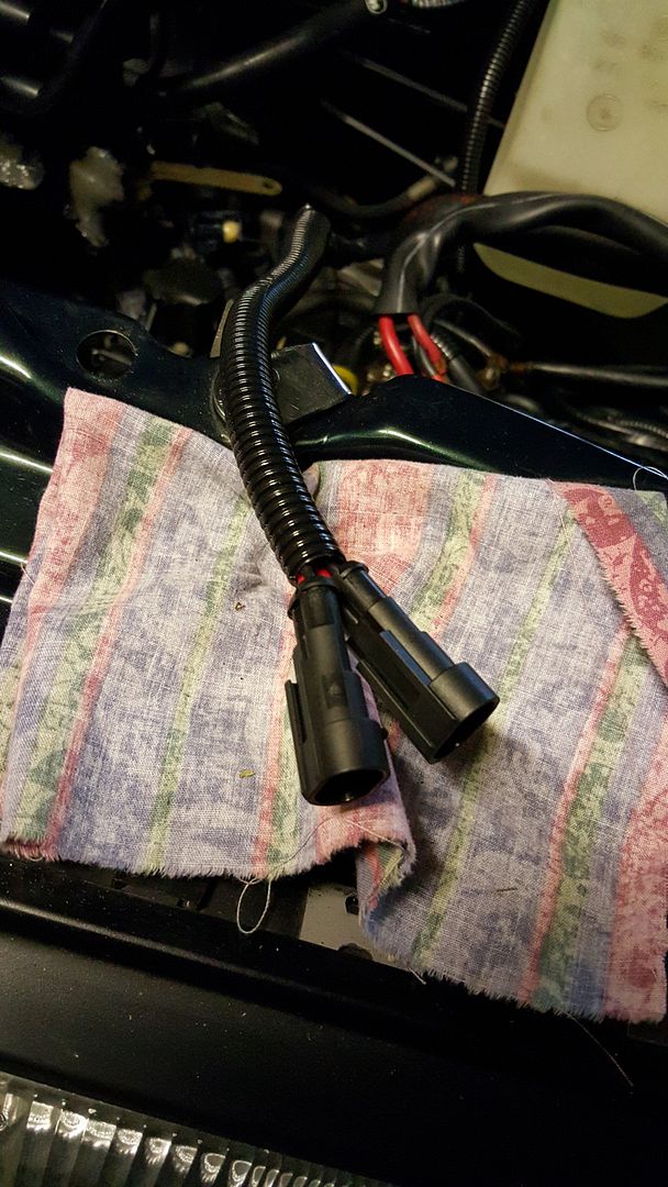

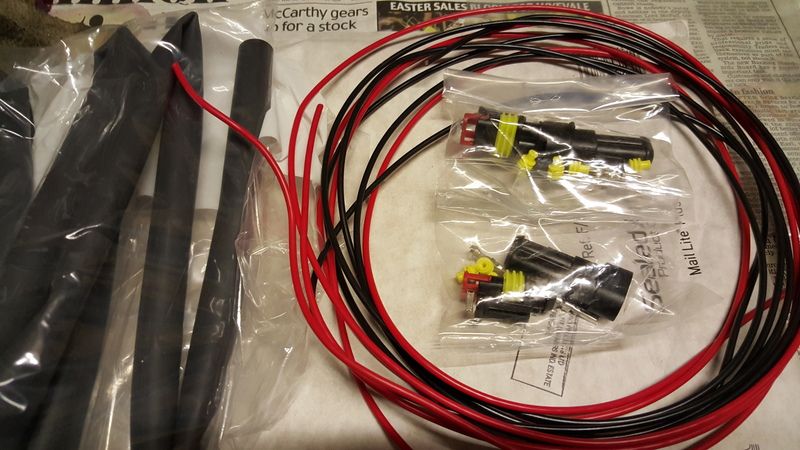

Jim Bowen 1 Posted August 26, 2015 Got this sorted now, although haven't been able to test anything yet. Bought superseal connectors and some thinwall wire Pretty much made the same as you, split the 3 lives from fan controller so each had two wires coming off it (used Duraseal connectors), then joined one of each of the new ones into 1 wire again using the duraseals, so that meant just having one wire into the superseal connector. Wrapped the loom in tape then added some ducting Then added the superseals to the fans Quote Share this post Link to post Share on other sites

Jim Bowen 1 Posted October 23, 2015 Got mine from a place called vehicle wiring products. Used them a few times now. Quote Share this post Link to post Share on other sites
VR6 Lee 0 Posted October 23, 2015 Any idea of the part numbers Quote Share this post Link to post Share on other sites
VR6 Lee 0 Posted April 3, 2016 Got this sorted now, although haven't been able to test anything yet. Bought superseal connectors and some thinwall wire Pretty much made the same as you, split the 3 lives from fan controller so each had two wires coming off it (used Duraseal connectors), then joined one of each of the new ones into 1 wire again using the duraseals, so that meant just having one wire into the superseal connector. Wrapped the loom in tape then added some ducting Then added the superseals to the fans Where did you get this lot from? Quote Share this post Link to post Share on other sites
Jim Bowen 1 Posted April 3, 2016 I think it was fob a website called vehicle wiring products. Quote Share this post Link to post Share on other sites

Jim Bowen 1 Posted April 3, 2016 I'm not sure. I think i just linked to where i bought my fans from. I can confirm it all works as it should. Done about 2500miles since fitting them. They push a lot of air, might try and measure the speed as i was impressed when i put my hand behind them. Quote Share this post Link to post Share on other sites
