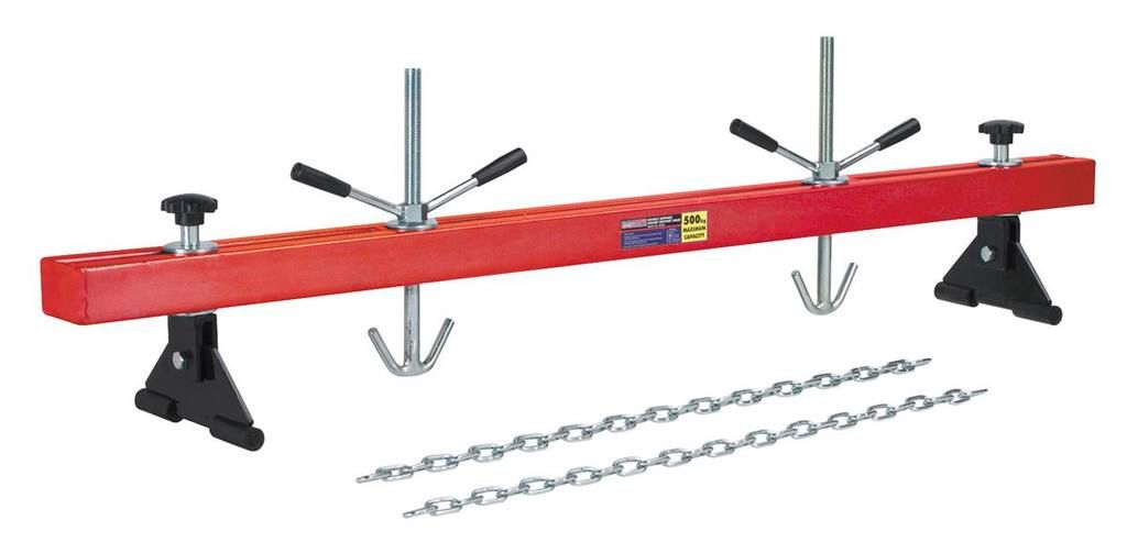

easypops 8 Posted August 22, 2016 I've ordered one of these, just so I can drop the subframe, wishbones/hubs all in one go.......sounds easy when you say it fast :lol: And I've lost my breaker bar :( Quote Share this post Link to post Share on other sites
robrado974 1 Posted August 22, 2016 That should make things easier , Easy . Quote Share this post Link to post Share on other sites
