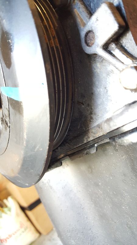

Mark on the pulley, i stick some tape to the outside of pulley to make it easier to see quickly when turning it.

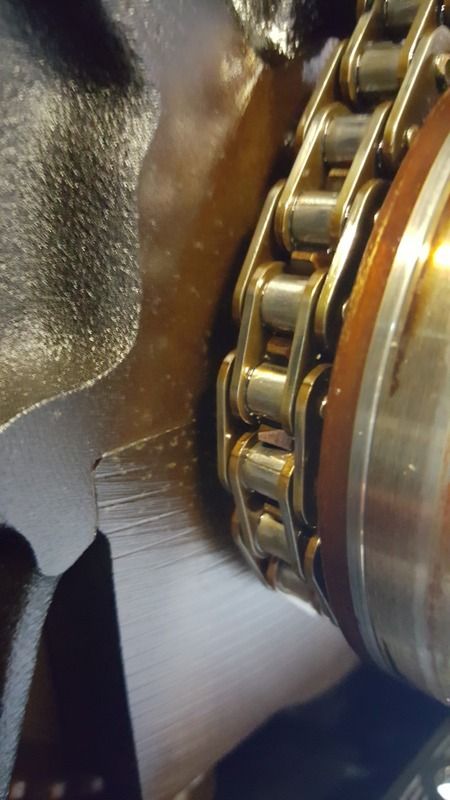

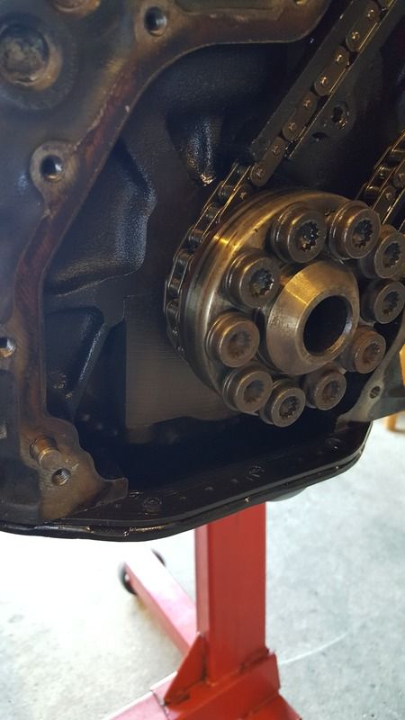

First thing to note is the ground tooth on the crank sprocket
If you look closely there is one tooth that has been ground so its different from all the others. This will want to line up with the seam on the block.

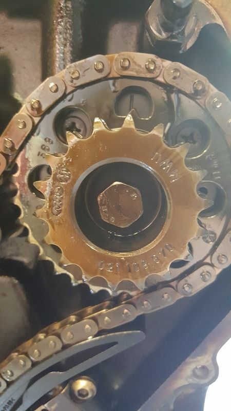

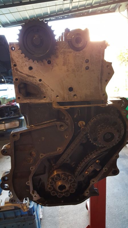

On the intermediate sprocket there is an arrow, and you want that pointing vertically up, i found for each complete turn of the crank pully this arrow will move 90 degrees, so you may have to turn the crank a few turns. I had no cams in the engine at this point, but if cams are installed you will probably hit them with the pistons
Another bit to note (this is what Vince told me), once you think the intermediate marking is lined up, check from above that you can see the little notch in the plastic, if you don't see this keep turning crank pulley until the sprocket mark is vertical and you can see the notch from above

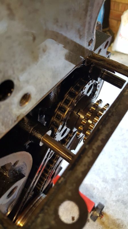

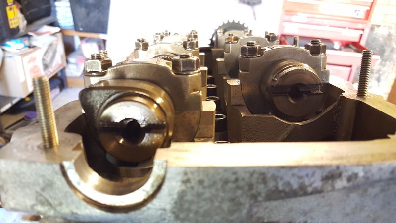

Cam want fitting so the smaller lobe is on top, the cam locking tool only fits one way anyway
Once your at this point, i find it easiest to leave one cam sprocket off, fit the upper tensioner, drop the chain in to intermediate sprocket and one cam sprocket, and then fit the other cam sprocket to chain and then push it onto the cam, after all in place i then fit the black plastic guide.

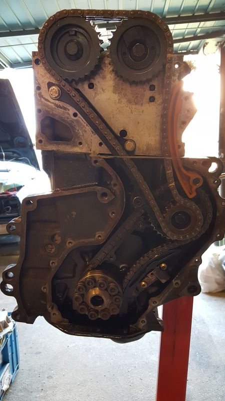

All fitted

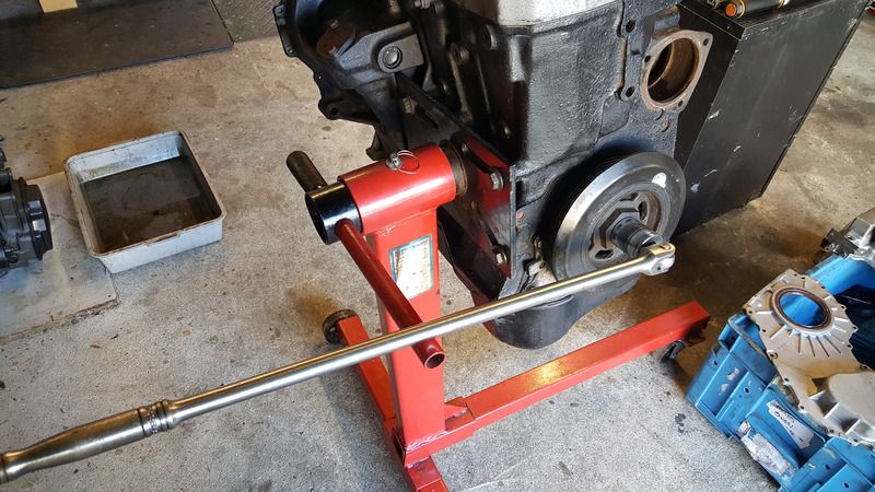

Nice way to lock the crank when using an engine stand
After all is fitted, fit the upper chain cover and tensioner bolt and then turn crank pulley 4 complete turns and all the marks should end up where they were.
