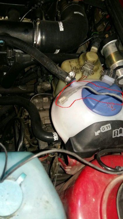

Just at the same time I get the engine running again (fuel pump and fuel leveler replaced) , I lost the displays on my cluster gauge:

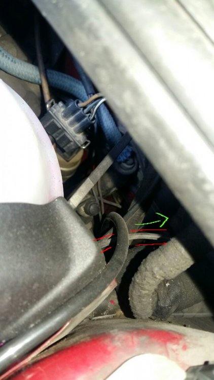

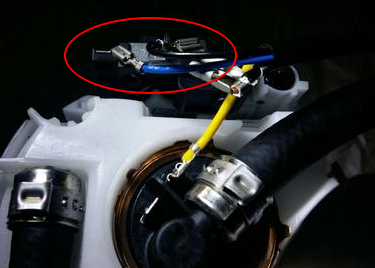

The fuel level indicator is working correctly (in those pictures can't we see it). So, the fuel pump I think it's well mounted and wired and have no relation of any kind to this new problem. I said that because I had a problem with one wire of the fuel pump:
Because yellow is touching black terminal, I put a plastic clamp between them to fix it. don't think this is the cause of the problem, I think it's only a coincidence.

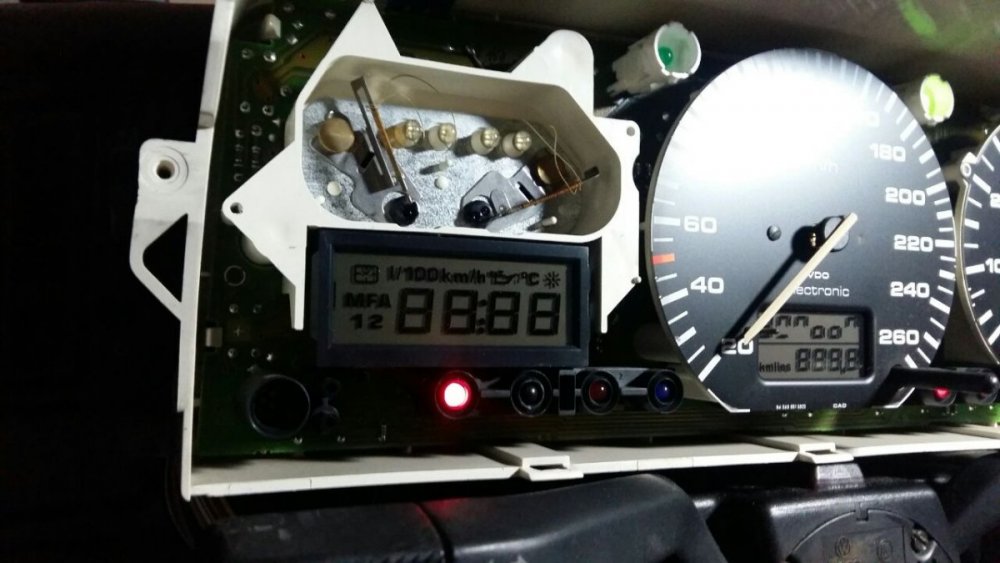

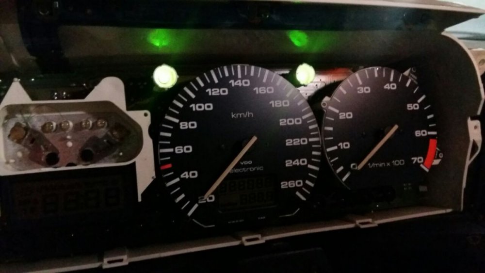

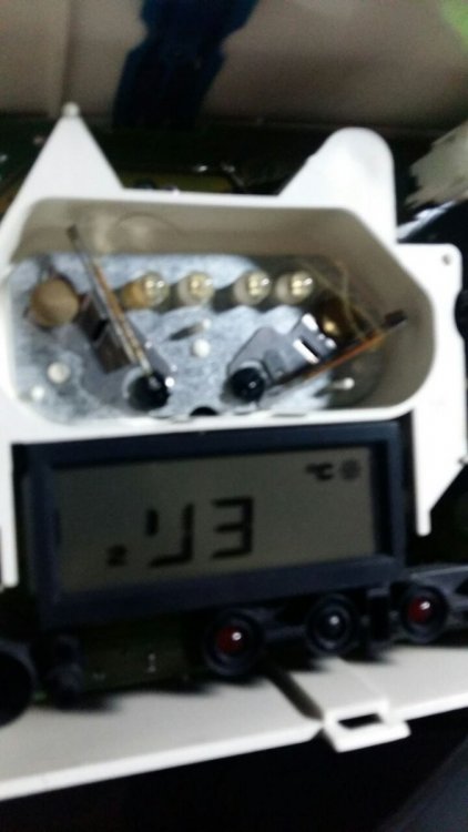

Gauge cluster video:
Around second 20", if you pay attention, you should listen a sound at the same time of acceleration. It's like a kitty meowing:

The displays were fine until I try to start the engine with the new fuel pump, what had a shorten black wire (pictures). This shorten wire I already fixed with an extension cable.

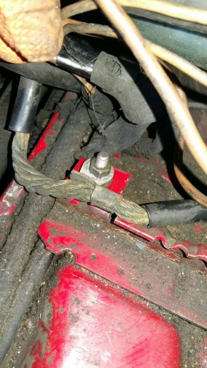

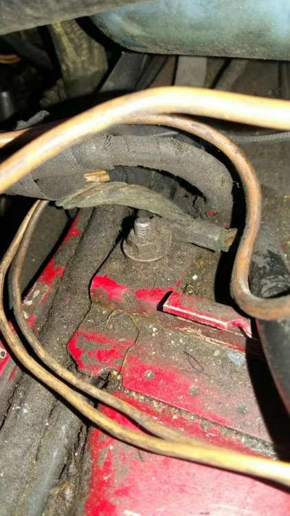

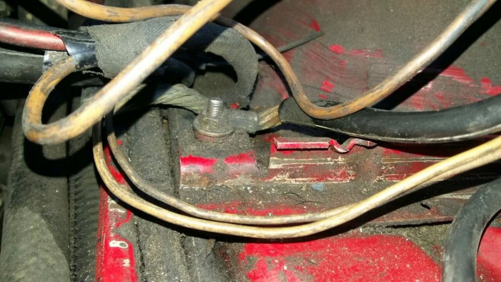

Have you checked the battery earth? There is an earth stud just behind the battery on the chassis leg that the neg terminal (and a few others) connect to. If it's intermittent when you're moving the battery around, chances are it's either that or the cable itself. Also worth completely disconnecting your fuel pump too. It may have been coincidence that it started around that time, but completely removing all wires (ensuring you don't short them on eachother) will rule that out.
I checked some grounds, but I don't know where is that one you mention 🤔

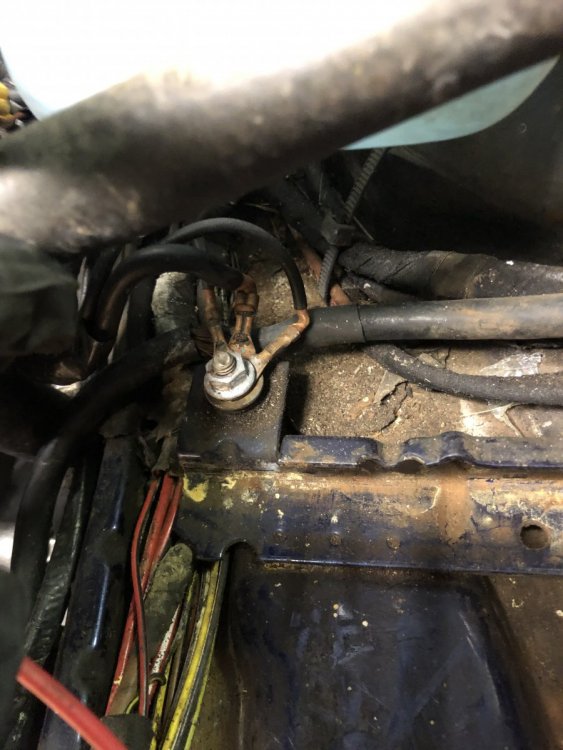

It’s behind the battery to the left as you look at it from the front of the car. Take the battery out to get proper accessD7C5B306-F2E7-4E9C-97E6-7E6E2A5965C5.thumb.jpeg.90ddd46618cb75d9c74743094d9e76e1.jpeg. Mine looked like this before I cleaned it up.
  • Like 1
4 minutes ago, 1xshaunx1 said:
It’s behind the battery to the left as you look at it from the front of the car. Take the battery out to get proper access.
Thanks guys, I'll check it later today. I think it's possible the reason, because I put in and out the battery few times, because I use the same for my two cars.

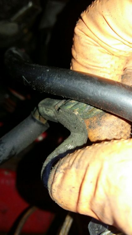

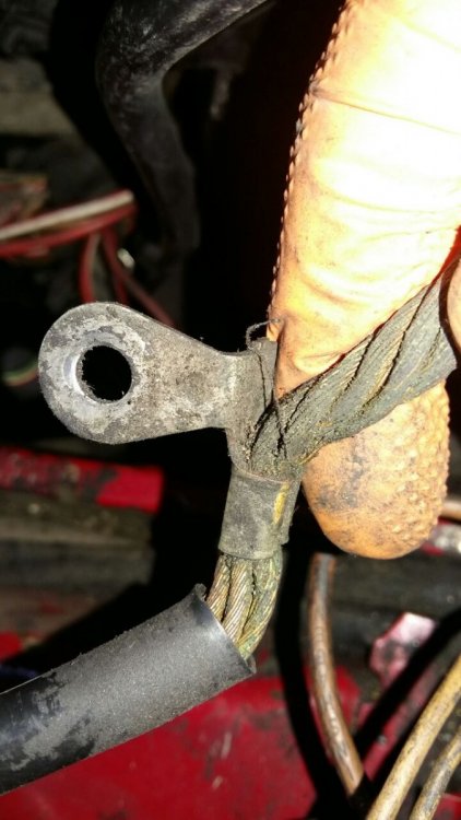

Ok, checked and cleaned. Problem still happening but this was a quick and important check to do.
rear_ground1.thumb.jpeg.fdb20c8ec3c963b928478ec46250c5f7.jpegrear_ground2.thumb.jpeg.5f14b35e8e654f6ab1919e81624bb864.jpegrear_ground3.thumb.jpeg.f6752dc89efc9c74b7d713af2c451ab7.jpegrear_ground4.thumb.jpeg.21bfd75bc4f3f874aa528eafc5da2d65.jpegcleaned_ground1.thumb.jpeg.44e5c499dd63cbd8c69c26d30347c162.jpeg
In last picture the ground is incorrect mounted. I fixed after the shot.

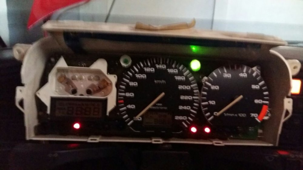

When I go to check if it cluster gauge works, nothing happens... unless now I have permanently ON the right indicator lamp and the right indicator doesn't works. This  is because the right light position it's ON and I cannot put it off. So I pull out the relay and pull it in again... I don't remember all the things I did, but in a one of those tests, the cluster gauge ignition key lamp works when I turn the key on that position:
In other of these tests, I have the two direction indicators ON:
At this point I am stuck, but I found a missing wire ground rolled on the left suspension cover. So I unrolled:
I don't know what is this, but it's very long and come from the inside of the car:
So, with the cluster gauge with the two directions lights ON, I put this missing ground to the battery ground and magically, they put it OFF.

3 hours ago, Bennitoapplebum said:
I’d double check that ground wire going into the car.  Someone has worked on the car previously.  Theres a possibility that they incorrectly bypassed a ground, giving you a bunch of problems.  These cars are old, and any wire that *looks* okay, needs to be confirmed through thorough testing.
Would you happen to have the Bentley Manual?
Posted (edited)
I had the car since 2007. That wire it's always missing (I forgot about that). But it's true it always got problems in idle rpm's and 3 cylinder running at high temperatures. In the past I fixed other grounds I found broken or missing.
That one I don't trust it fix the gauge problem, because it works since I bought it, but I will fix it, for sure.
