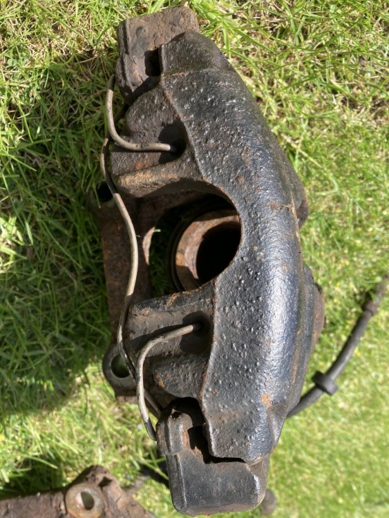

fendervg 33 Posted June 3, 2021 There are two different types of 288mm callipers, one with banjo fitting, one with a screw fitting, and different cylinder sizes - so watch out: From VR6 Golf3, banjo fitting 3A0615123 calliper with 54mm pistons lh 3A0615124 calliper with 54mm pistons rh From Passat,screw thread 4A0615123A calliper with 57mm pistons lh 4A0615124A calliper with 57mm pistons r I've never seen the Passat ones in person, I bought new Mk3 ones from VW when I did mine, and used the Goodridge braided hoses with the banjo fitting. Both types are ATE. Quote Share this post Link to post Share on other sites

Dox 23 Posted June 3, 2021 (edited) 1 hour ago, fendervg said: There are two different types of 288mm callipers, one with banjo fitting, one with a screw fitting, and different cylinder sizes - so watch out: From VR6 Golf3, banjo fitting 3A0615123 calliper with 54mm pistons lh 3A0615124 calliper with 54mm pistons rh From Passat,screw thread 4A0615123A calliper with 57mm pistons lh 4A0615124A calliper with 57mm pistons r I've never seen the Passat ones in person, I bought new Mk3 ones from VW when I did mine, and used the Goodridge braided hoses with the banjo fitting. Both types are ATE. These are the ones found from your part numbers, note the shoulders are square, these I believe are mk5 type callipers These are Mk3/4 note how the shoulders taper? Sent from my iPad using Tapatalk Edited June 3, 2021 by Dox Quote Share this post Link to post Share on other sites

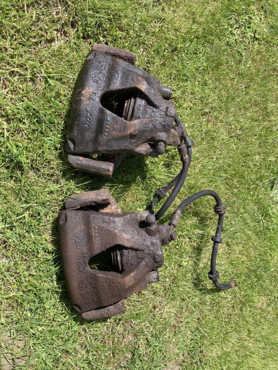

Keyo 47 Posted June 5, 2021 (edited) So I got this from a mk3 breaker fir £59 - take it they are the correct ones - they look gross - you all reckon big redd can make them good again . Do big Redd put new sliders and pins for the the pad carrier. Edited June 5, 2021 by Keyo Quote Share this post Link to post Share on other sites
tonedef 9 Posted June 5, 2021 Big Redd send them back looking like new, seals, pistons, guides, sliders, the lot! The only piece they didn’t replace apart from the obvious calliper body was the spring. Quote Share this post Link to post Share on other sites
Keyo 47 Posted June 5, 2021 2 minutes ago, tonedef said: Big Redd send them back looking like new, seals, pistons, guides, sliders, the lot! The only piece they didn’t replace apart from the obvious calliper body was the spring. Ok thanks mate they look good - is it worth taking the springs out before I send them to them - cheers. Quote Share this post Link to post Share on other sites
tonedef 9 Posted June 5, 2021 Just now, Keyo said: Ok thanks mate they look good - is it worth taking the springs out before I send them to them - cheers. I think they ask you to remove all loose parts before you send them anyway. So yes 👍 Quote Share this post Link to post Share on other sites

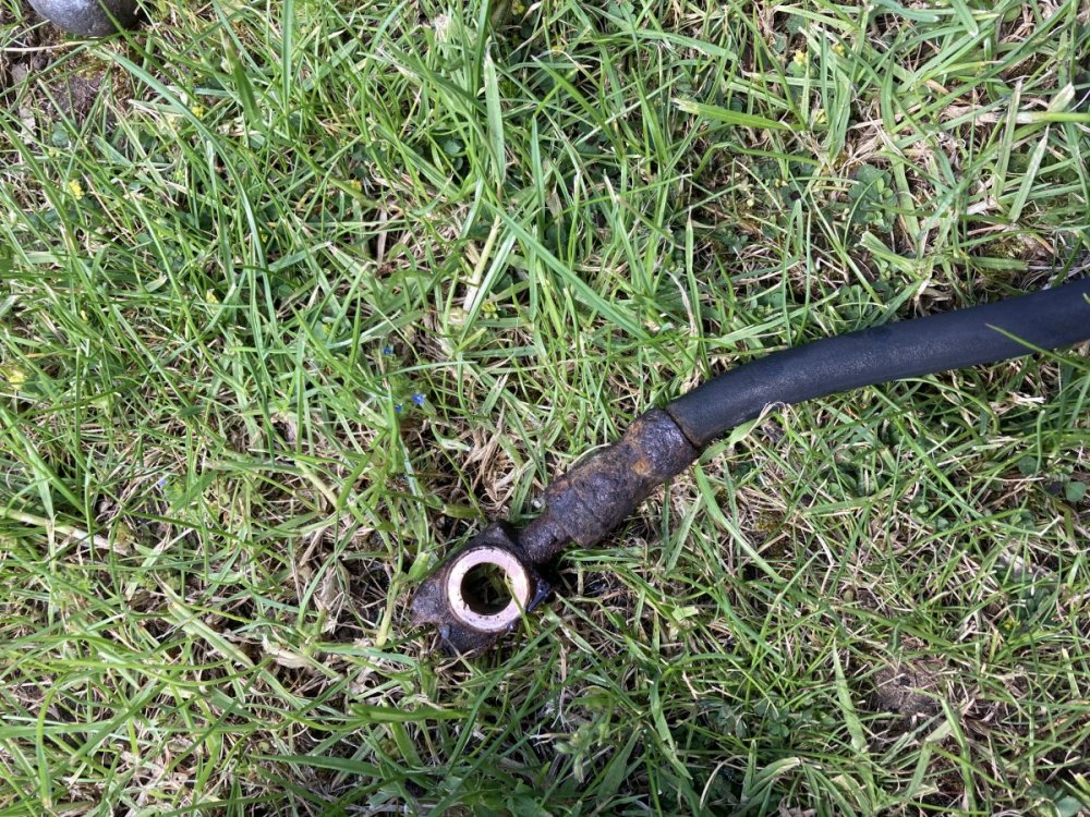

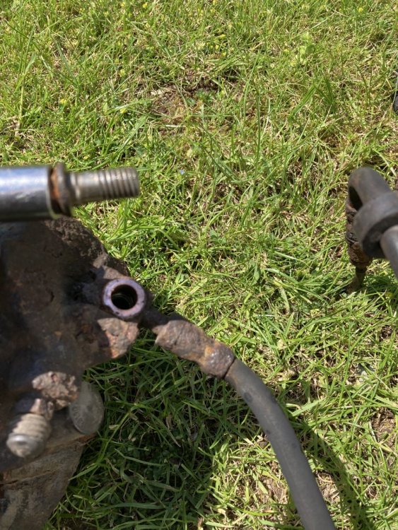

Dox 23 Posted June 5, 2021 They do look like MK3, notice how rusty the pistons are. I'd remove the banjo bolts before shipping, there's 2 types of thread pitch and you can use them to make sure you have the correct ones in your hose kit. Quote Share this post Link to post Share on other sites
Keyo 47 Posted June 5, 2021 35 minutes ago, Dox said: They do look like MK3, notice how rusty the pistons are. I'd remove the banjo bolts before shipping, there's 2 types of thread pitch and you can use them to make sure you have the correct ones in your hose kit. Thanks all all ready have the banjo bolts stashed . Quote Share this post Link to post Share on other sites

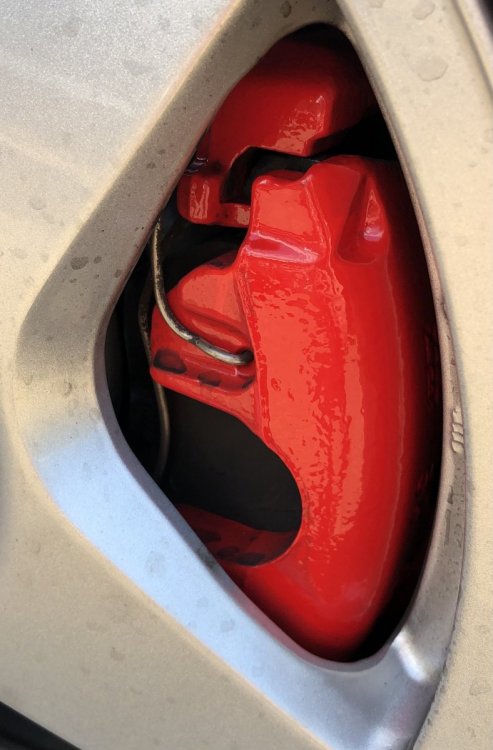

Cressa 44 Posted June 5, 2021 They will come back looking mint. Can you see if there is an anti rattle plate fitted at the carriers where the pads sit . I always wondered whether these should have them? Quote Share this post Link to post Share on other sites
Dox 23 Posted June 5, 2021 50 minutes ago, Cressa said: They will come back looking mint. Can you see if there is an anti rattle plate fitted at the carriers where the pads sit . I always wondered whether these should have them? I think that job is dealt with by that spring contraption? Quote Share this post Link to post Share on other sites

fendervg 33 Posted June 6, 2021 On 6/5/2021 at 4:42 PM, Cressa said: They will come back looking mint. Can you see if there is an anti rattle plate fitted at the carriers where the pads sit . I always wondered whether these should have them? I think they don't have the anti rattle plate because the pad on the piston side clips into the piston with three spring plates that are attached to the back of the pad. Quote Share this post Link to post Share on other sites
