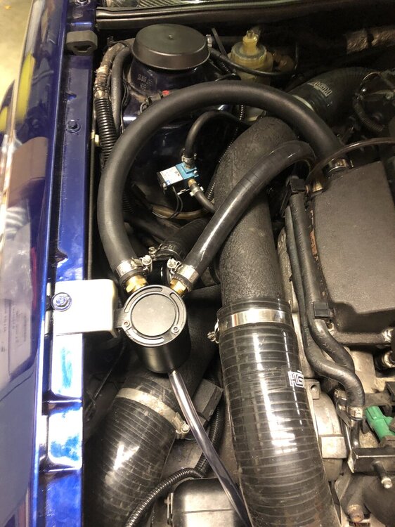

Funnily enough I’ve come to the same conclusion and have been experimenting lately with one  19mm hose in 16mm hose out and a 10mm drain pipe with a 3/8 ball valve on the end for drainage. The 10mm is the latest experimental addition for easier drainage and a visual idea of what’s happening

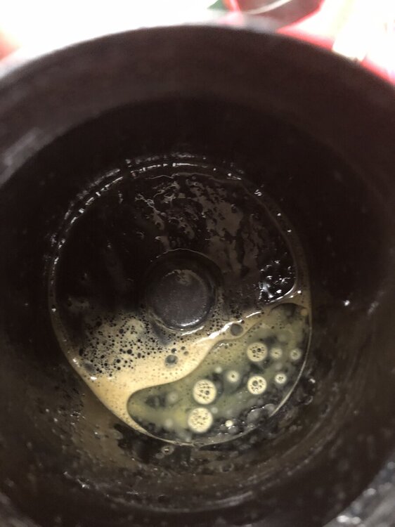

My first experiment of one reveals just how much water mixes with your oil while the car is stood. The car hadn’t moved for about 3 weeks fitted the can and went for about 30 mile. Look at what nasty has been going through my intake system.
😳 yuk.... got to be a good idea. Whose make of catch can do you have there Shaun?
Cheap Chinese one off of EBay. I bought it for £15 on 2 Jan, I can’t believe it’s gone up over 33% in a month. The pipes and fittings cost the most698E99E0-3605-4A96-A2C7-356065A214E2.thumb.png.a33a0938f8eb67c788c275fd468d03f1.png

Great pics Shaun, although yours is boosted isnt it?
I'm looking for a good place to mount the can - only had it about 7 years in the box! - but if there were the space at the front that would be ideal. The fittings i have are only for a 16mm hose though - where did you get the 19mm fitting?
Hasan
3/8 x 19mm off of EBay, just type in the search, the size you want and the type of thread, it all came from EBay. Used loctite 577 to seal the threads.

What have you done with the small diameter hose that is connected to the blue evap solenoid and three way pcv hose which is part of the carbon cannister that releases when to much pressure in cannister  - i believe this is combined with the evap  system and burns off petrol fumes .

I think I've read it needs to be looped in the circuit?
Will have to be or you’ll be sniffing in petrol fumes through the heater fan .
interesting point that if that evap fumes delivery to intake is 1 percent out can cause 20 percent .
