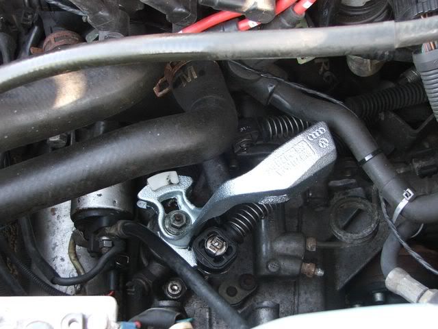

GVK 0 Posted December 9, 2008 no no you can fit the 02M components onto the 02A gearbox. I dont know the details, cos i didnt do it, but phatvr6 has done it before. I think the mechanism just plugs into the top of the gearbox. edit: maybes it should be called a mk4 shifter to avoid confusion because you get the mechanism off a mk4 with an 02A gearbox i think. Awesome project :grin: Regarding the mk4 shifter swap, I got some bits from Paul (phatvr6) to do mine in my mk2 VR6. Basically you can use any mk4 shift lever, even a 6spd one with the cables, then you need the corresponding 5 spd 02J tower for the top of the gearbox to match the cables, as some have parallel pins and some have ball fittings. Only other thing you may have to do, is the tower support in the base of the gearbox ( 2 bolt fitting,has a vw logo on it) is sometimes a different diameter to match the tower you use and you have to change that also (I didn't need to) Well worth doing, as the regular 02A shift is generally vague and cr*p in my experience. :cuckoo: mk4 IV R32 lever/cables Shiny fore-aft lever is from a TT to reduce the throw. ps - sorry for thread hi-jack :gag: Quote Share this post Link to post Share on other sites
junkie 0 Posted December 9, 2008 Thanks for the info on the shifter swap and Momo Monte Carlo 350mm? Quote Share this post Link to post Share on other sites
GVK 0 Posted December 10, 2008 Hi, cheers - it's a model 78 I think ( it was 2002 when I bought it, so memory is a bit vague ) Quote Share this post Link to post Share on other sites
