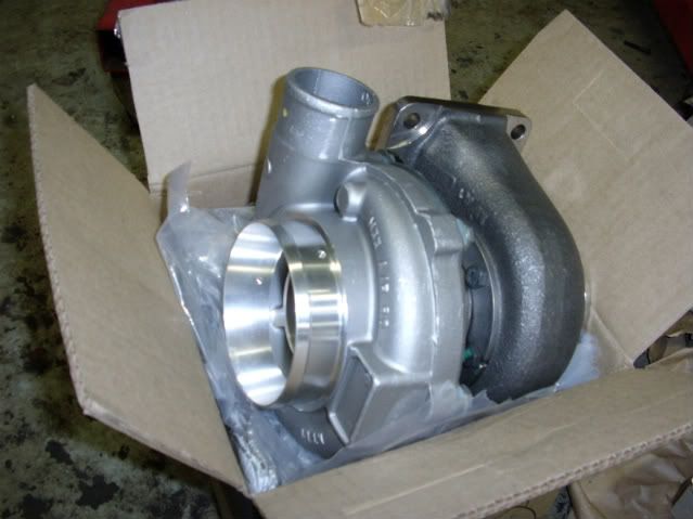

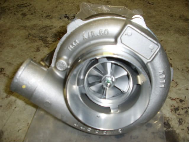

black dub 0 Posted January 20, 2009 hi people i just thought id post up a couple of pics of some new parts and to clear up a couple of issues with the SPA turbo manifold, i have brought a genuine SPA manifold from strictly dubs as they are just down the road from me and i took some exhaust gaskets with me to check and all is good with port and stud allignment it also seems that the manifold i got has been coated as it was one of SPA's display manifold. i also got a 38mm Tial wastgate while i was there too. i now want to buy my turbo but am unsure of which to buy it is either a Garrett GT3076 or a GT35, the thing is i am using the standard inlet manifold so i am guessing that will make things a little more laggy on spool up. i would like to be on full boost before 4,000 rpm. my spec so far is Schrick BVH, SP263 cams, Wossner 82.5mm low comps, ARP bolts and OBD2 convertion. cheers Quote Share this post Link to post Share on other sites

jamminvr6storm 0 Posted January 20, 2009 black dub said: hi people i just thought id post up a couple of pics of some new parts and to clear up a couple of issues with the SPA turbo manifold, i have brought a genuine SPA manifold from strictly dubs as they are just down the road from me and i took some exhaust gaskets with me to check and all is good with port and stud allignment it also seems that the manifold i got has been coated as it was one of SPA's display manifold. i also got a 38mm Tial wastgate while i was there too. i now want to buy my turbo but am unsure of which to buy it is either a Garrett GT3076 or a GT35, the thing is i am using the standard inlet manifold so i am guessing that will make things a little more laggy on spool up. i would like to be on full boost before 4,000 rpm. my spec so far is Schrick BVH, SP263 cams, Wossner 82.5mm low comps, ARP bolts and OBD2 convertion. cheers Sounds like you are coming along Mark :D The question of GT30 or GT35 should spark a good debate in this thread, I went for the 3076 for the quicker spool. From what I hear the 3076 is good for upto 500hp if you want more power then that you will need the GT35. Mine arrived from the states yesterday :clap: Quote Share this post Link to post Share on other sites

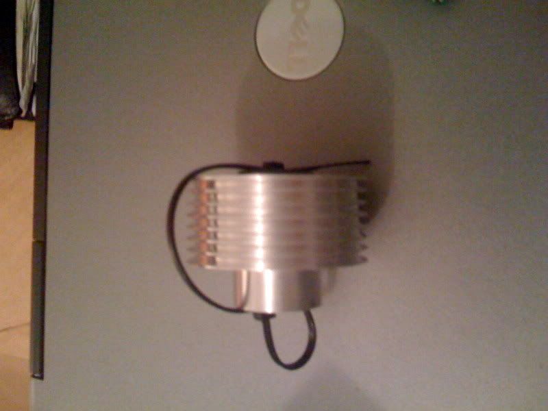

jamminvr6storm 0 Posted January 20, 2009 Corradude said: If I wanted to go 10 psi on my V9 would it just be a case of getting a smaller pulley, or would I start to need looking at gasket spacers and charge cooling? (i do have a water injection pump, but its not quite hooked up yet...long story...) In my opinion you will be fine with 10psi on standard CR, you will need to hook up that water injection tho! I know a guy who makes the pulleys up if you need one, blackdub will vouch for them as he bought one. Here is a pic of the 10psi pulley I had made and used on my V9 on standard CR with the Schimmel water/meth injection. Quote Share this post Link to post Share on other sites

Kevin Bacon 5 Posted January 21, 2009 If your turbo has a 4" inlet then the brake resevoir will need relocating. A lot T3/T4e turbo users get away with it as they only have a 3" inlet, which just about squeezes in the gap. Moving the brake pot isn't difficult. You'll need a little motorbike pot for the clutch and Rally Design sell a nice twin outlet pot with level sensor for the brakes, which can be mounted above the heat matrix hoses like Shaun's, then you just run hoses over to the master cylinder. Black dub, your manifold looks a damn site better than mine, good luck with that. Personally I would go GT35, but if you do, I would upgrade to a 44mm Wastegate. If you go GT30, the 38mm Wastegate is OK for that. Both the GT30 and GT35 will be full boosting before 4000rpm if you go for the 0.82 back housing. Your stock manifold will give a better midrange - 3500 - 4000 rpm - and shouldn't be laggy. Quote Share this post Link to post Share on other sites
