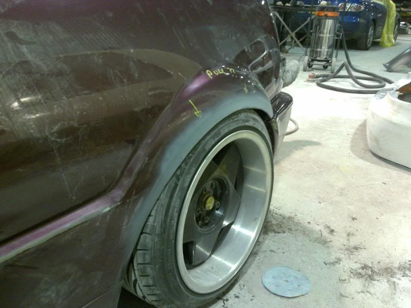

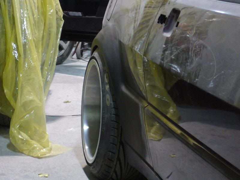

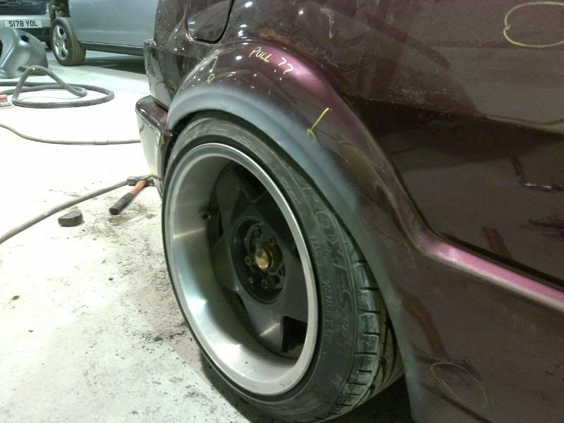

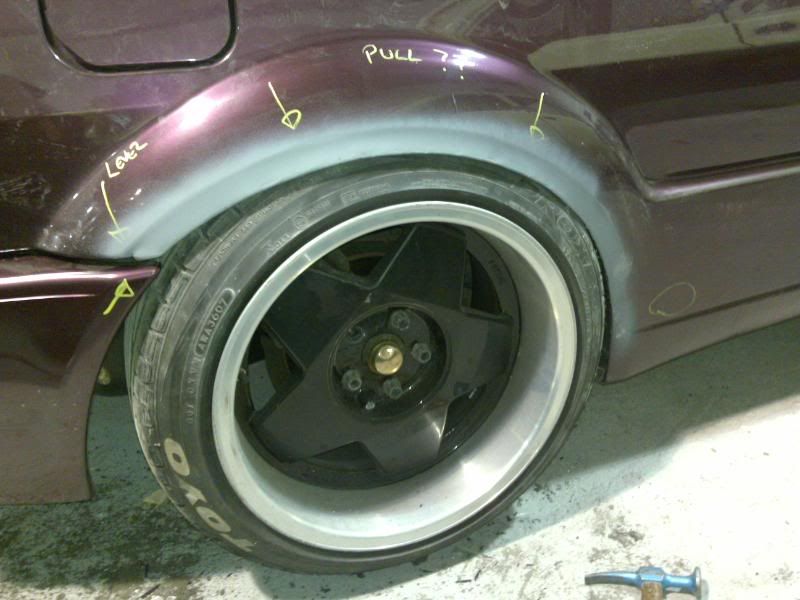

Furkz 0 Posted December 22, 2008 das golf said: well here is mine as you can see some subtle arch mods to cater for rims.... lol got to lower front next even more the only prob is im not sure on how we are getting it out of the shop???? are you sure this is not going to still rub? Quote Share this post Link to post Share on other sites

C488ADO 0 Posted December 23, 2008 Furkz said: are you sure this is not going to still rub? we had two people in the back and had sheets of sandpaper between the arch and the tyre bouncing up and down as much as we could and couldnt get it to rub anywhere .. it looks close and it is but its ok... i can always shave the hubs so no probs...... Quote Share this post Link to post Share on other sites
