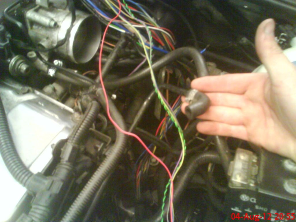

VW_OwneR_85 2 Posted August 4, 2012 (edited) What's the best approach for the pedal mounting? I have the bracket should I rivet, bolt or weld it? Near in mind there's fuel lines under there somewhere! Sent from my GT-I9100 using Tapatalk 2 Which pedal you got? i used a plate that bolts to the two bottom studs from the brake servo, but the pedal arm needed major surgery to work in this position , but imo was the best position for the pedal i got, still ironing out some running issues at the mo, this vac pipe, its prety obvious that it goes into the intake pipe after the maf , as the connection on the inlet pipe is right there for it, but is there anything missing? like a valve or anything? and what is this vac pipe from? cheers edit: just found out this is from the air shroud for the injectors, Edited August 6, 2012 by VW_OwneR_85 Quote Share this post Link to post Share on other sites
Fanjita 1 Posted August 5, 2012 (edited) I think thats for the secondary air injection mate? I know there's a solenoid at the front which I've deleted and that is part of the SAI system. I can only assume that is the hose for it! I've been fixing everything up today (made up a bracket for the ecu) and put it all back together. After I did the throttle pedal has stopped working! We had unplugged the pedal to work out the fitting of it (with the engine/ecu still powered mind you). It was revving fine before we started working on the ecu bracket and pedal location. Now I'm getting: 008487 - Accelerator Position Sensor 2 (G185): Signal too Low P2127 - 002 - Lower Limit Exceeded - MIL ON I've tried clearing it, leaving the ecu disconnected for a while, nothing. I can't seem to find an error for the first position sensor either! I'm wondering if it's a wiring fault, yet I checked the plug over the phone with mark only a few days ago... Which leaves the pedal, are throttle pedals likely to just go only a few days out of the packet? I'm completely stumped :/ Edited August 5, 2012 by Fanjita Quote Share this post Link to post Share on other sites

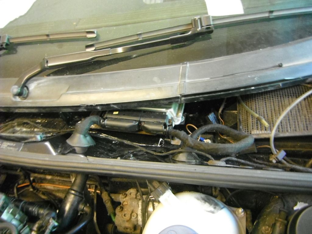

Kevin Bacon 5 Posted August 10, 2012 Pics as requested. I took these this morning on the phone, so they're a bit crap quality I'm afraid. I finished the wiring last night and started her up this morning before going to work. She fired up immediately and idled perfectly, which was a big feckin relief as I frickin hate wiring!! :D VAG-COM link to the ECU all perfect and it revs up fine, so no issues detected at present. Gonna hopefully get it all back together and tidied up over the weekend, then can take it for a spin! Unbelievably, the big 85mm MAF fits in the VR6 airbox with some very minor modification! :D I now have 85mm bore all the way from the box to the throttle, so may pick up a few more ponies over my previous setup. Quote Share this post Link to post Share on other sites

Fanjita 1 Posted August 10, 2012 No time on the weekend to drop by at all then Kev? I'm just doing the same with mine, last few odds and ends! Looks awesome though mate, I'm a bit lost on your ecu plug layout though, mine is routed along the engine side of the bulkhead then both plugs enter the original engine loom hole! I don't think I could route my loom the way you have done yours, unless I've used the wrong path!? ---------- Post added at 10:57 AM ---------- Previous post was at 10:55 AM ---------- Oh Baz, the guy who sold me that gear said there was some non standard map on the ECU, might give you a few ponies. Don't know any more than that but thought you'd like to know Quote Share this post Link to post Share on other sites
