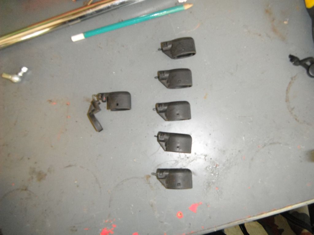

VW_OwneR_85 2 Posted August 31, 2012 (edited) do any of you guys have the red plastic covers on the wireing to each ignition coils? , mine are black and i want the red ones, by the looks of it there just clip on covers, if anyone has the red ones would you be so kind as to read the part number on the top of them and pm or post up the number ..thanks heres what i mean, wow just check out the price! i bet these from vw are actualy 1/8th of the price these guys are asking! http://www.ecstuning.com/Volkswagen-R32_MKV--3.2/Maintenance/View_All/ES261145/ Edited August 31, 2012 by VW_OwneR_85 Quote Share this post Link to post Share on other sites

Kevin Bacon 5 Posted September 7, 2012 VW_OwneR_85 said: yea im down with a swap, i have another spare engine loom with those black clips on ready to remove, pm me your address and i might be able to get them posted in the next couple of days, no rush for you though, Thanks ... Are your black ones level with the intake runners? i.e. 3 of them are angled differently like the red ones? If so, swapsies is a goer :D Quote Share this post Link to post Share on other sites
VW_OwneR_85 2 Posted September 7, 2012 (edited) i'll have a looksy, i know my coils sit at different angles and the height is determined by the height of the coil as i recently replaced a none vag coil for an oem coil and it sits slightly lower ,they sit prety much level but give or take 5mm or so , ill get a photo for this evening and ill let you decide but im fairly certain there be ok, had a good look, they all seem to be identical :( so with the red ones, theres three clips which are angled? all the black ones seem to have a slight angle but nothing major Edited September 7, 2012 by VW_OwneR_85 Quote Share this post Link to post Share on other sites
Kevin Bacon 5 Posted September 13, 2012 Cheers for that. Yeah yours are all the same angle and completely different to mine! I think mine might be Audi ones but 3 of them are angled differently to make sure all 6 sit flush with the intake runners. I think yours might look a bit odd on my engine tbh, so I'll hang onto them for now! Thanks anyway :D Quote Share this post Link to post Share on other sites
VW_OwneR_85 2 Posted September 13, 2012 sound no worrys, does any of the 3 you have look like they would work with mine? if so which part number ? 3 x 022 971 921 B 3 x 022 971 921 C cheers... Quote Share this post Link to post Share on other sites
1990 0 Posted September 13, 2012 3 of Kev's will point slightly up and 3 will point slightly down. I think they would be OK on yours. Do you use the Club GTI forum? A guy called Justin (Mushy16v) might have some, I sold him my mk5 loom. Quote Share this post Link to post Share on other sites
