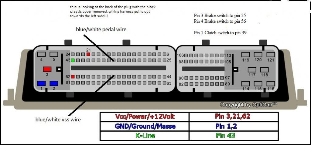

J.C 10 Posted June 29, 2013 VW_OwneR_85 said: yea your need to connect the blue/white vss wire from pin 54 up and then it will lift the rev limit, just make sure its not the blue/white pedal wire which is directly above it ;) . I've reconnected the cut wire already, maybe the rev limiter is a general safe mode setting, which is applied when any one or more of a number of faults occur and not a specific outcome of a particular fault/problem Quote Share this post Link to post Share on other sites
VW_OwneR_85 2 Posted June 30, 2013 (edited) J.C said: I've reconnected the cut wire already, maybe the rev limiter is a general safe mode setting, which is applied when any one or more of a number of faults occur and not a specific outcome of a particular fault/problem where exactly have you reconnected this wire to? back to the same wire that 20vtvw originally snipped? also pretty sure the 2.8 24v don't have safe mode.. Edited June 30, 2013 by VW_OwneR_85 Quote Share this post Link to post Share on other sites
J.C 10 Posted June 30, 2013 VW_OwneR_85 said: where exactly have you reconnected this wire to? back to the same wire that 20vtvw originally snipped? also pretty sure the 2.8 24v don't have safe mode.. I just reloined where Russ (20vtvw) cut it to be honest, I'm a bit dissapointed with the 24v conversion, I'm thinking of putting new mounts in to get less vibration, running the intake ducting, then shipping it off to DGautotech (or similar) and get them to sort out the overheating oil, poss flap malfunctoon, flat spots, refit my `vr6 box with a TDI 5th gear, OR source and put a good VR6 12v back in Plug and play (with)LOL, my arse!!! sorry, rant over ---------- Post added at 7:07 PM ---------- Previous post was at 7:00 PM ---------- VW_OwneR_85 said: where exactly have you reconnected this wire to? back to the same wire that 20vtvw originally snipped? also pretty sure the 2.8 24v don't have safe mode.. I just reloined where Russ (20vtvw) cut it to be honest, I'm a bit dissapointed with the 24v conversion, I'm thinking of putting new mounts in to get less vibration, running the intake ducting, then shipping it off to DGautotech (or similar) and get them to sort out the overheating oil, poss flap malfunctoon, flat spots, refit my `vr6 box with a TDI 5th gear, OR source and put a good VR6 12v back in Plug and play (with)LOL, my arse!!! sorry, rant over Quote Share this post Link to post Share on other sites

taks 10 Posted July 1, 2013 Also make sure the clutch and brake pedal are wired in. It was a common thought that just 12v them was a way to tell the ecu that the were disengaged (which is true) but those particular parameters have a timer on so when the ECU detects no change in either clutch or brake for x amount of time it goes retard (feeling flat) then starts the timer again. I am in contact with a highly regarded ECU engineer who is going to map this out for me eventually but a quick fix of setting this time to infinity did not work. He is on the case though so I will update. ---------- Post added at 4:09 PM ---------- Previous post was at 4:03 PM ---------- Dear VR Owner 85 Can you add to your diagram: Pin 3 Brake switch to pin 55 Pin 4 Brake switch to pin 56 Pin 1 Clutch switch to pin 39 Might help people out Thanks Quote Share this post Link to post Share on other sites
VW_OwneR_85 2 Posted July 1, 2013 (edited) taks said: Also make sure the clutch and brake pedal are wired in. It was a common thought that just 12v them was a way to tell the ecu that the were disengaged (which is true) but those particular parameters have a timer on so when the ECU detects no change in either clutch or brake for x amount of time it goes retard (feeling flat) then starts the timer again. I am in contact with a highly regarded ECU engineer who is going to map this out for me eventually but a quick fix of setting this time to infinity did not work. He is on the case though so I will update. ---------- Post added at 4:09 PM ---------- Previous post was at 4:03 PM ---------- Dear VR Owner 85 Can you add to your diagram: Pin 3 Brake switch to pin 55 Pin 4 Brake switch to pin 56 Pin 1 Clutch switch to pin 39 Might help people out Thanks yea that's cool , my BDE doesn't have any of that wired up though, do you need the brake switch etc wired in on the 3.2's? p.s its the 3rd day running with my re routed pedal wires and re connected vss signal to w-1 and all is 100% ;) Edited July 1, 2013 by VW_OwneR_85 Quote Share this post Link to post Share on other sites
taks 10 Posted July 1, 2013 VW_OwneR_85 said: yea that's cool , my BDE doesn't have any of that wired up though, do you need the brake switch etc wired in on the 3.2's? p.s its the 3rd day running with my re routed pedal wires and re connected vss signal to w-1 and all is 100% ;) Wicked!! I got a feeling the BDE is looking for the clutch and brake switch. When changing gears at hi RPM do the revs momentarily hang on then it slightly over revs? Get VAG com and check: Clutch switch operation: Block 66 Engaged :100 Brake switch operation: Block 66 Engaged:011 If disengaged there will be a block of 0's Going through my pics on my phone: brake switch pin3 to ecu is white/yellow (pin 55) brake witch pin 4 to ecu is red/black (pin 56) Clutch switch pin 1 to ecu is white/red (pin 39) Actually I am certain it does. I took the plugs out of 4motion at the scrap yard Quote Share this post Link to post Share on other sites
VW_OwneR_85 2 Posted July 1, 2013 (edited) taks said: Wicked!! I got a feeling the BDE is looking for the clutch and brake switch. When changing gears at hi RPM do the revs momentarily hang on then it slightly over revs? Get VAG com and check: Clutch switch operation: Block 66 Engaged :100 Brake switch operation: Block 66 Engaged:011 If disengaged there will be a block of 0's Going through my pics on my phone: brake switch pin3 to ecu is white/yellow (pin 55) brake witch pin 4 to ecu is red/black (pin 56) Clutch switch pin 1 to ecu is white/red (pin 39) Actually I am certain it does. I took the plugs out of 4motion at the scrap yard no not that I know of, like I say the engines running sweat , but due to our roads in Guernsey I cannot drive it like I stole it , I value my license , our max limit sadly is 35mph!! so I cant really give it a proper drive but the engine pulls very strong from 1st 2nd and 3rd!! and gives me no indication that anything else is wrong, I will check in vcds but not really sure what im looking for , does the engine need to be running ? so basically I might have to hook up a mk4 clutch switch and mk4 brake switch and wire them as above? also if there was a problem with the lack of either clutch or brake switch wouldn't it log faults for these? Edited July 1, 2013 by VW_OwneR_85 Quote Share this post Link to post Share on other sites
J.C 10 Posted July 1, 2013 taks said: Wicked!! I got a feeling the BDE is looking for the clutch and brake switch. When changing gears at hi RPM do the revs momentarily hang on then it slightly over revs? Get VAG com and check: Clutch switch operation: Block 66 Engaged :100 Brake switch operation: Block 66 Engaged:011 If disengaged there will be a block of 0's Going through my pics on my phone: brake switch pin3 to ecu is white/yellow (pin 55) brake witch pin 4 to ecu is red/black (pin 56) Clutch switch pin 1 to ecu is white/red (pin 39) Actually I am certain it does. I took the plugs out of 4motion at the scrap yard Would this apply to the AUE engine as well, I've got VCDS lite and lead, But can't seem to get it to communicate with the controller, it was the same with my MK3 golf VR6, worked for a few months then packed up, I think I might have to invest in the paid version, but I use a Mac so will need Boot Camp sorting out first Does VCDS lite have a time limit? Quote Share this post Link to post Share on other sites

J.C 10 Posted July 2, 2013 Regarding the VSS and Accelerator pedal wires The confusion comes with the reading of the colours of the wire(s) The pedal wire is white/blue the VSS wire is Blue/white the first colour being the main (thick stripe)colour and the second colour being the stripe(thin stripe) and yes 20vtvw did cut the pedal wire, will sort the rev limit out but first VCDS then engine mounts Quote Share this post Link to post Share on other sites

Kevin Bacon 5 Posted July 2, 2013 VW_OwneR_85 said: do you need the brake switch etc wired in on the 3.2's? The ECU needs to see the brake pedal switch to disengage the Haldex but I don't know what your ECU man did to code this out. I believe the ME7 is as simple as changing a byte to tell it has the function or not, but in many cases the ECU still needs to 'see' a respective relay (across the trigger side) for the function or it doesn't like it. For instance, if you don't have the SAI relay connected, you don't get any long term lambda trims. 3.2s also need things like chassis angle sensors (Xenon alignment) and steering wheel angle (ESP) coding out. Quote Share this post Link to post Share on other sites
