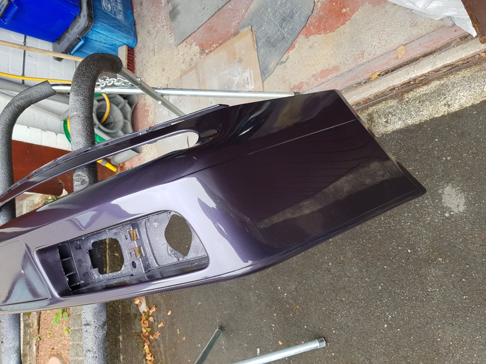

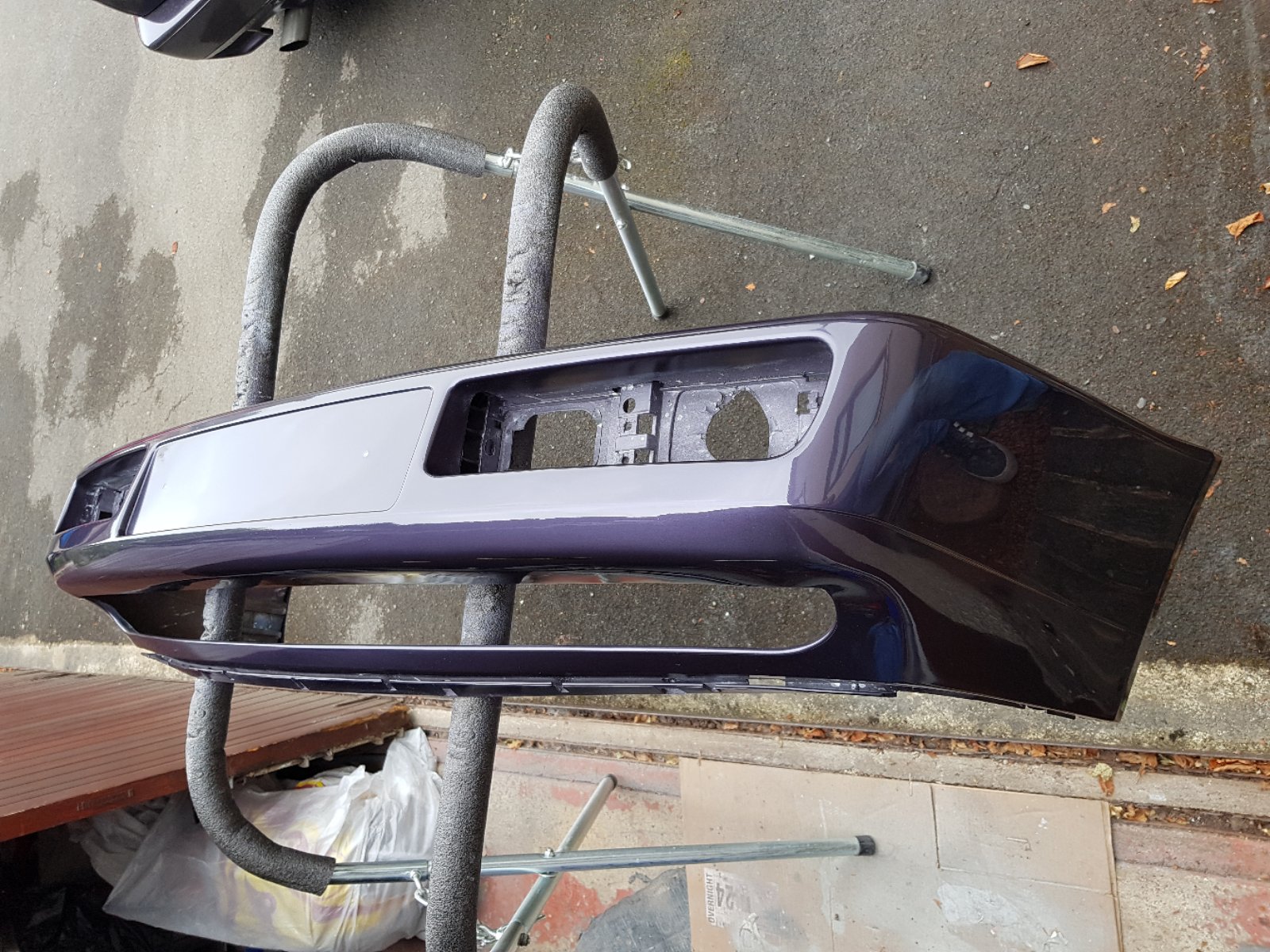

Had a go at spraying practised on the wife's bumpers as they had a few scrapes from before I bought it think they turned out ok so now stripping everything else from the bay on mine to start it's respray gpj47k36.jpgof8dmy4h.jpg9fs3yr98.jpgf3iy2yri.jpg
They look slightly more purple than the original paint don't know if this is due to the original paints age or who I got the paint from either way they look 100 times better than before

Tell you what - if you’ve not done much spraying before, well done that’s a good looking result
Cheers fla mines going to be a bit less oe looking than Giles when it's done
Cheers quite chuffed with how it's turned out and only used cans before to spray small parts first real time with a compressor and gun
Top job, I wish my spraying would come out like that instead of needing hours of flatting
Cheers these pics are after a good flat and polish though, think orange peel is inevitable with a home respray I'm not looking forward to doing it on my full car once it's done!

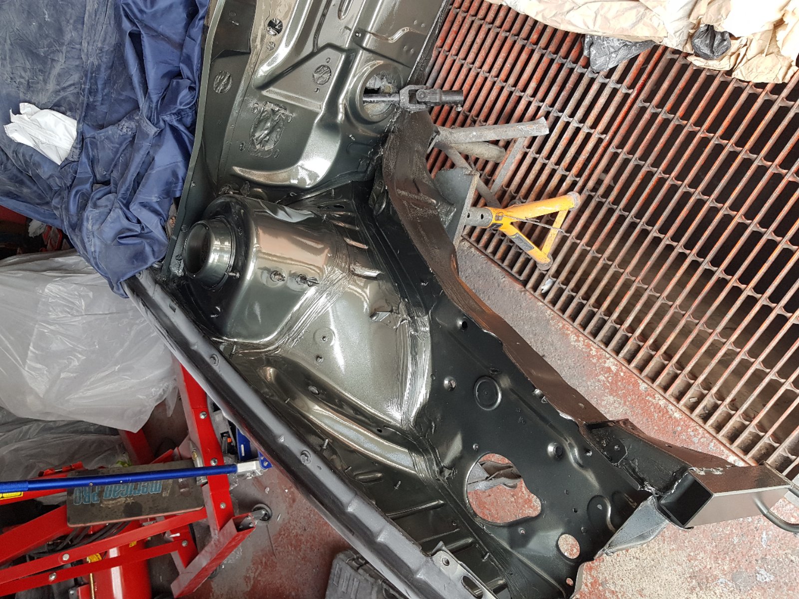

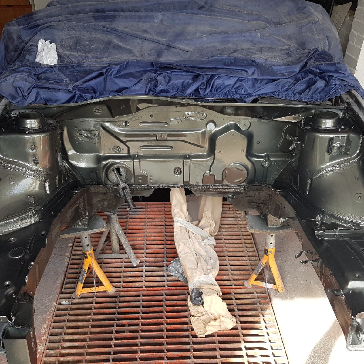

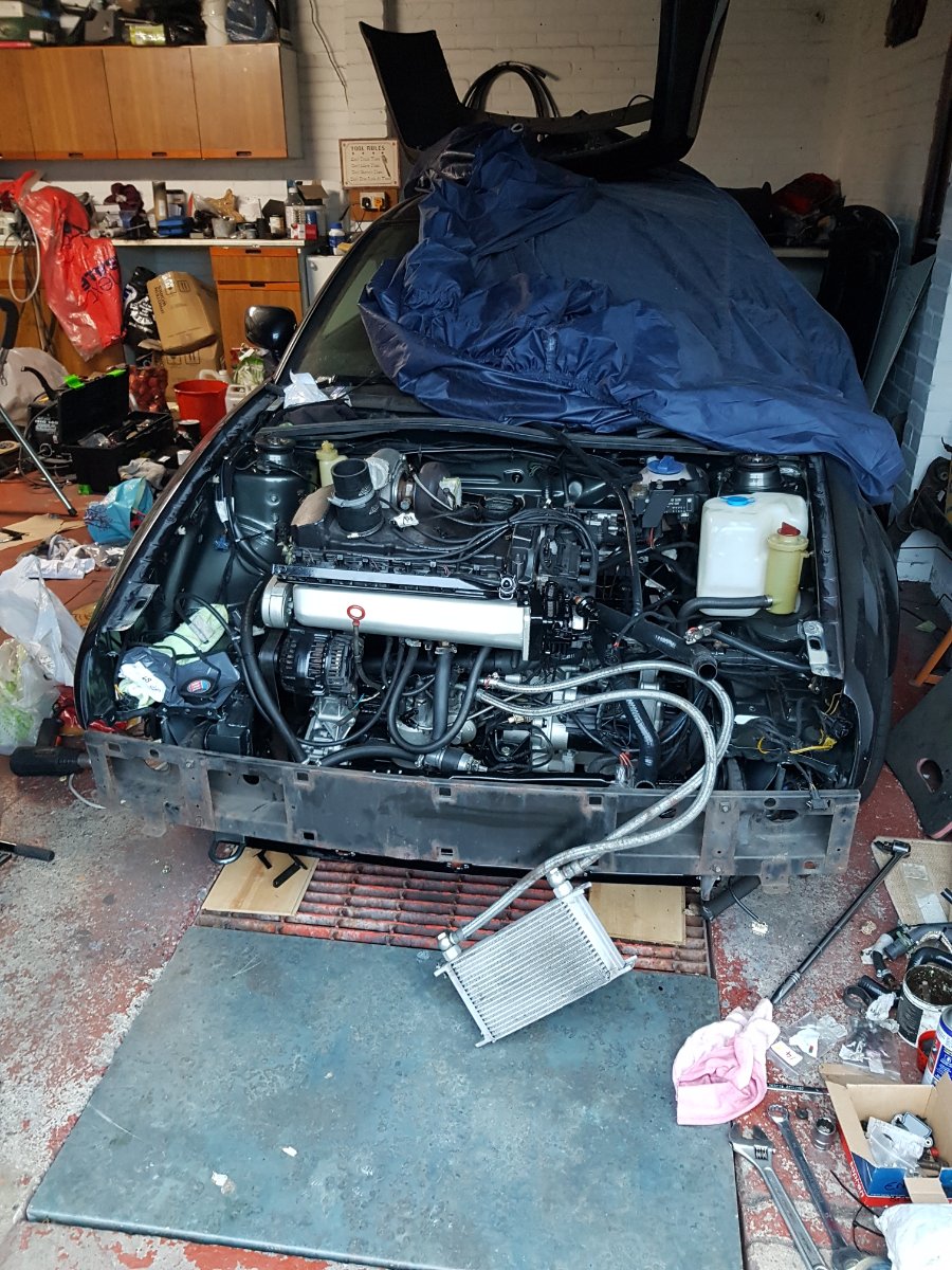

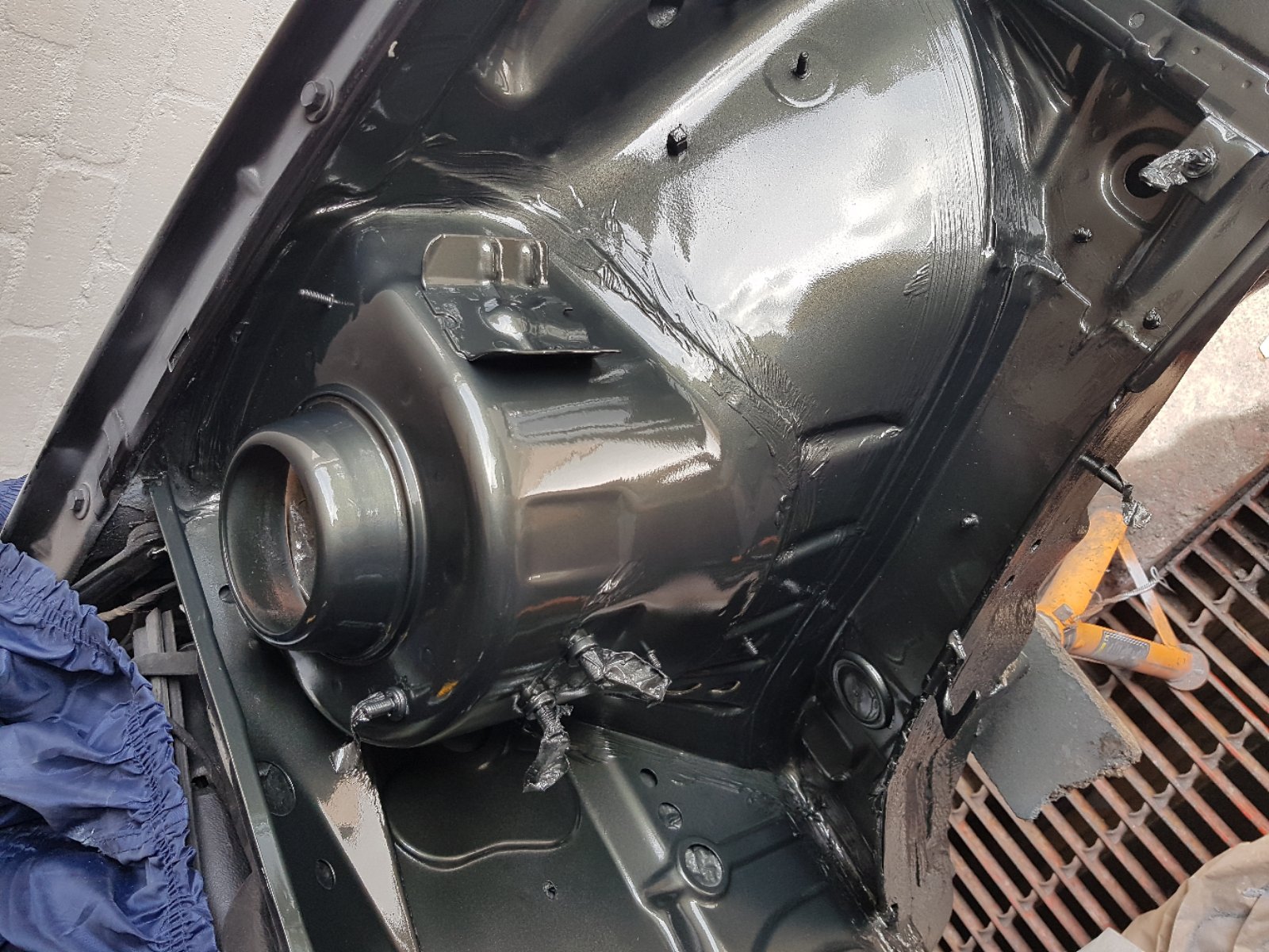

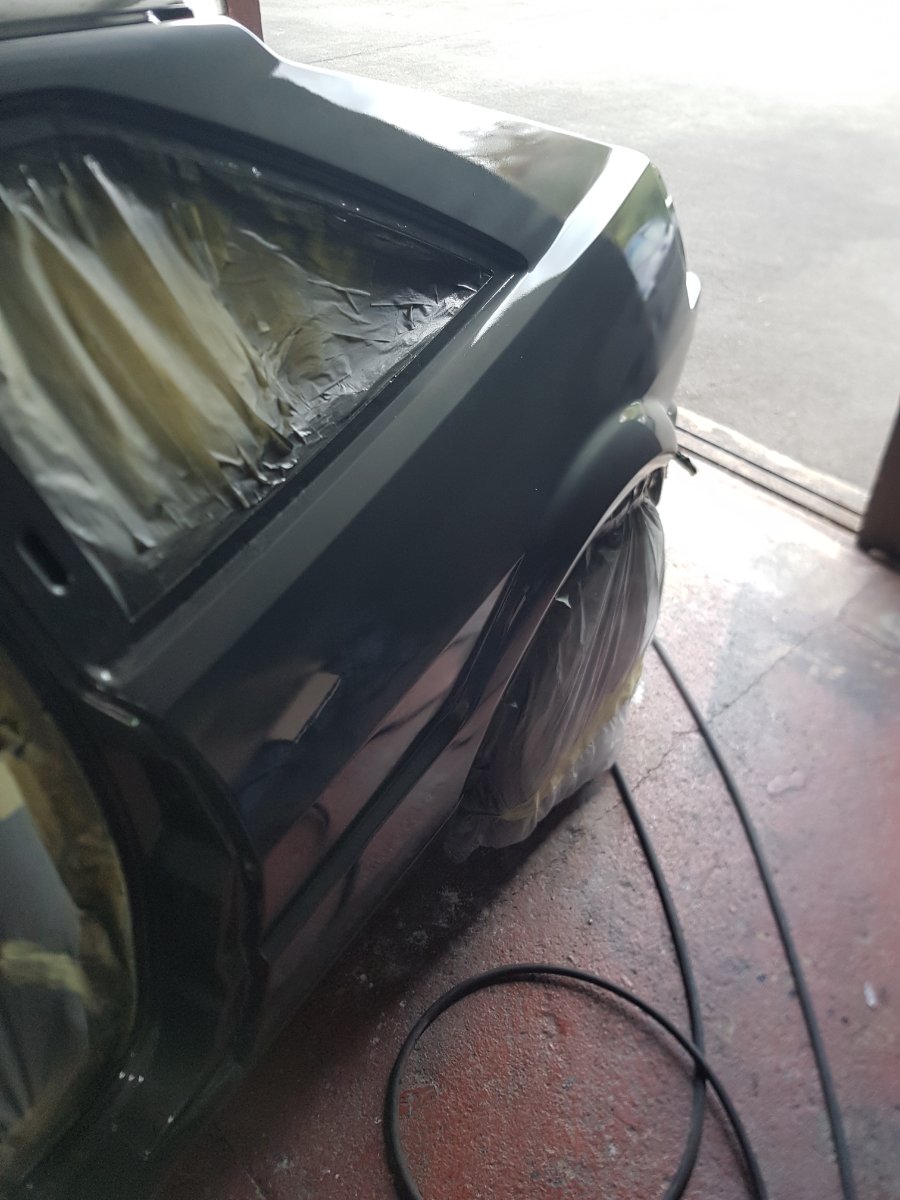

So been busy stripping the bay in mine getting ready for paint getting the old wax off was a nightmare but it had done it's job as there was only a couple of bits of surface rust
Prepping before paint seems to have taken a age and hammered my fingers as all the books and crannys needed to be sanded by hand and last thing I want is to put the motor back in and it all start flaking off/ crazing
I've ended up going for khaki green pearl and I'm well happy with that choice now the first bit of paint is down this is straight out of the gun still needs a polish and sorry for sideways pics the app I'm using to upload pics seems to do this sometimes

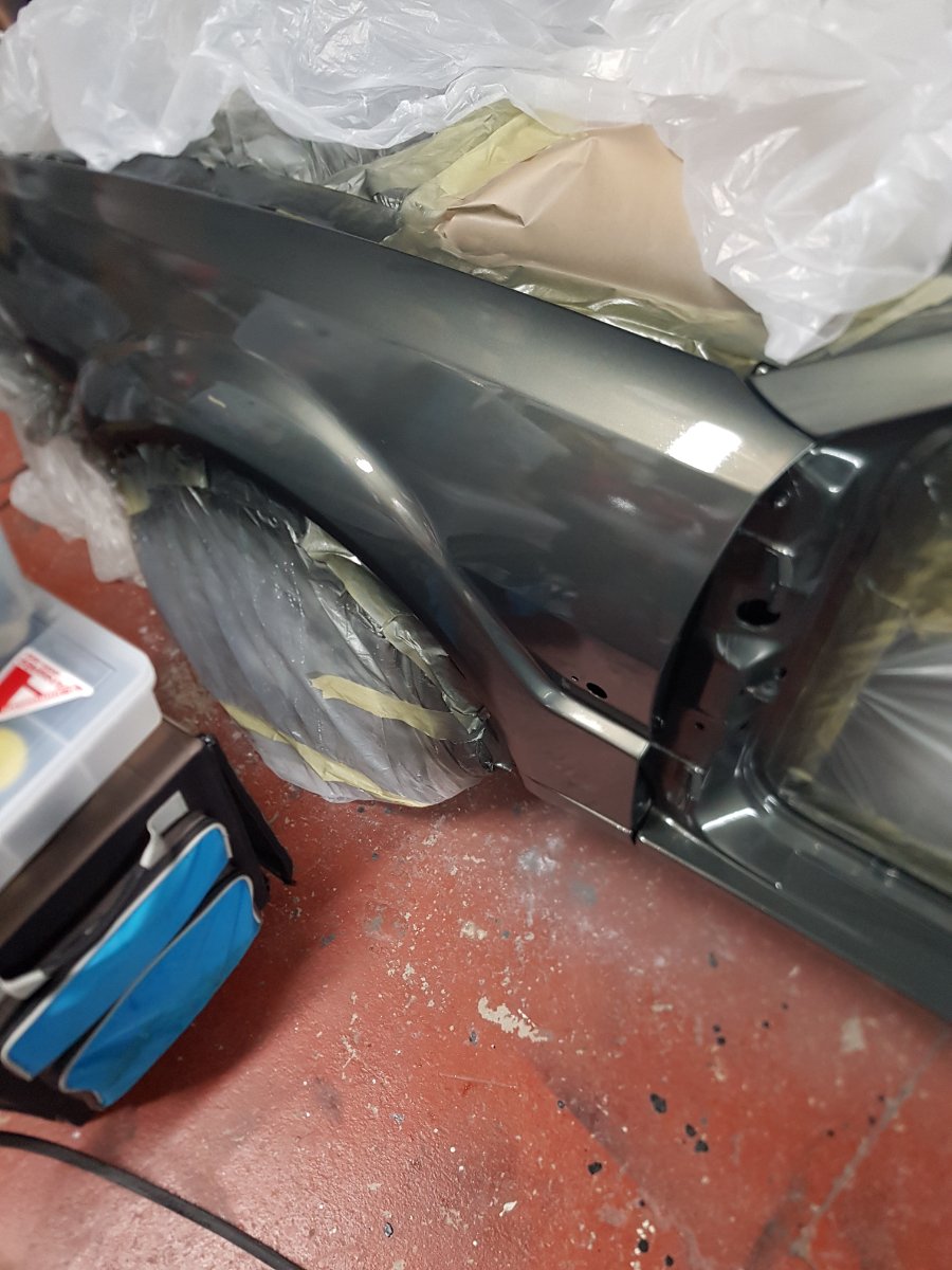

Finally made some visible progress on this today after spending time repairing some rust at the bottom of the a pillars making the bottom of one of the front wings in fresh metal as had gone crusty

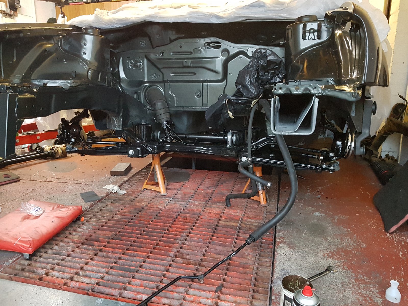

Also rewrapped the loom in oe tesa tape made new brake lines and sprayed all brackets master cylinder servo etc with chassis black

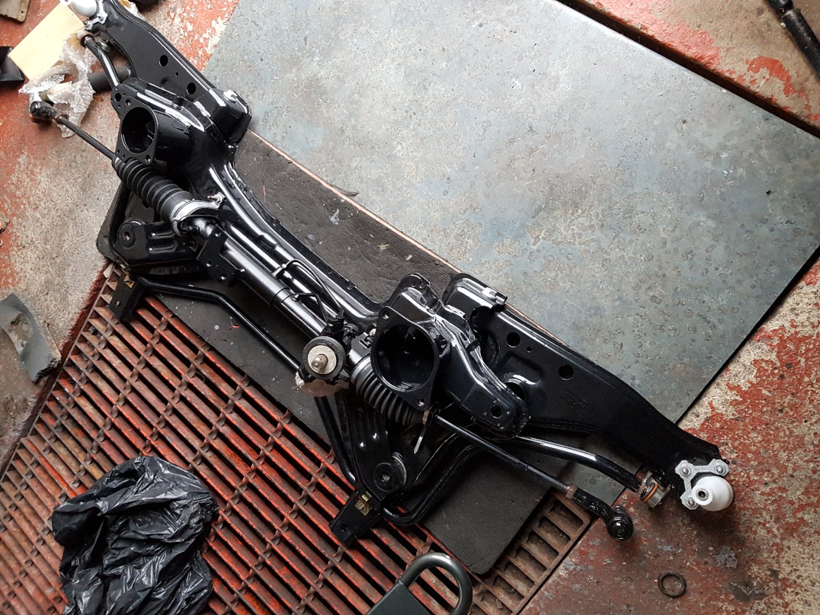

Made up the front running gear and fitted to the car all new oem bolts used r32 rear Bush's all others oem, ball joints drop links all new oem
Hope fully get cracking on with it again now

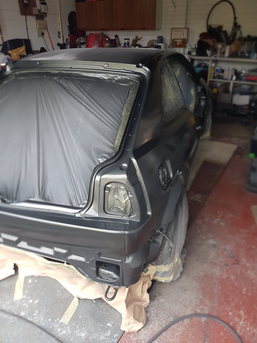

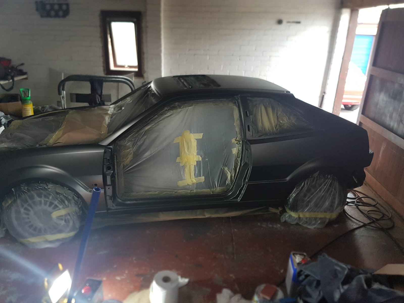

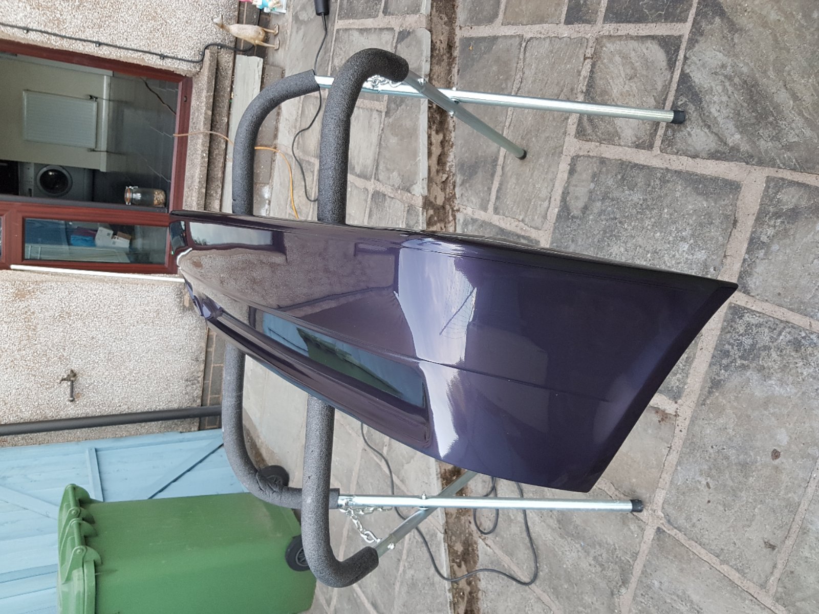

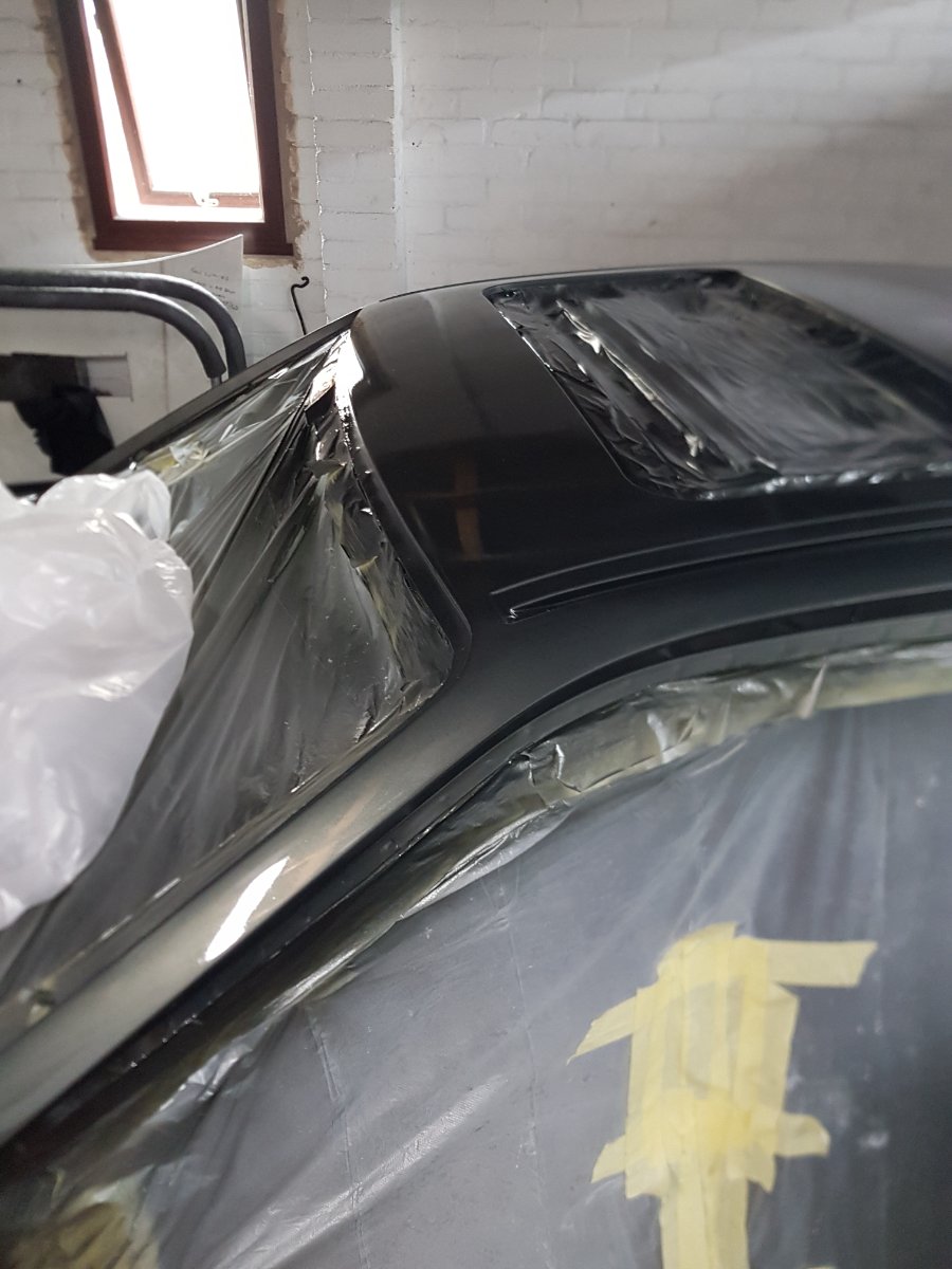

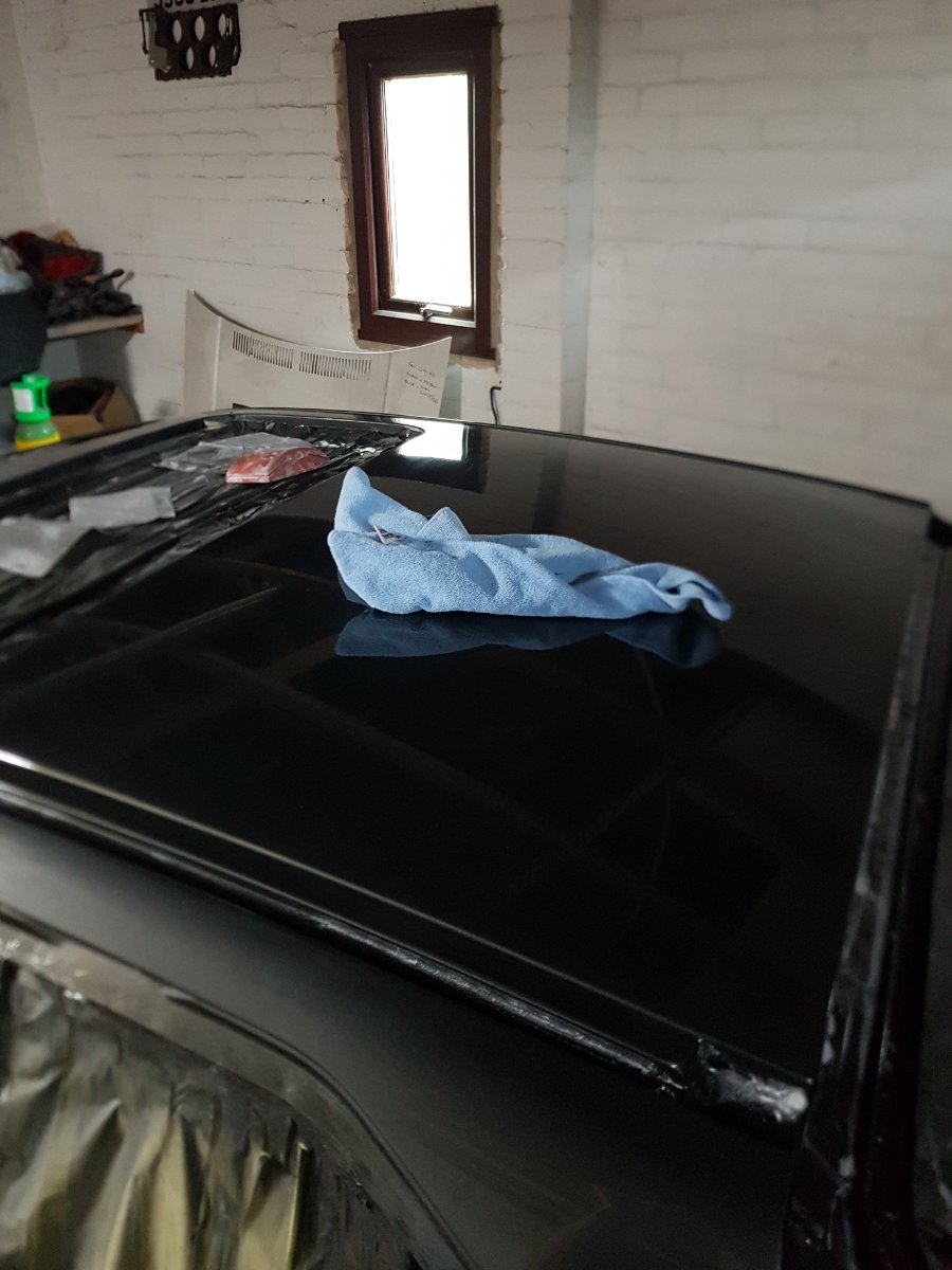

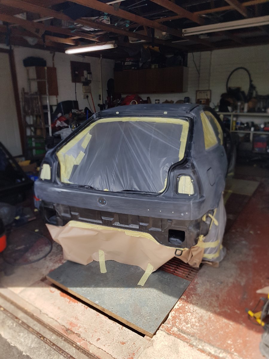

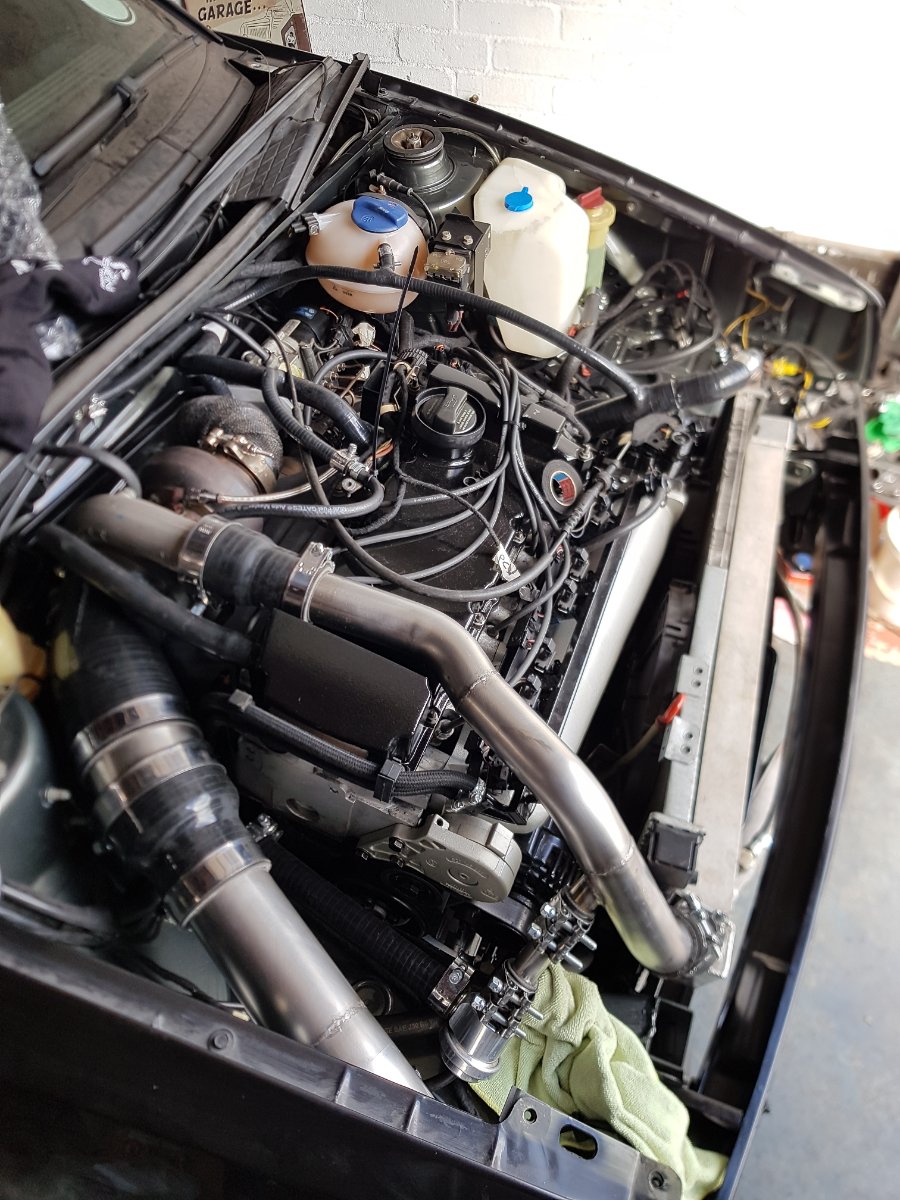

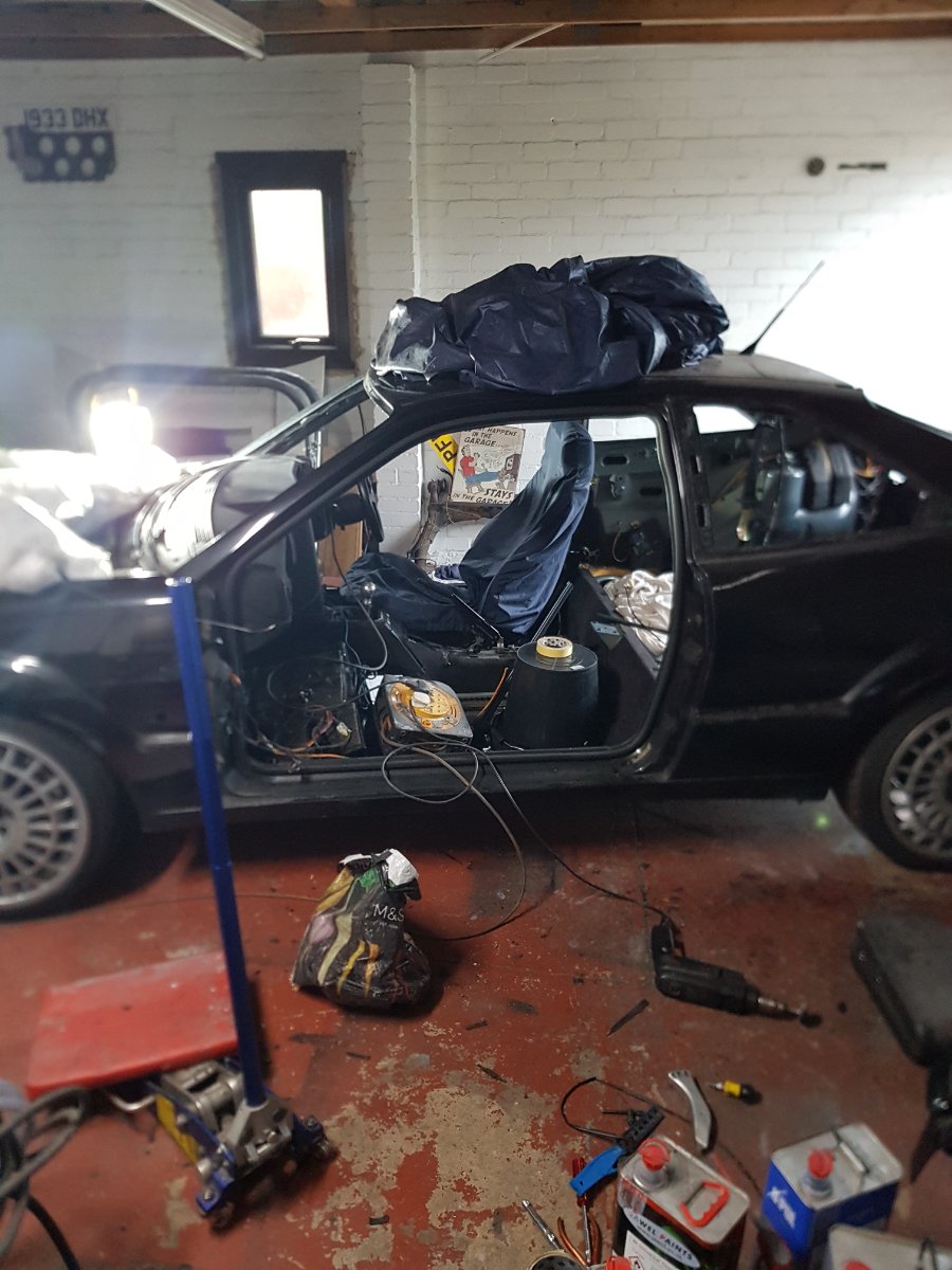

So not posted for a bit but been busy with the car still got engine back in with everything painted brackets abs unit etc etc rewrapped the loom new brake lines

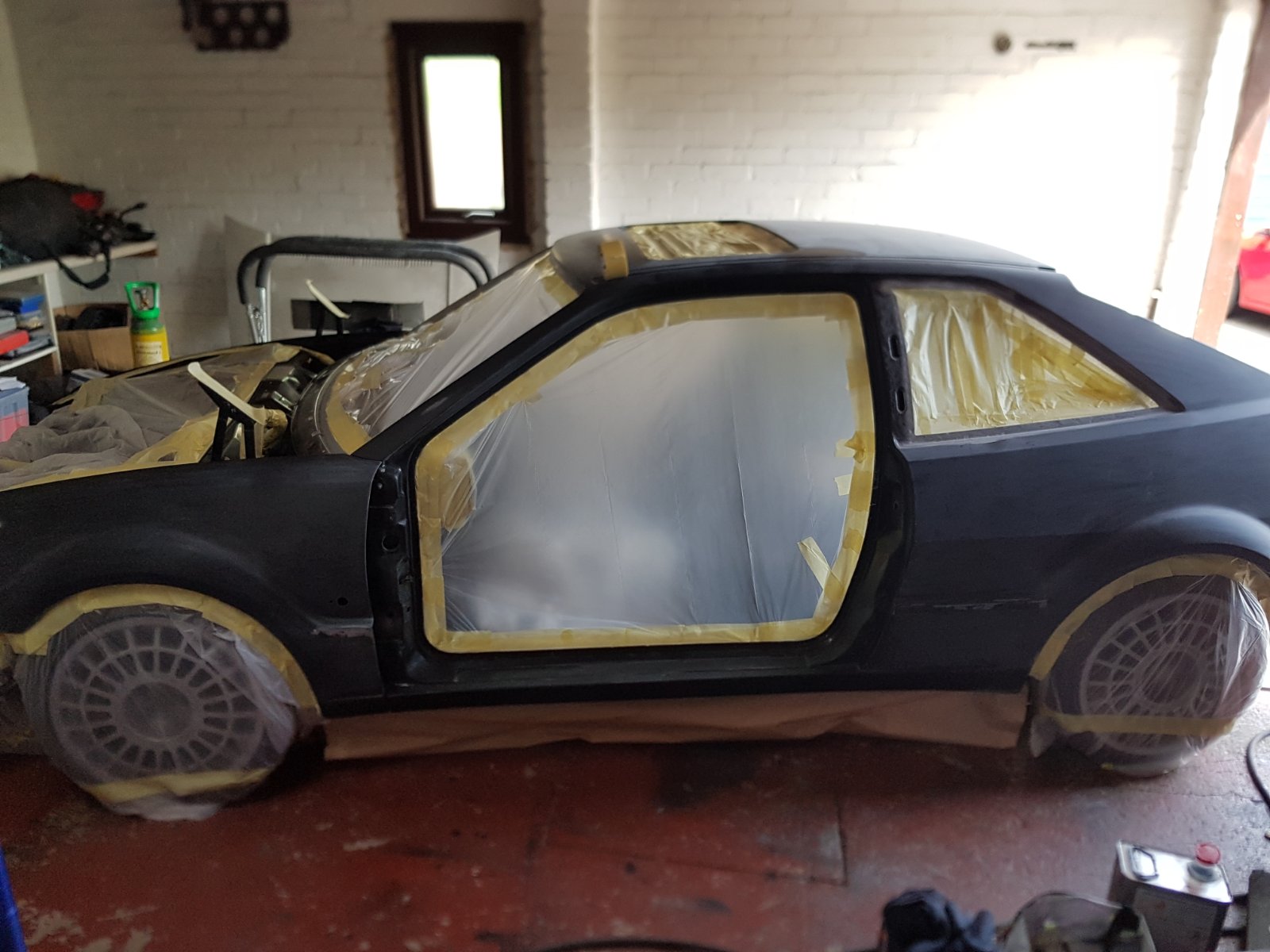

Then I have been on with painting the rest of the car got stuck on the main body of it as kept getting reactions in the paint but I'm getting there now just the boot doors and bumpers left to do and reassemble then back on the road easy peasy lol hopefully get some use before they start salting the roads
yyj6jc8t.jpg9lgq3k8a.jpgdlrrlquu.jpg22s4ic3e.jpg5tidq4wa.jpguyq9d4fw.jpgrgyl7ijf.jpgjbdq6228.jpg6gzsvjf2.jpg93ok2if8.jpg2qw5nn5u.jpg
Only on the last picture I have flatted the clear coat and once over with polisher other pics are in basecoat or before cutting and polishing
Cheers and a app called direct upload image sharer, you go to the gallery on your phone share the image with the app then select forum bb code image and it puts the img code on your clipboard you then just select them to post, I'm sure I have made it sound harder than it actually is
