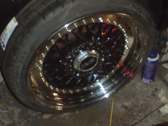

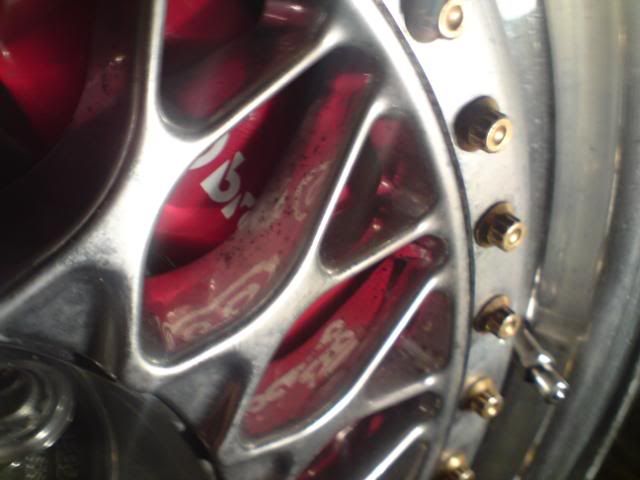

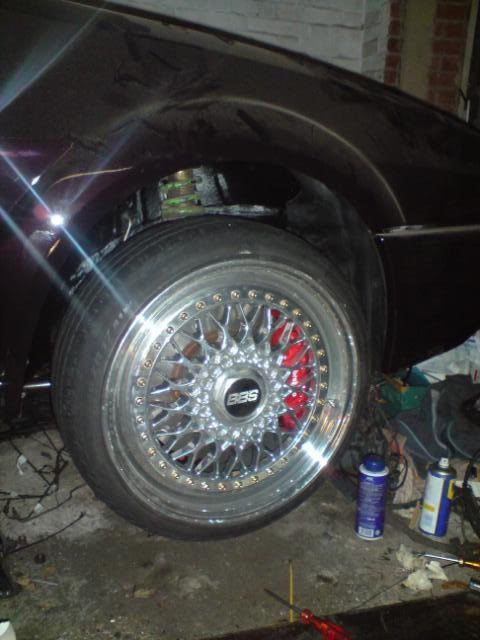

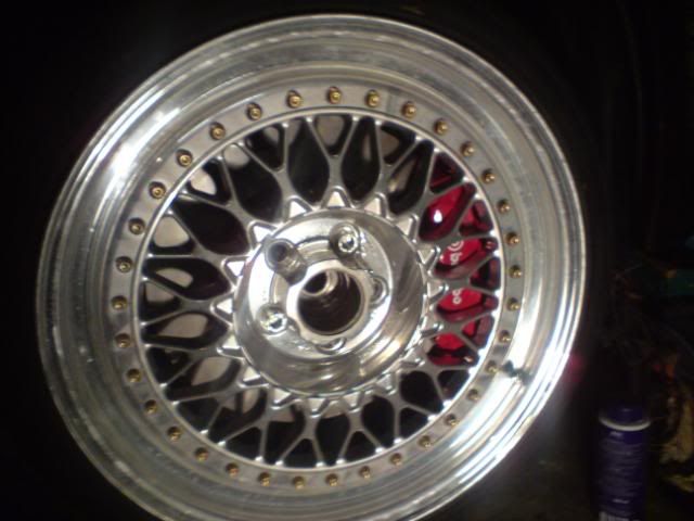

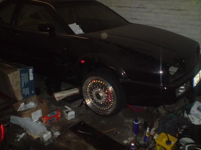

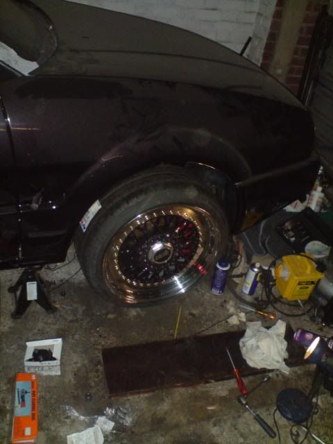

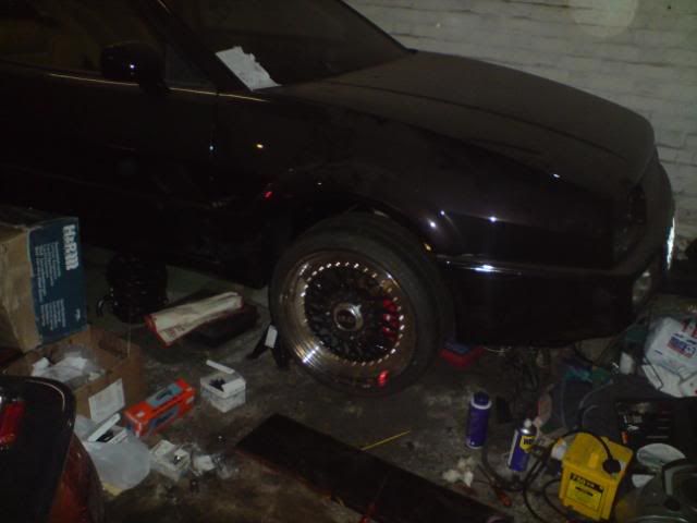

G60SC_Stoney 0 Posted November 6, 2008 *******UPDATE!!!!******* right ive been spending a lot of time getting this car sorted and im nearly there. (sort of!) so far, since the last update i have: - removed everything from underneath the car (fuel tank, brake lines/fuel lines everything!) -undersealed the underside and all the wheelarches with 2 coats of greystripe sealant and 2 coats of waxoyl underseal - completly refurbed the rear beam fitting new bushes, stub axles, H+R anti roll bar new brake lines -got a VR6 front subframe and got that blasted and painted -fitted new wishbones and polybushes all round -Fitted the front H+R anti roll bar--bit of a monster in comparison to the old one! -refurbed the steering rack with all new components -fitted the front subframe and all components back together -fitted my Brembo 4 pots with 305mm disks and braided lines all round -fitted new solid brake pipes throughout the car -cleaned and painted all the heatshields with VHT paint -polished up the stainless exhaust -fitted new exhaust mounts and all i have pictures of at the moment is the front wheels with the BBS RS's trial fitted!! :? its a bit hard to take pictures of underneath the car when its only on the axle stands its been on for the last 8 months! but ill try and take some later. In the meantime, here are some i made earlier....! with the polished BBS 301's which are sold to fund my R32 engine.... :( it does look very nice with them on! and with my colour coded 301's with wider dishes the fitting is VERY tight between the wheels and the caliper theres about 2mm clearance between them :cheers: and yes everything is thick with dust, but it hasnt been moved since January!! just going to have a quick bite to eat then im off to fit some more bits!!! Getting there slowly, but im safe in the knowledge that everything on the car, and i mean everything, every nut and bolt,washer plastic clip is genuine vag and 99% of it is brand spanking new! I Think ive spent about £5,000 on new bits from VW since the project got into my garage. and the parts that couldnt be bought new, due to the being discontinued or unavailable for some reason are well unto the job, and are not worn in the slightest. Its probably in better nick than when it came off the production line nearly 18 years ago! Quote Share this post Link to post Share on other sites

zak 0 Posted November 6, 2008 im guessing your running some kind of 4 to 5 stud adapter which gives you enough space to get brembos to fit behind your rs's? Quote Share this post Link to post Share on other sites
Toad 0 Posted November 6, 2008 I dunno if he's changed to full VR setup now, but he did have 5 stud hubs to fit into the 4 stud bearing carriers before. Quote Share this post Link to post Share on other sites
zak 0 Posted November 6, 2008 i think they must be 4 stud hubs still as i just realised it mentions in the last post hes fitted 305mm discs which are 4 stud. Quote Share this post Link to post Share on other sites
carpoid 0 Posted November 6, 2008 I'd be interested to know how you've done it too, maybe 5 stud hubs and redrilled disks ?? Quote Share this post Link to post Share on other sites
G60SC_Stoney 0 Posted November 6, 2008 he did have 5 stud hubs to fit into the 4 stud bearing carriers before. and thats what im using! luckily the disks were drilled to 5x100 from being 4x100, which was a bit of a result! i couldnt use the adapters in the end as they made the wheels stick out way beyond the arches, so by using a 5x100 hub in a g60 carrier it saved me 20mm and put the wheels back in a more sensible position... :clap: Quote Share this post Link to post Share on other sites
zak 0 Posted November 6, 2008 so the brembos were a straight fit nehind your rs's? if so can you take a picture of the back of your rs's for me when you get a chance. Quote Share this post Link to post Share on other sites
