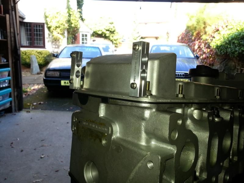

Kevin Bacon 5 Posted October 8, 2014 My first blunder in VR6 land was not checking the intermediate sprocket when I fitted some cams. It ran like cr@p afterwards :lol: It took me a while to get my head around the Mr intermediate as well. It's easy to check. Using a telescopic dental mirror and a torch, you can see the intermediate timing marks after taking the rocker cover off. Quote Share this post Link to post Share on other sites

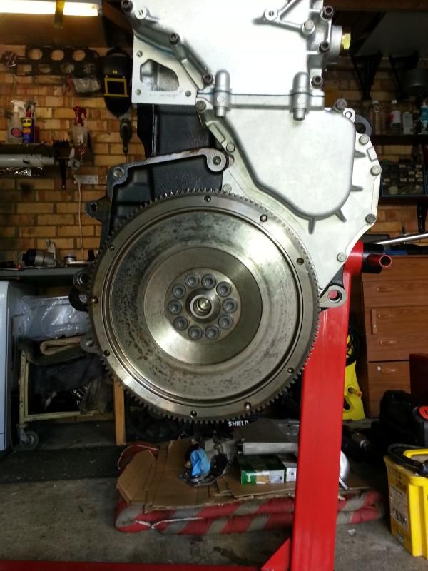

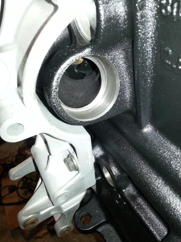

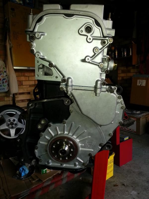

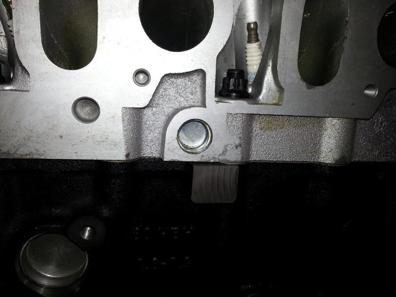

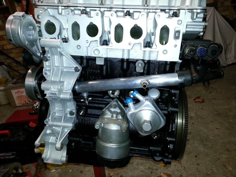

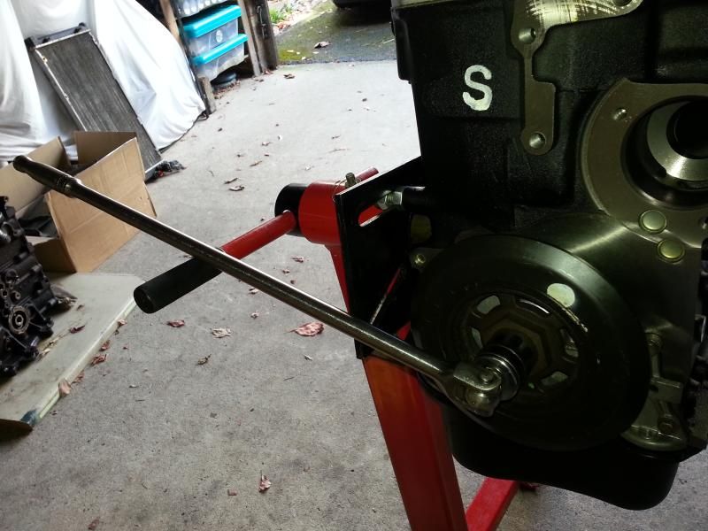

Jim Bowen 1 Posted October 9, 2014 Fitted the timing and cam cover(had all these aqua blasted, pretty pleased with the results. Fitted the Gruvenparts fuel hose clips Had to fit a 19mm core plug into the head, as its a US spec head and has this hole for the secondary air intake. Then fitted the flywheel, Used new bolts this time! My crank locking device :lol: works well. Quote Share this post Link to post Share on other sites
robrado974 1 Posted October 9, 2014 The VR is a big lump , but that looks huge sat there ! Quote Share this post Link to post Share on other sites

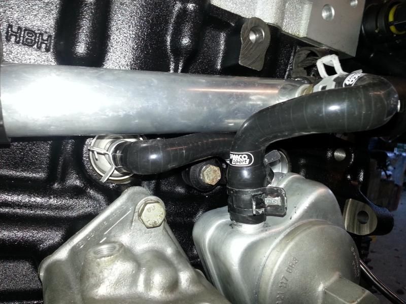

Jim Bowen 1 Posted October 13, 2014 Few more bits done, although most bits just trail fitted before i fit them properly. Have worked out all the hose clip sizes as well, i will make a new thread for them. Fitted the gruvenparts crack pipe, clean the hole of any corrosion, no problem here :lol: Just chucking the parts on now really. Quote Share this post Link to post Share on other sites
Dox 26 Posted October 13, 2014 Looks great :) Have you considered a lightened flywheel? Quote Share this post Link to post Share on other sites
Jim Bowen 1 Posted October 13, 2014 I did do, but decided to stick to the original instead, is there much benefit? If I did buy one now do I need to get it balanced or anything like that? Quote Share this post Link to post Share on other sites
Dox 26 Posted October 13, 2014 Jim Bowen said: I did do, but decided to stick to the original instead, is there much benefit? If I did buy one now do I need to get it balanced or anything like that? I've got one on the shelf ready for when I swap engines over, done by hotgolf on CGTI (I just put a wanted ad on there), I think its 3KG lighter, but the weight is removed from the outer edges of the wheel where it has most effect. It should rev quicker, the downside is it should be a little lumpier and easier to stall - not a big deal for low mileage use Quote Share this post Link to post Share on other sites
Kevin Bacon 5 Posted October 13, 2014 I noticed bugger all difference when I fitted a 9lb cromoly flywheel (half stock weight), and I had the shorter 3.68 final drive. I think it's one of those parts people rave about but the reality is they offer very little to the driving experience. Quote Share this post Link to post Share on other sites

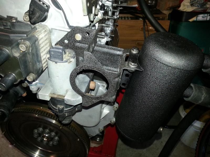

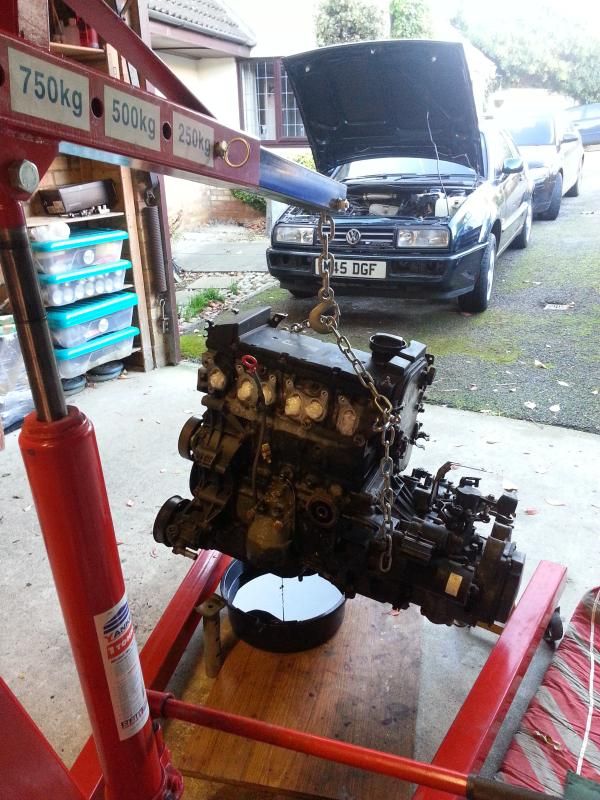

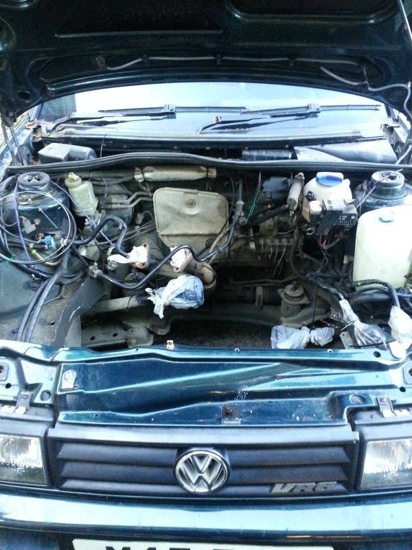

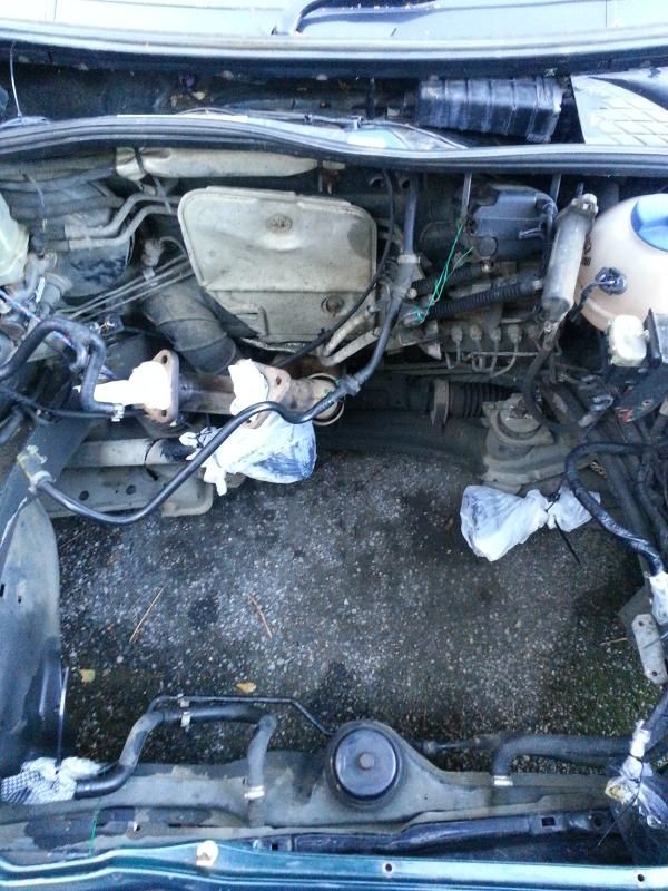

Jim Bowen 1 Posted October 27, 2014 Fitted the oil catch can, pipework is rather chunky but i'll see how i can improve that once in the car. Gruvenparts aux water pump bracket, had it years so looking a bit old now. Going back to the spring type clips instead of jubilee clips. Also got old engine out on saturday morning Engine bay is a bit dirty but not really rusty, not sure i will spend ages cleaning it all up to spotlessly clean. Probably just give it a quick wipe. Quote Share this post Link to post Share on other sites

robrado974 1 Posted November 10, 2014 Coming on well Jim , I would re rap any old wiring while you can get to it easily . Edit . I would have thought the six branch would be a good gain ? if the gases are escaping quicker its going to give you more power . Quote Share this post Link to post Share on other sites
Jim Bowen 1 Posted November 10, 2014 I thought about getting that plastic conduit stuff for the wiring. Noticed my audi has it. Quote Share this post Link to post Share on other sites
