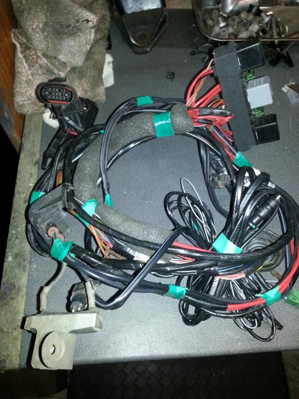

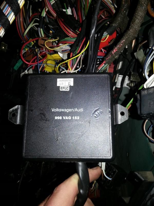

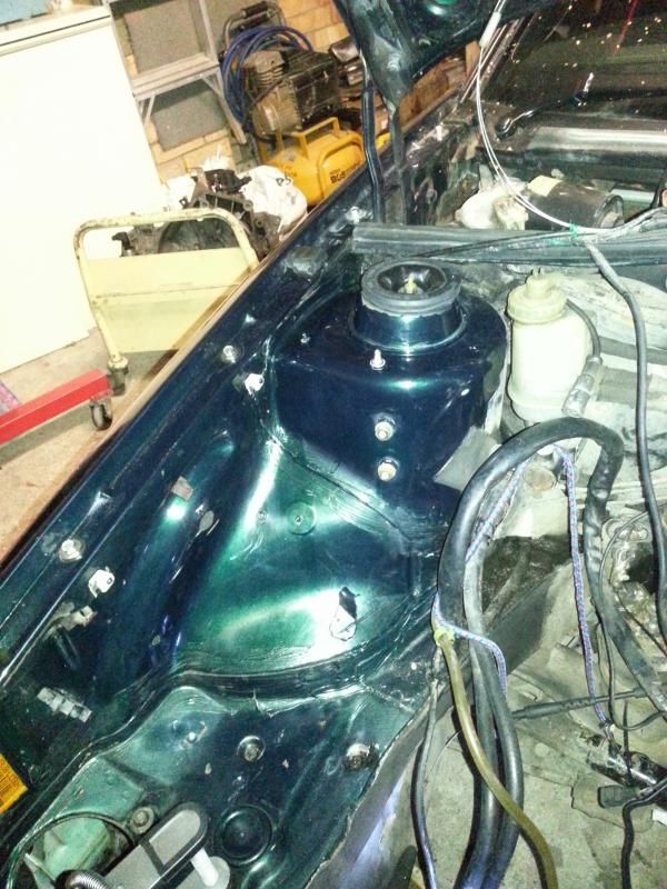

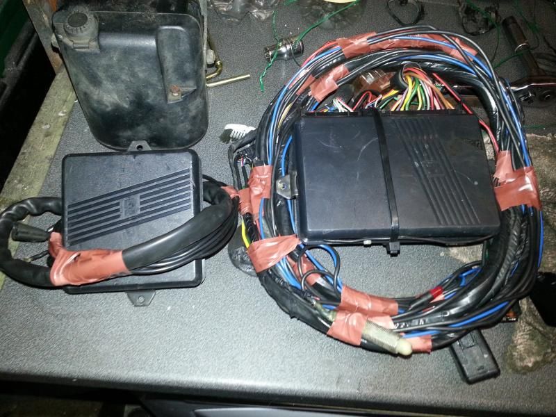

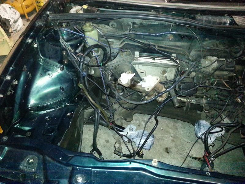

Jim Bowen 1 Posted November 22, 2014 Just put the original manifolds back on for now, Might try and get a supersprint manifold at some point, keeping an eye on german ebay. Been tidying bay up a little, just sorting through the wires etc, getting my head around what i need to remove and fit for the Teves20, think i know where i'm going now. Messy bay.. Uncleaned side, very dirty, it has done 220,000miles, driven all year round. Decided to start on one side and just work my way around the entire bay, otherwise i just seem to stare at it and wonder where to begin :lol: Got the ABS loom separated out in the bay and then started taking the dash out today, Was alot easier than i thought. I want to remove the original alarm system, am i correct in thinking these two boxes are part of that? its the vag/scorpion 5000. Its the 2nd one i'm unsure about. Quote Share this post Link to post Share on other sites

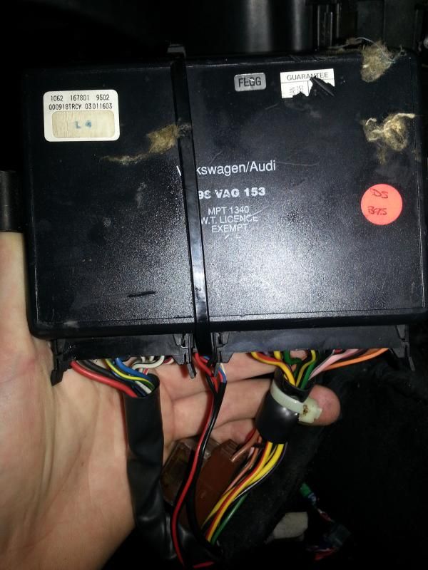

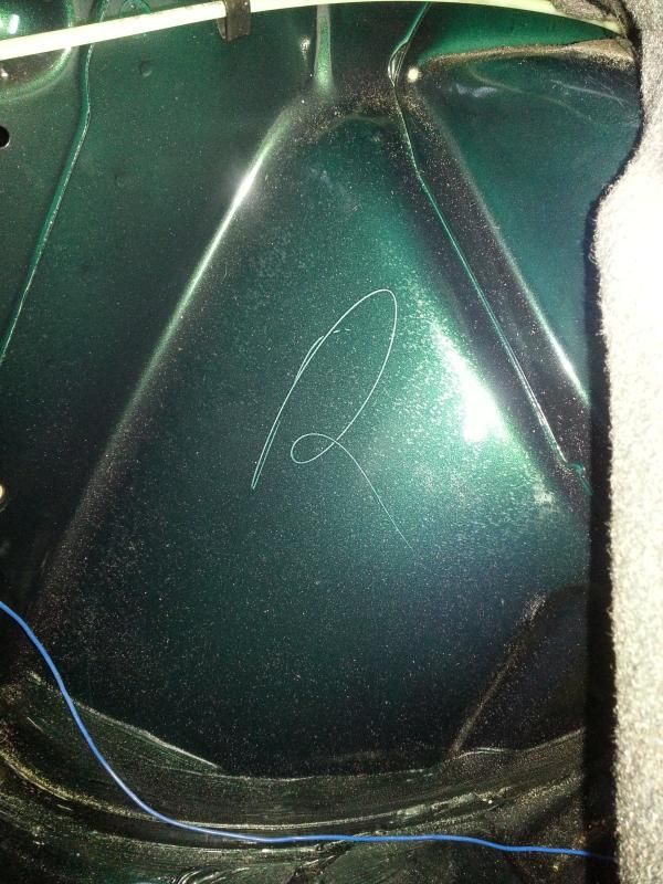

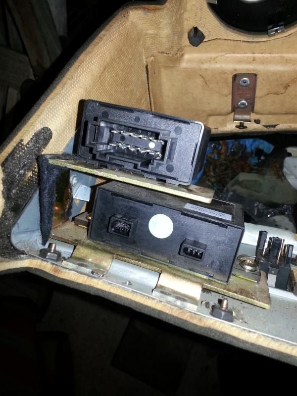

Jim Bowen 1 Posted November 24, 2014 Found an "R" Not sure who did that? :lol: Alarm is now out Another question, what are these boxes fixed onto the inside of dashboard, behind the headlight switch. The spoiler connected and the little plastic ring about ignition barrel connected there as well. Is immobiliser separate to the alarm? Do i need to keep the little halo thing on ignition? Quote Share this post Link to post Share on other sites
fla 9 Posted November 24, 2014 The bottom one with the two small sockets is for the immobiliser (obd2) Quote Share this post Link to post Share on other sites
Jim 2 Posted November 24, 2014 The other is the spoiler module I think :) Quote Share this post Link to post Share on other sites

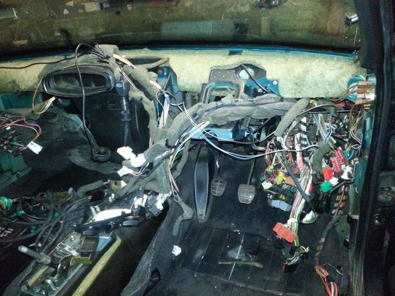

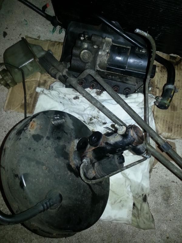

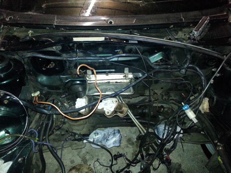

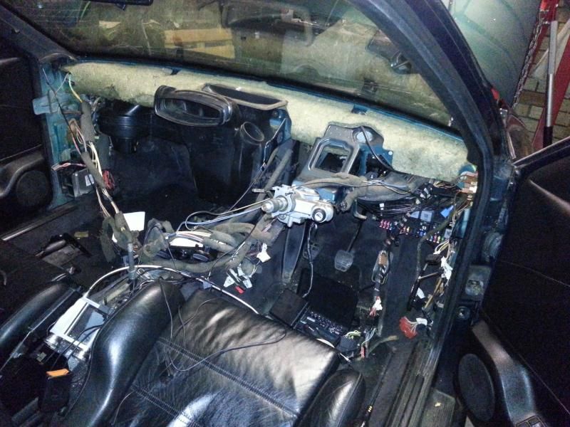

Jim Bowen 1 Posted November 25, 2014 Great, think everything is sorted now then, rescued the immobiliser thing out the bin lastnight :lol: Finally got the complete ABS loom out, Got a right pain near the fusebox. Going to fit the fixed steering column mod while dash is out. Quote Share this post Link to post Share on other sites

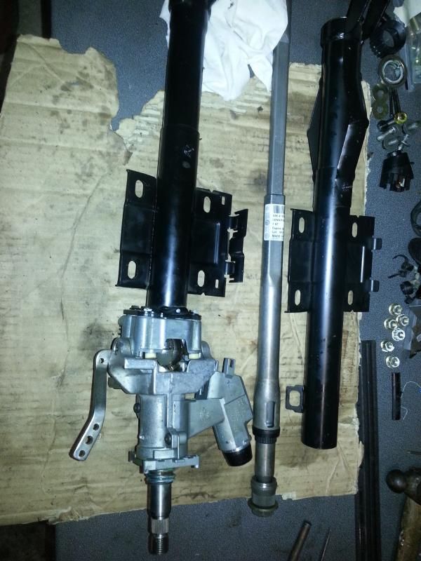

Jim Bowen 1 Posted November 27, 2014 Got more done last night, This ABS removal has been a massive job, imo its one of the biggest i've had to do. I think taking the engine out is easier :lol: Rest of the ABS is out now, i can start cleaning the bay up properly now. Engine bay is getting emptier Interior looking even worse, got the column out to fit the fixed column i've had for ages. Have gone to fit the column and found i have loads of bits missing, i thought i bought a complete kit with everything i needed. I seem to need a whole lock housing bit? Quote Share this post Link to post Share on other sites

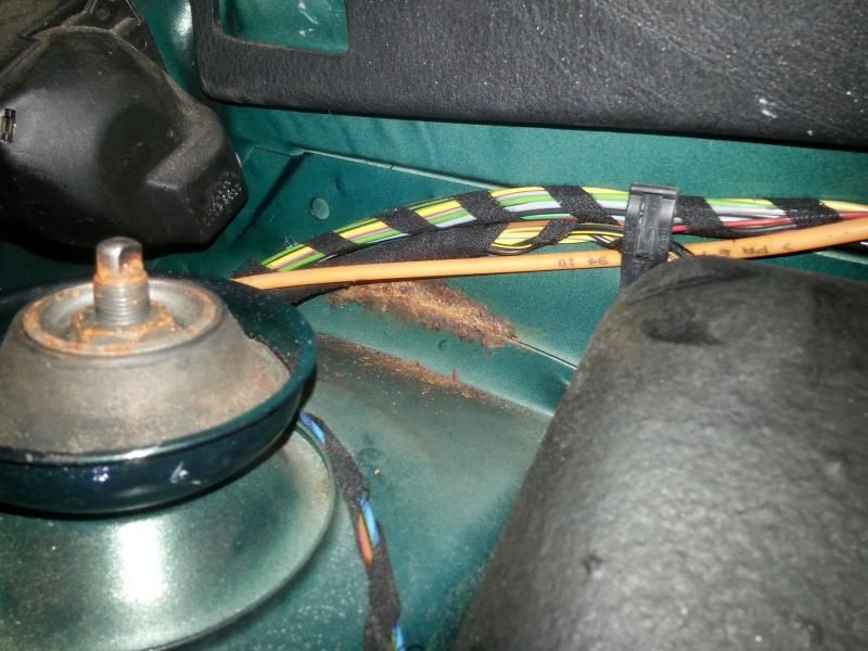

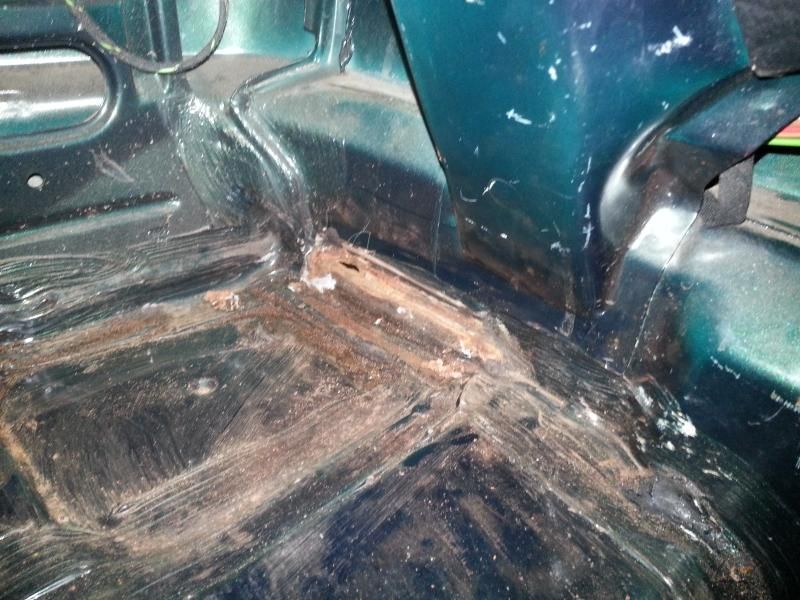

Jim Bowen 1 Posted December 8, 2014 Got the rear stripped out, mainly looking for rust (which i found) Noticed the rust on top of shock, which was odd because they are quite new and other side was fine, then once carpet was out i saw the rust on the seam there. And then this bit which i've noticed in the past, Its looking from inside the car towards the boot, carpet was wet as well, so not sure where that water is coming from. Quote Share this post Link to post Share on other sites
Jim 2 Posted December 8, 2014 Is that not actually a little hole in the floor there in that last picture? :( Quote Share this post Link to post Share on other sites
