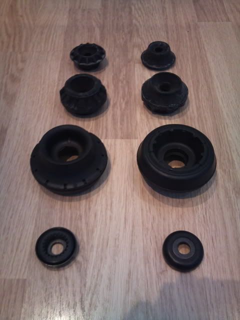

Bought some new suspension mounts/bushes today, hopefully will tighten the handling up even more.
1J0412249 - Bearing
357412331A strut mounting (vr6 version)
191512335 - rear mount
191512333 - rear mount
and the following to help wire up the OE centre console
1JO972704 4 pin plug
000979133E - wire set
