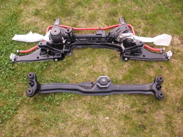

Kevin Bacon 5 Posted February 26, 2010 Interesting. My R32 bushes slotted right in with no fettling required. The benefits of VW not changing things unless they absolutely have to :D Quote Share this post Link to post Share on other sites
quicky1980 0 Posted February 26, 2010 kevhaywire said: Interesting. My R32 bushes slotted right in with no fettling required. The benefits of VW not changing things unless they absolutely have to :D I can't be sure until they are in the wishbone, but just trying to slide them into the subframe met with slight contact. The contact may be caused by the 2 layers of powder coating though :lol: Quote Share this post Link to post Share on other sites

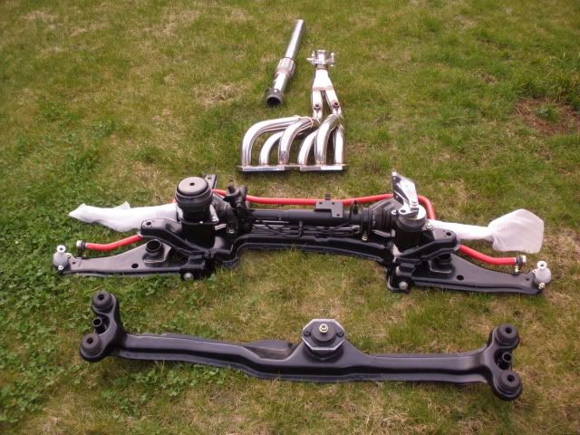

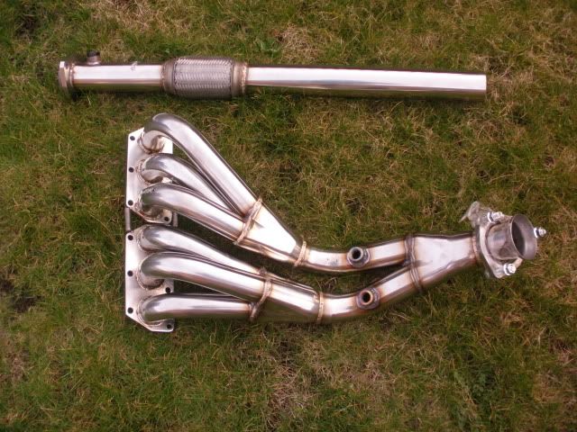

quicky1980 0 Posted March 9, 2010 Called Mark at SWICT and he's pretty much done the loom work :D He said he had trouble with the ecm chip and had to send it off to a friend to get sorted :eek: But he should get it back soon. Spoke to dubpower and I forget his name (useless with names!) but great guy to talk to. really friendly and helpful. decided to go with the whole package, manifold, lambdas in manifold and decat pipe...its costing a pretty penny but should be worth it! Quote Share this post Link to post Share on other sites
quicky1980 0 Posted March 20, 2010 Ive now got the dubpower manifold and de-cat pipe. Looks very nice 8) and now just waiting for the loom and ecm to be sent back from SWICT. Started to assemble the subframe after having a nightmare trying to press in the r32 bushes into the wishbones. Today I cleaned up the steering rack ready for a few coats of paint and will give the gearbox a try too at the same time. Anyone know on how best to plumb up the coolant hoses? I need to check but there seems to be no connections on the throttle body like you have on the vr6. what gives? Quote Share this post Link to post Share on other sites

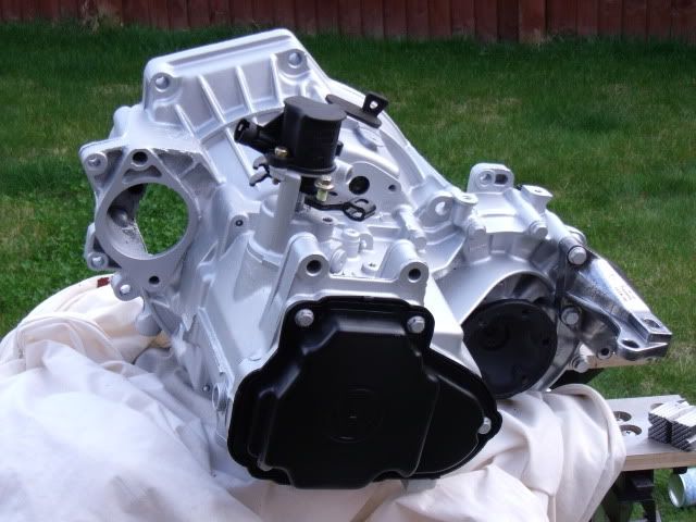

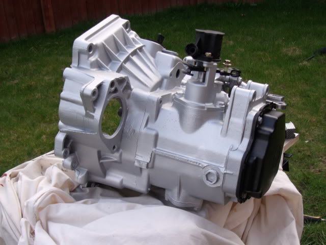

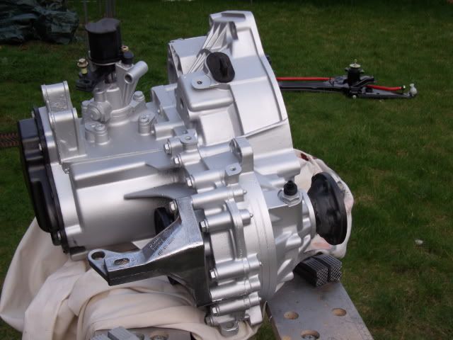

quicky1980 0 Posted March 27, 2010 cdem said: quicky1980 said: Slimg60 said: Looking good, how far off completion do you think you are? I think I should now have all the parts to do the conversion. So my aim is to start in on the easter weekend. Im probly not much use but if you need a hand feel free to give me a shout and ill help if im available :D cool cheers Chris, always need a spare pare of hands. Today I spent cleaning and repainting the gearbox, took a bit of time but the end result was worth it. The hardest thing of the day was taking the old road ends, they were a git to get off even when ground, heated and hammered! But now they are off I can now fit the new boots once they arrive. Slotted the box onto the engine, bit fiddly but got there in the end. Quote Share this post Link to post Share on other sites
quicky1980 0 Posted March 28, 2010 Been a good day today, managed to buy some 312 brakes off ebay so should have some better stopping power compared to the current 288mm's. Took the old exhaust off and fitted the new one. Interesting enough the gasket should some wierd gas routing. I guess this is for the EGR flow? Ne dubsprt manifold is on and looks sweet. The aux belt i got is too short so will have to find a slightly longer one. re-routed the wiring to how is should be and now the engine looks like what it should. Quote Share this post Link to post Share on other sites

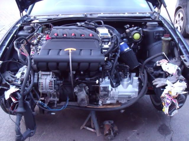

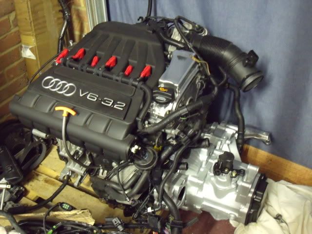

quicky1980 0 Posted April 5, 2010 cleaned up the engine bay and painted it all satin black. Made it look alot smarter. Had some mates come round to slip the new engine in. Decided to go with the standard cooler and not use the mocal air cooler. So will fab up a new bracket, will take notes for future conversion if anyone needs one making up. Loom should be delivered tomorrow, which is about time really! :censored: Damn parcel force! Quote Share this post Link to post Share on other sites

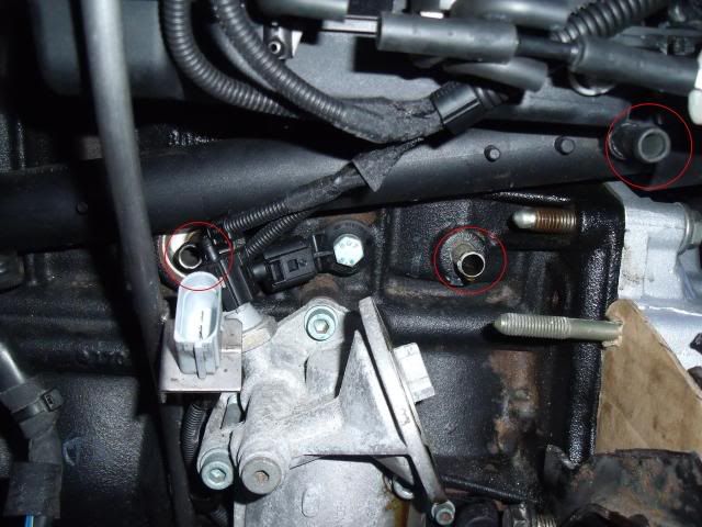

quicky1980 0 Posted April 6, 2010 Right, taking a little bit longer than I had hoped. Probably a day or so behind, but that's more to do with the loom being late turning up. Here is the promised picture of the engine in situ. I'm a little bit unsure how to solve the following problem. Do I plug up one of the block spigot connections and connect the remaining one to the oil cooler and the crack pipe spigot to the other end of the oil cooler? If so which block spigot needs plugging up. I want to make sure that I don't plug up something important you can also just about see the confusion I'm having with reconnecting the egr and variable valve control valve back up. If any one has a schematic on how it should be, please pass it on...ta. Oh and where the fuel lines run, I have a third pipe. I presume its going to the fuel tank but Im not sure what it does or what I should do with it. It was connected up to a green valve thingy?!? Quote Share this post Link to post Share on other sites
