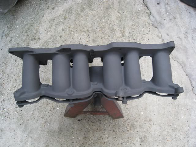

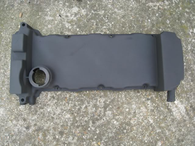

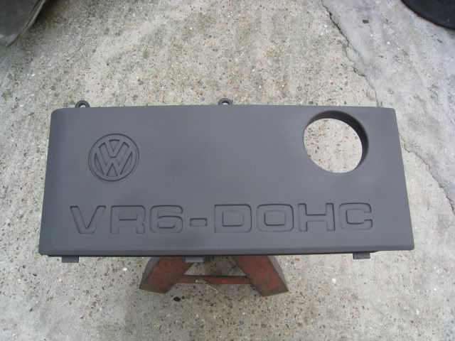

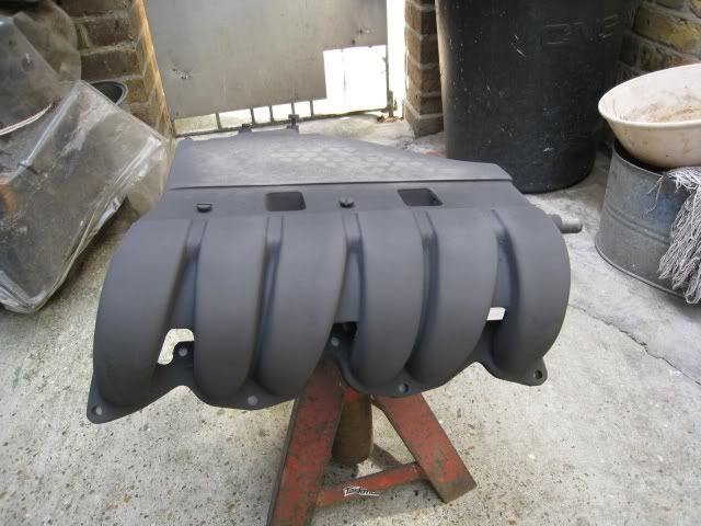

zak 0 Posted October 27, 2008 The manifold, rocker cover etc were degreased and pressure washed then wiped down with meths. I sprayed them with matt black heat resistant paint. I didnt rub the metal down as i wanted to keep the grain so it looked oem, the paint was sprayed in thin coats to let this show through. heres some pics Quote Share this post Link to post Share on other sites
