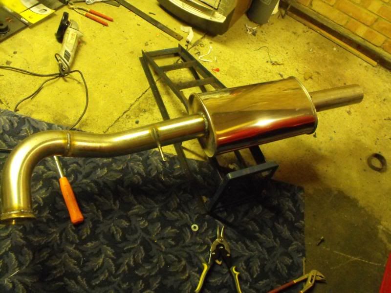

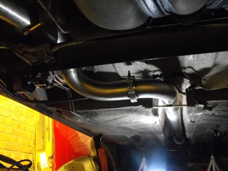

im building my 3" exhaust,got some bits tonight and made up the centre/over axel section.....this will be followed on by the rear silencer and fully welded up by tommorow.

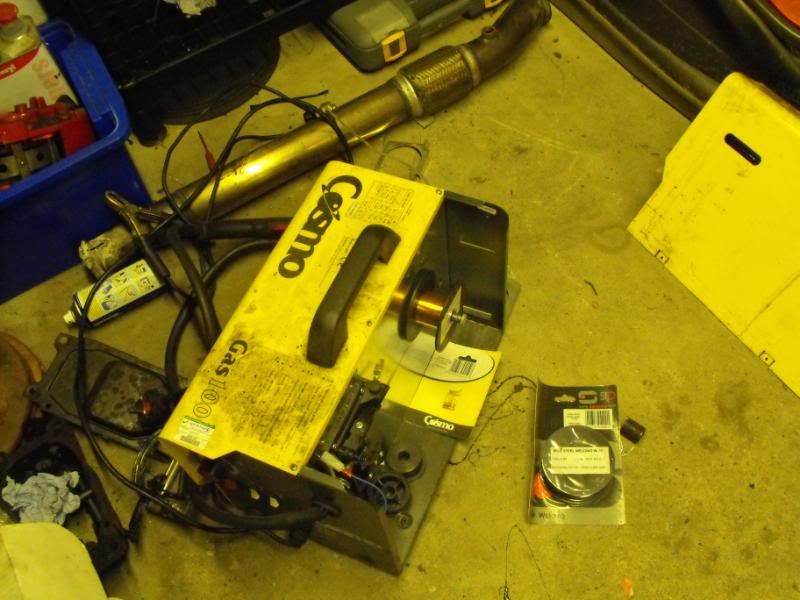

My trusty old 100amp mig with stainless wire(not on yet) and a argon/co2 mix for gas...
Lots of bits to make fit!

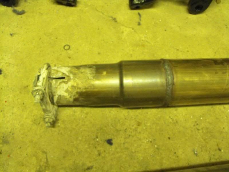

This was my reducer,3" down to 2,25 had to clamp this over my magnex!
gotta say one of my favourite corrado's of all time! just gets better, none of this chequebook modding!
top work as usual james - i have a similar reducer in mine! (think mine might even be down from 3.5 to 2.25 :? )

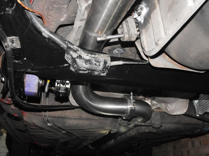

Nice work mate, it must be mega tight on clearance over the rear axle, Im sure youll get round that though :)

As for axel clearance...there is some ...just :lol:

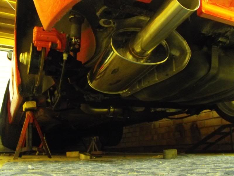

Is that the only box you are running james, if so won't it be a little loud?
ian
yip just the one box ans i will tell you how loud it will be this weekend... :grin:
Its not a daily car...just fun so i dont mind if its a bit loud.
More of tonights work....still need to do back mount.
and its loud...but nice,i can imagine on the road its a different story! :lol:

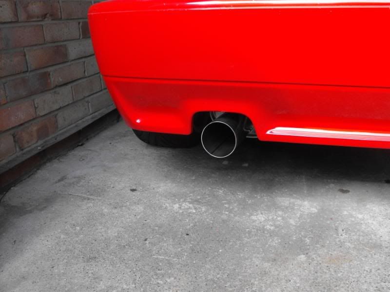

looking good buddy. you leaving the tailpipe like that?
Cheers Pete,im going to polish up the tailpipe and thats it! i like it simple. :grin:
I need to video the [strike:3g72rdgz]noise[/strike:3g72rdgz] i mean lovley-ness of 3" all the way! :norty:
Cheers Bud,you need to hear this thing now! :tongue:
all done now,hangers etc...no knocks...no rattles etc.

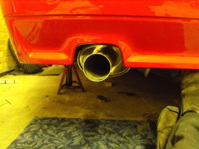

Polished the tail pipe up and the Sound is savage!... im in love :luvlove:
really like the round tailpipe, think thats what i'm gonna have on mine next,
