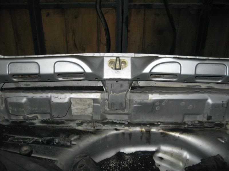

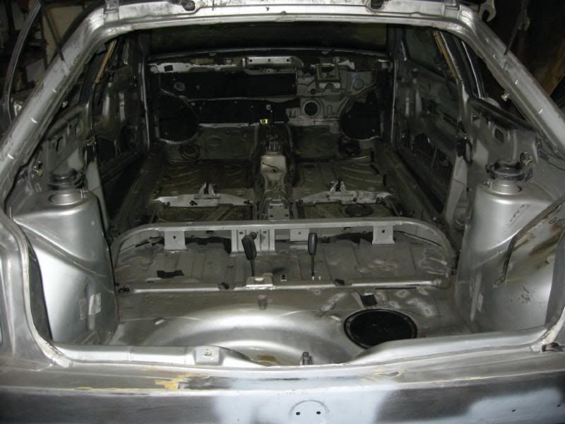

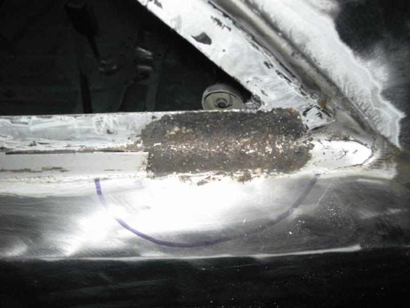

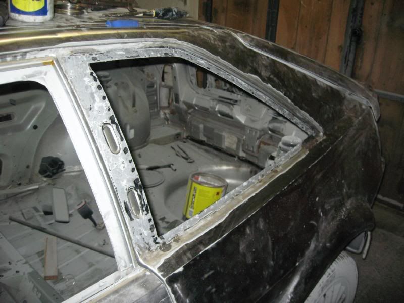

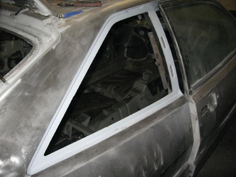

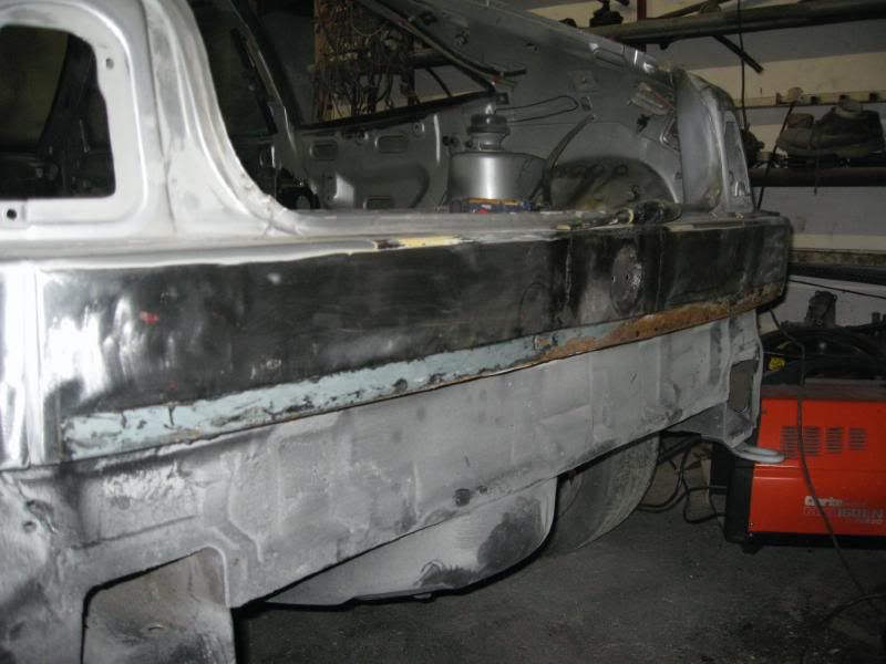

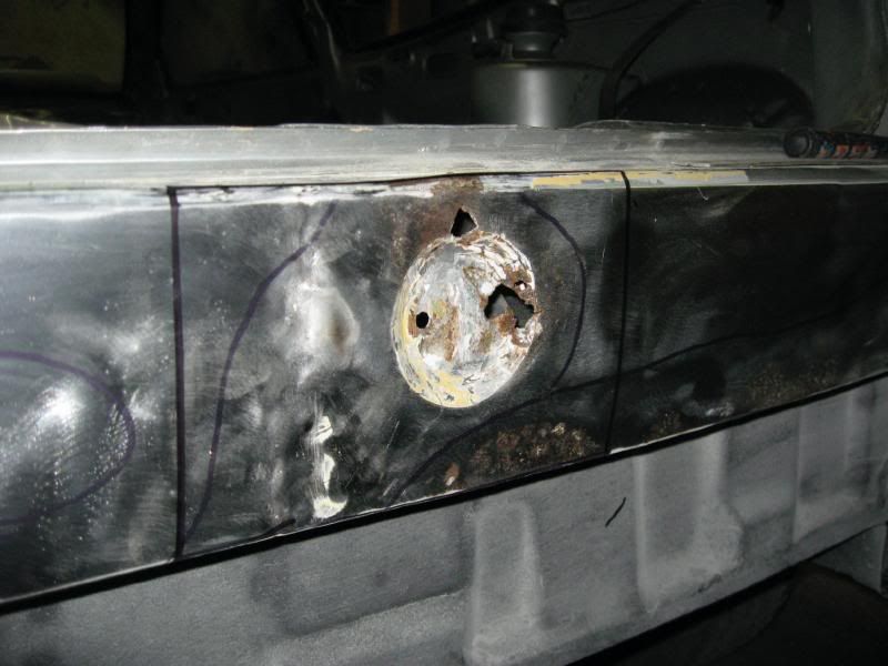

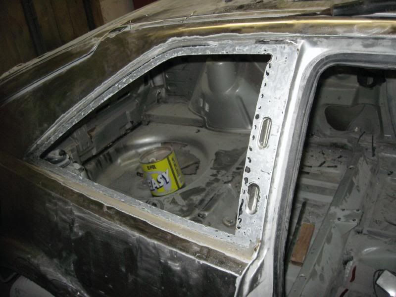

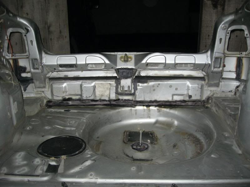

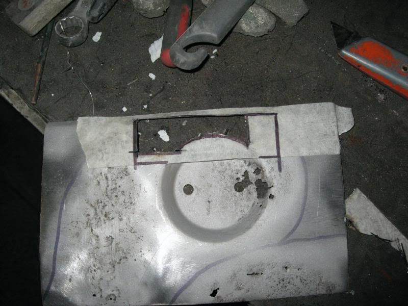

20vturbo 0 Posted February 16, 2009 took out the rear windows, easy enough found some rust on the passenger side, its not too bad sorted the rust then striped it all back to bear metal and primed it with acid 8 next job, sort out the rear pannel when i have the pannel welded back in i am going to cut the whole bottom off the rear pannel and put a new piece in. little bit messy, been doing some sandblasting mostly around the rear to clean up all the seams Quote Share this post Link to post Share on other sites

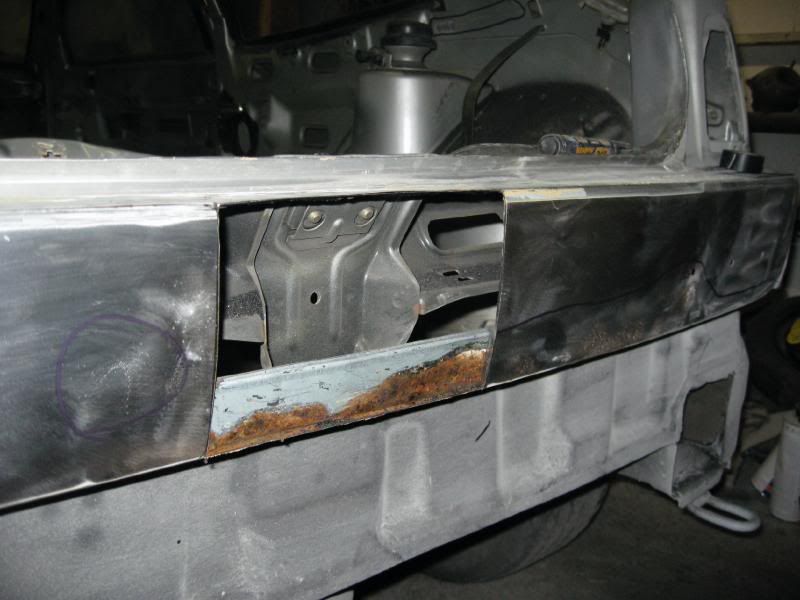

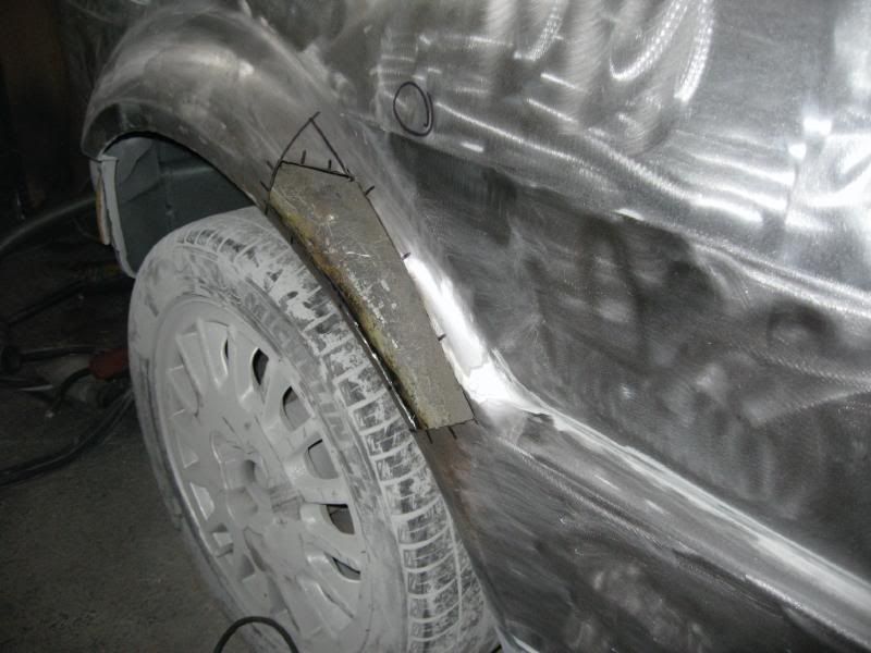

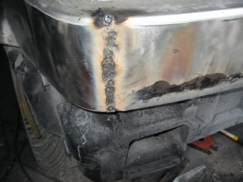

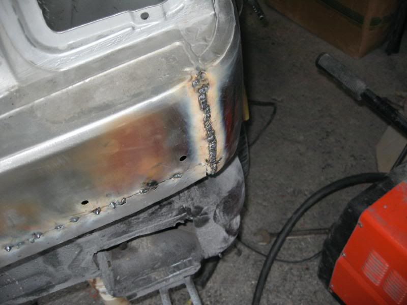

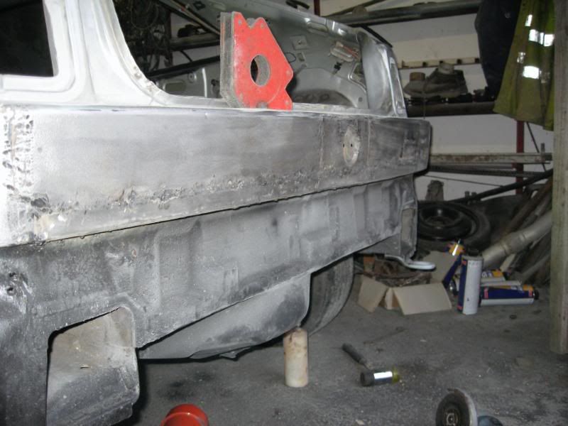

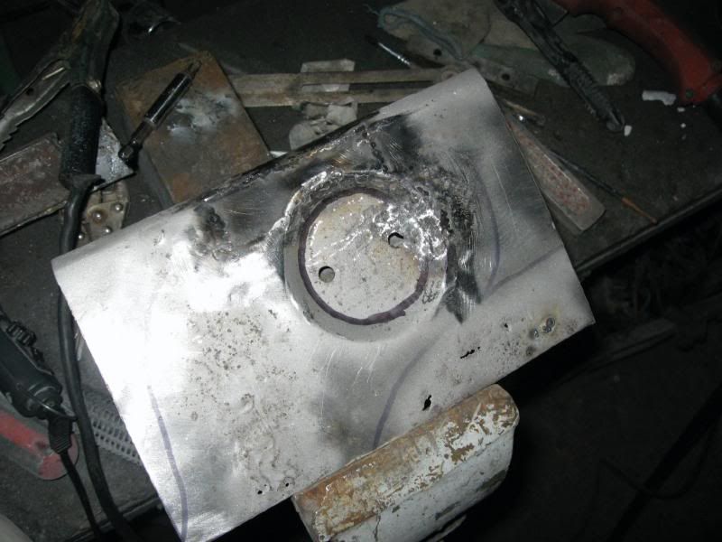

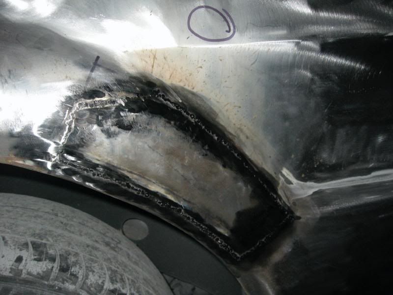

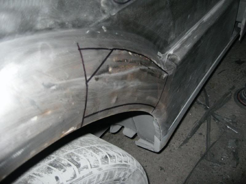

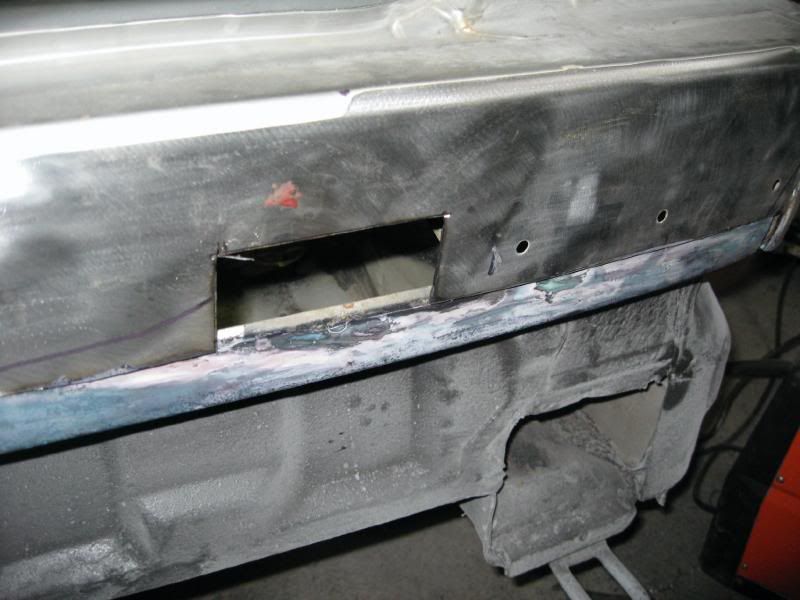

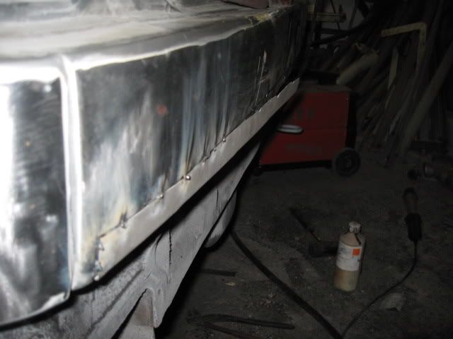

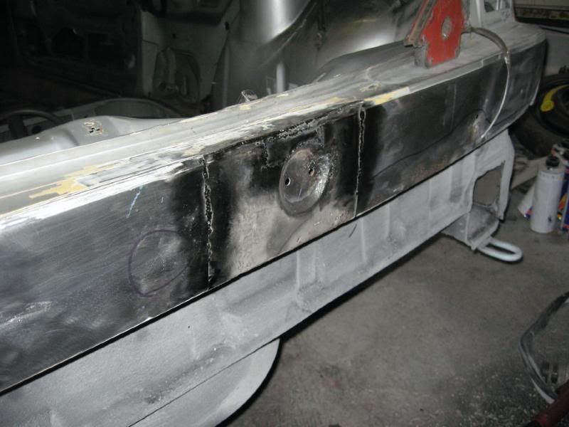

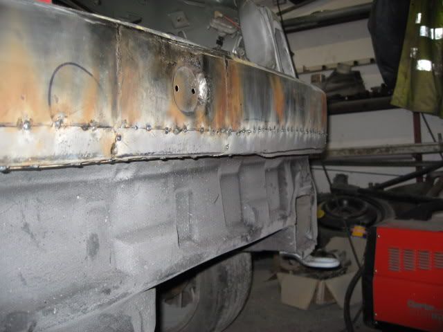

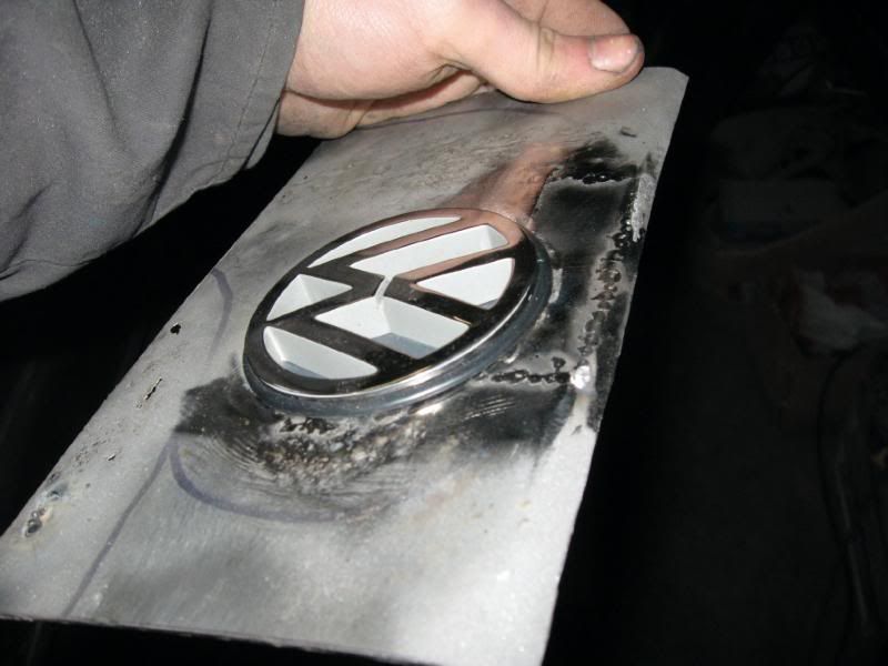

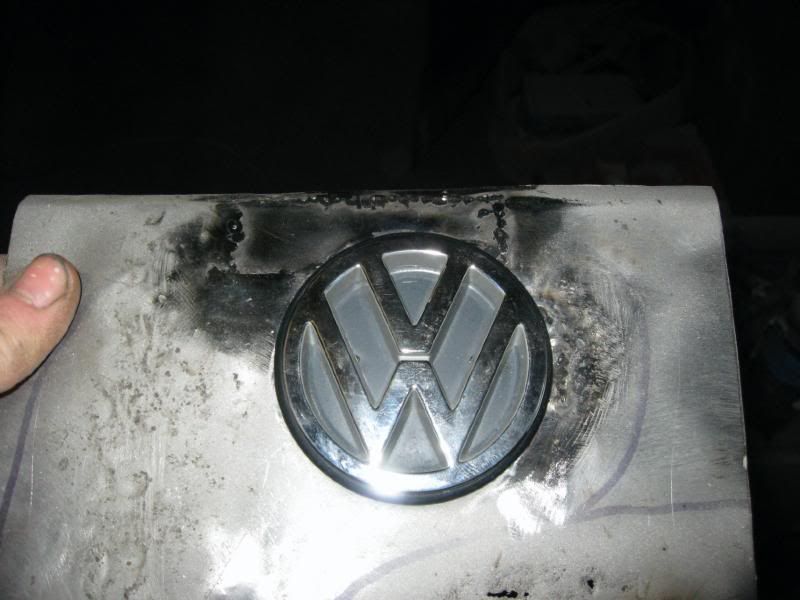

20vturbo 0 Posted February 20, 2009 just a small update before i go away for the weekend. got the panel welded in and then i did this than i went completely made and cut some more out. (the red smudge is my blood) starting to put it back together nearly there. (the brown stuff is smoke from the welder) welded up the gaps in the panels all done, dont worry in this pic i hadnt finished cleaning up the bottom so thats why theres snots along the bottom edge. there was a pretty big dent in the rear quarter and i couldn't get it from inside so out it came. beat it into shape and popped it back in the inside is pretty much there just need to give the whole thing a sand and throw on some primer. its so close to going to the body shop. cant wait Quote Share this post Link to post Share on other sites

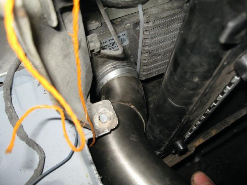

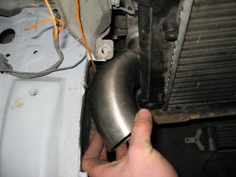

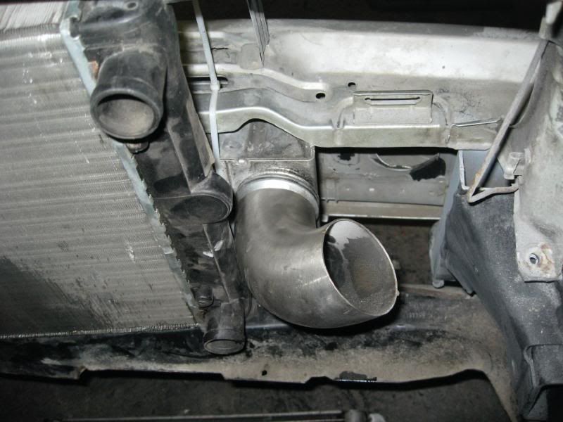

20vturbo 0 Posted March 3, 2009 i have to sort out the mounting of the intercooler and oil cooler before it goes to paint so i had a look at it tonight. im fairly happy with the position and the pipe work is as good as its going to get. have a look and see what you think. opinions welcome. the pipe will be alloy and im getting it tig welded to the intercooler the pipe work is going to be 3" to 2.5" reducer from my throttle body. from there to the turbo will be 2.5". Quote Share this post Link to post Share on other sites

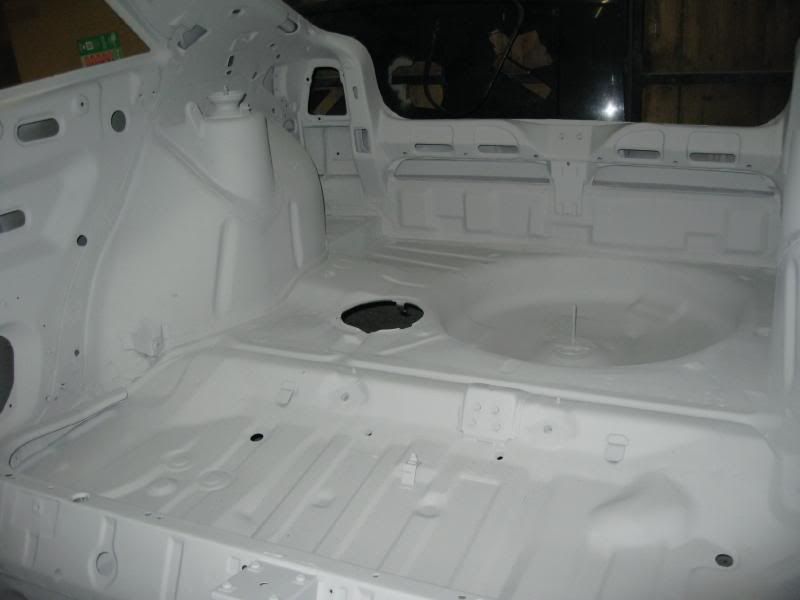

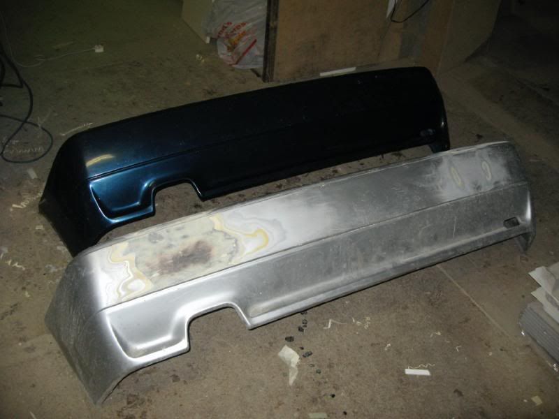

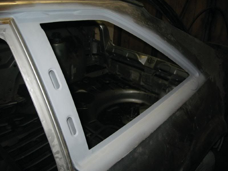

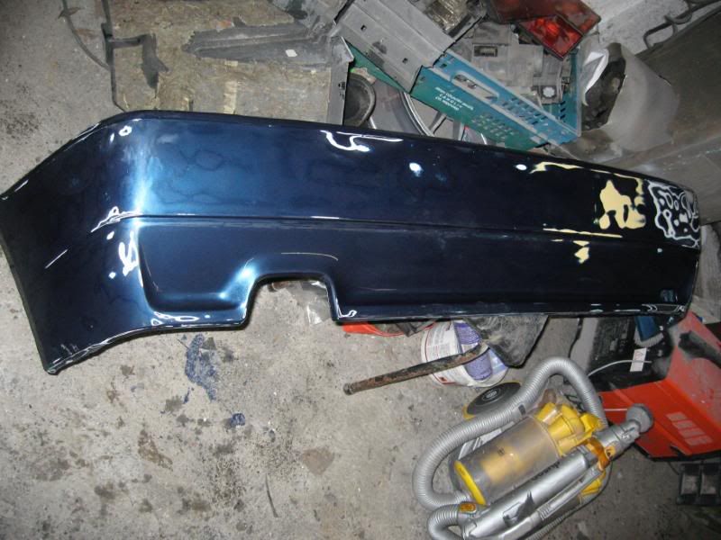

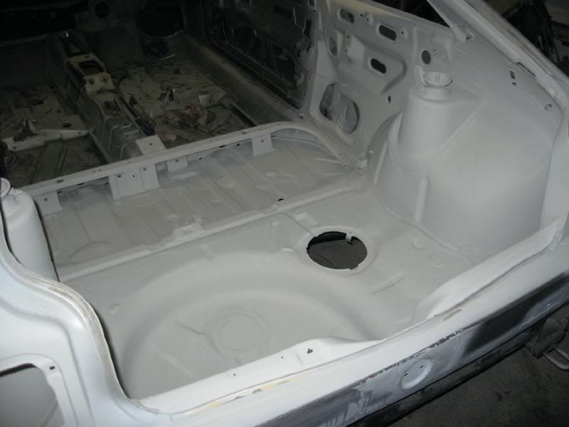

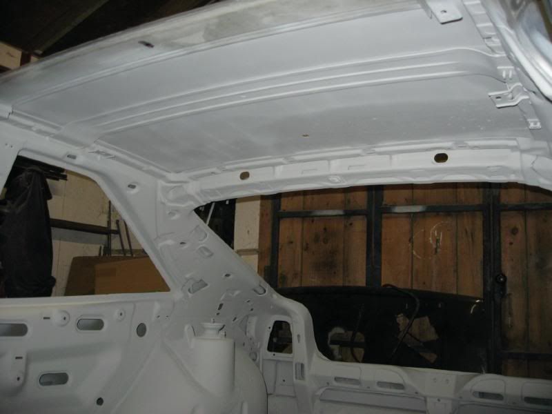

20vturbo 0 Posted March 25, 2009 took out all the old sealer and put in some new stuff, then i primed it after alot of work i finnaly got half of the inside primed the old bumper was pretty well shagged so i got another one in very good condition its ready to be painted so im going to drop it up to the painters tomorrow. i just want to do the bumper to see if i like the color. Quote Share this post Link to post Share on other sites
