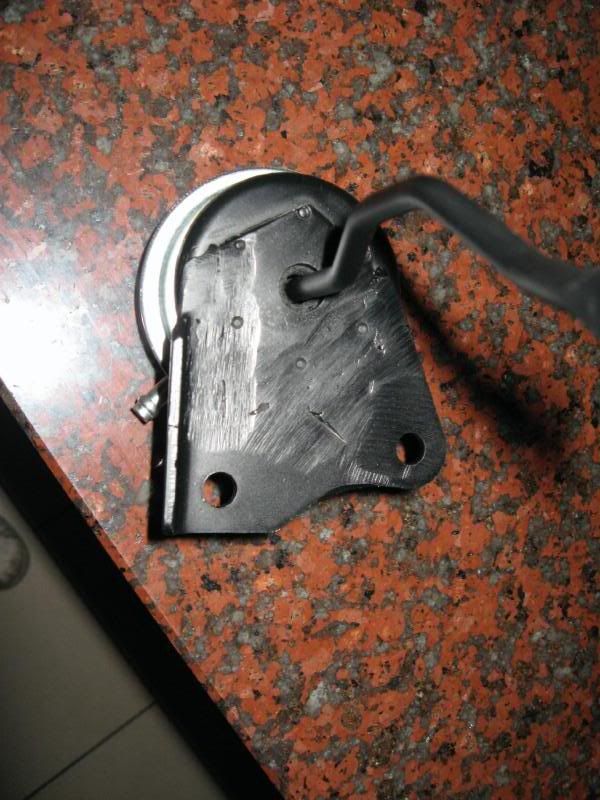

20vturbo 0 Posted May 6, 2009 turned the bracket on the waste gate actuator around to suite the new turbo position custom manifold, job done Quote Share this post Link to post Share on other sites

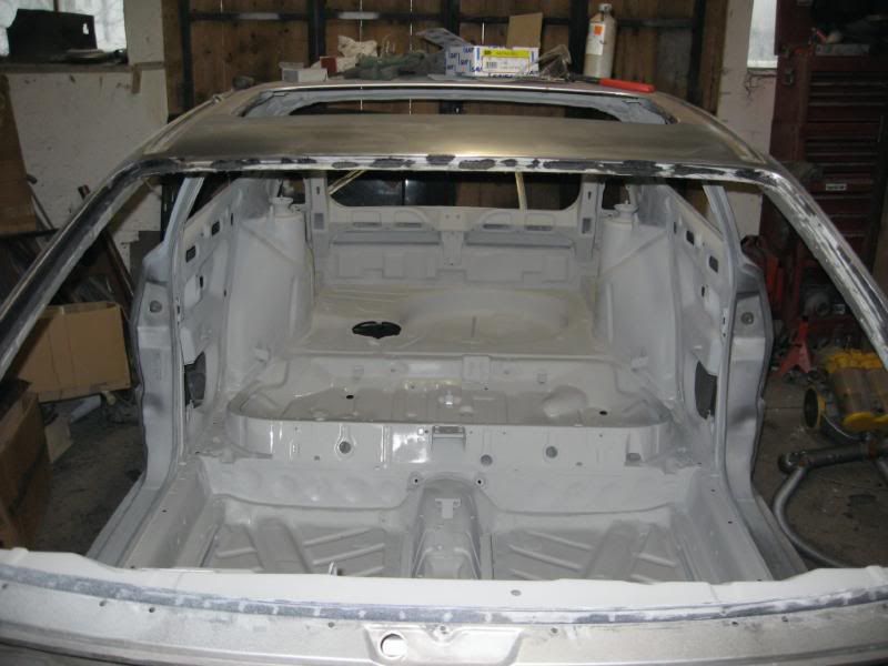

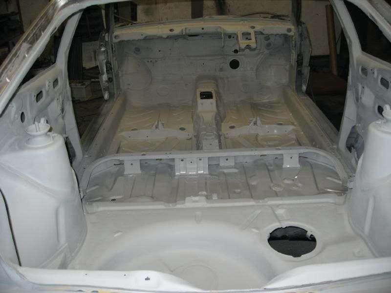

20vturbo 0 Posted May 19, 2009 i was in the bodyshop today and took some pictures, its coming along nicely. this is filler primer, after that it gets standard grey primer, base coat and then clear all the lines on the body have been kept as sharp as possible, this will really show the shape of the car(yet another advantage of going back to bare metal) Quote Share this post Link to post Share on other sites

20vturbo 0 Posted May 19, 2009 waynos said: looking good,when are we gunna see some colour? i cant wait to see it theres a stupid nissan micra in the way of mine :mad2: at the moment its being worked on now and again. as soon as the micra is gone their going to be working on it full time. it will be done in 2-3 weeks, maybe even less :) Quote Share this post Link to post Share on other sites
