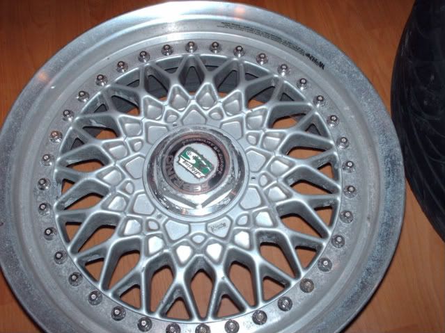

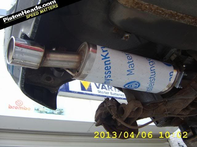

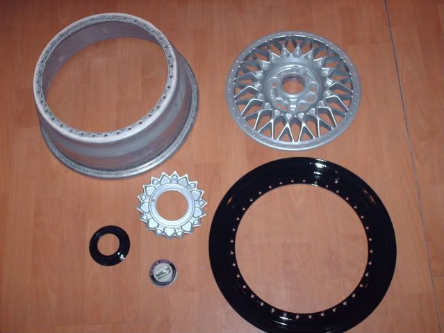

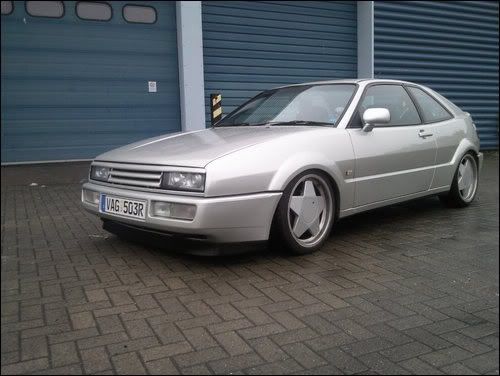

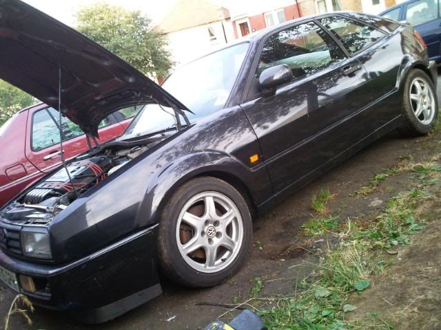

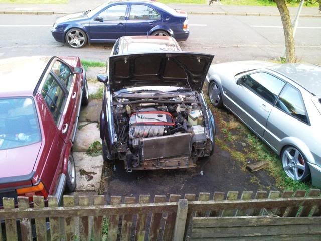

vardo 0 Posted May 2, 2009 (edited) missed my golf vr6 so much i bit the bullet and got me a rado vr6,needs a bit of work ,but its been resprayed,got a brand new stainless exhaust,and a set of lowering springs thrown in,also a set of alloys(sebrings 3 piece split rims which dont fit :uhm: )its sitting on various different size steel wheels lol,it has a running problem but i will investigate this week,defo needs a coilpack Edited November 16, 2013 by vardo Quote Share this post Link to post Share on other sites

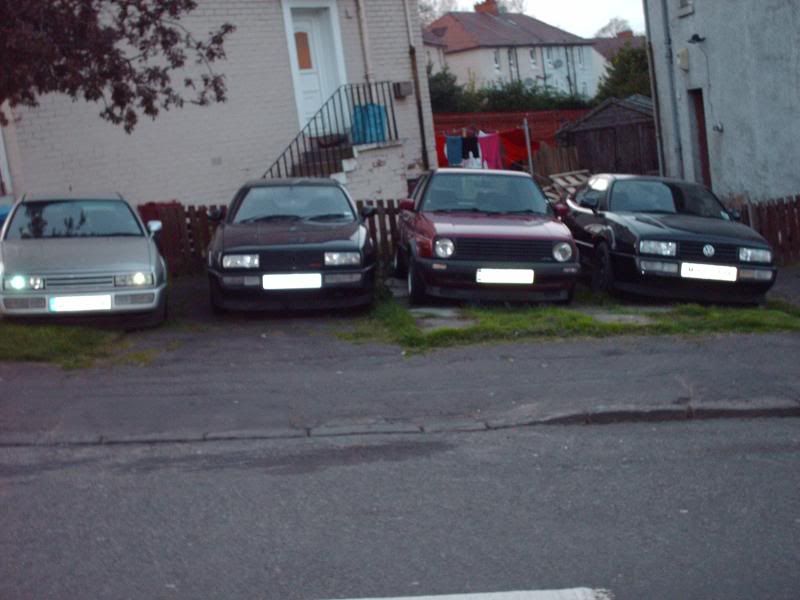

V-Dubstar 0 Posted May 3, 2009 Is that ur cat gettin' a piece of the sebrings's? :lol: They all ur Dub's in the pic? :salute: Quote Share this post Link to post Share on other sites
vardo 0 Posted May 4, 2009 Is that ur cat gettin' a piece of the sebrings's? :lol: They all ur Dub's in the pic? :salute: yeah cat having a good sniff about them lol all my dubs and also have bora and mk2 golf gti just sitting out of view lol ive got it bad !! Quote Share this post Link to post Share on other sites

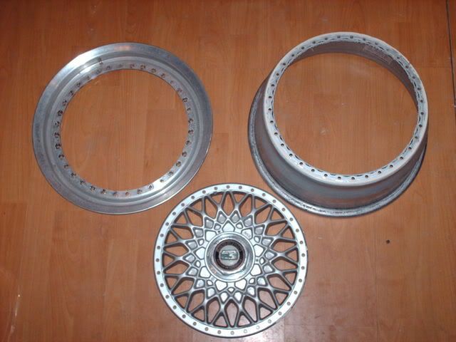

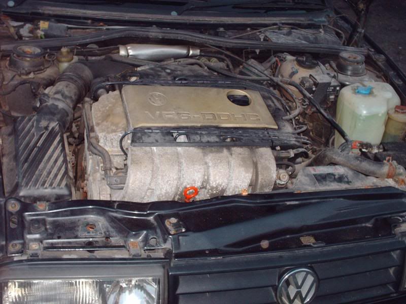

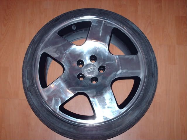

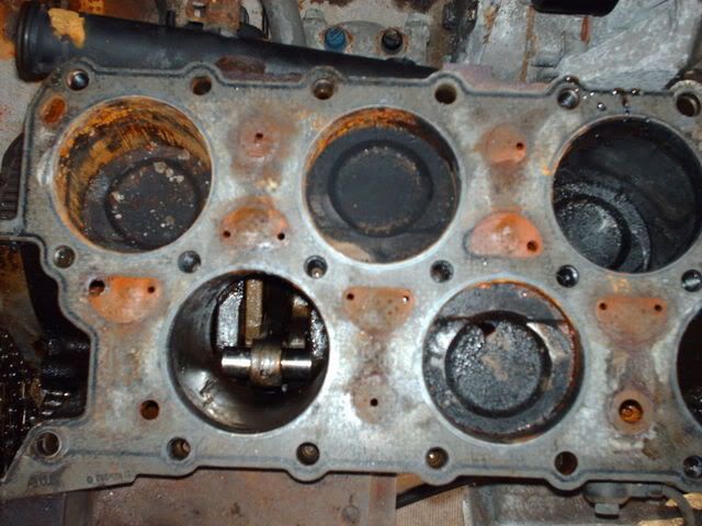

vardo 0 Posted May 4, 2009 well after a quick investigation,the head gasket is shot,all emulsified,the mechanic i bought it off,obviously knew,he started it and said it wasnt running properly,but i saw the crack in the coilpack arcing so didnt check further doh,it must have been gone for a bit coz the white sludge in the engine didnt just happen.i towed it home coz of no tax or mot ,so didnt drive it,ce la vie! anyways save the pennies and put it in somewhere to get fixed. had a go at the alloys,dismantled them and did some refurb work,1 down 3 to go,im gonna put my tt comps(kept them from my mk3 vr6) on it for meantime,just polishing them back to standard,they got a bit nasty over the winter Quote Share this post Link to post Share on other sites
vardo 0 Posted May 20, 2009 oh well,back to the drawing board,got the call from the garage and the block is cracked on this vr,just my run of bad luck again,looking for an engine,loads of 2.8s for sale but not really what i want,see what happens i s'pose.id just forked out on another set of alloys again doh Quote Share this post Link to post Share on other sites

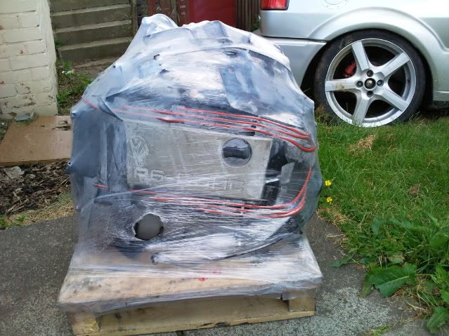

vardo 0 Posted June 12, 2009 delivery :clap: :clap: :clap: :D :D :D Quote Share this post Link to post Share on other sites

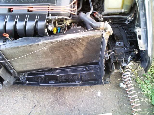

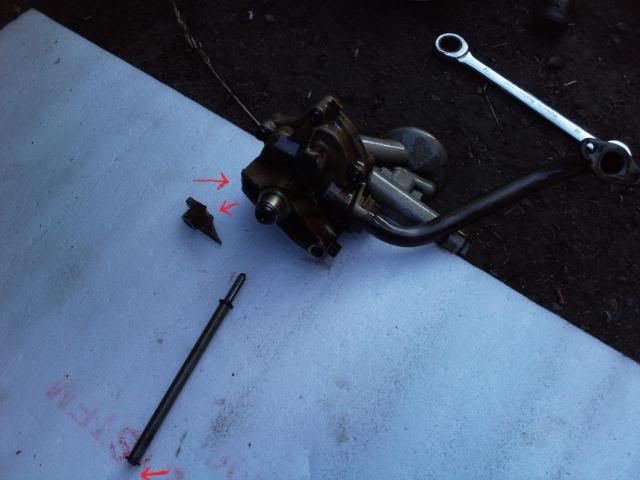

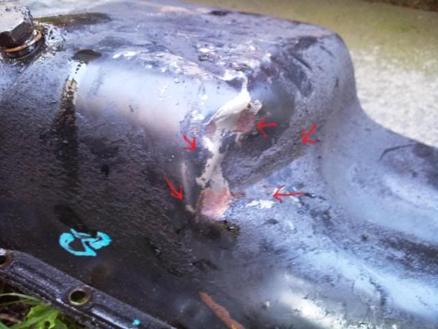

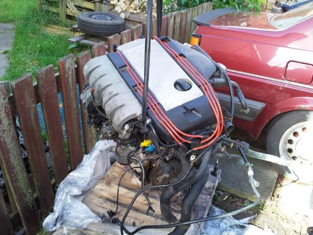

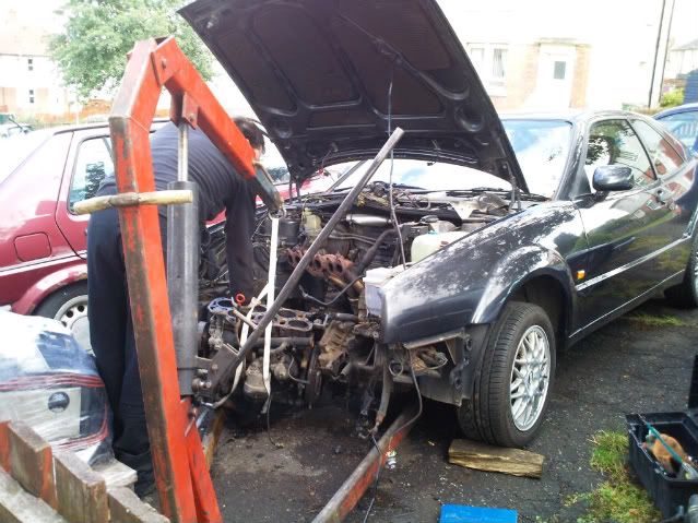

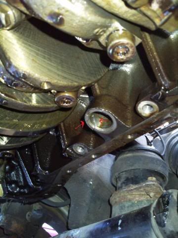

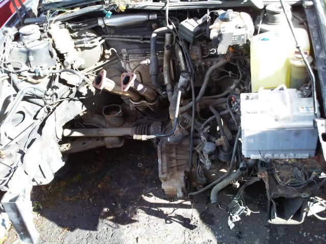

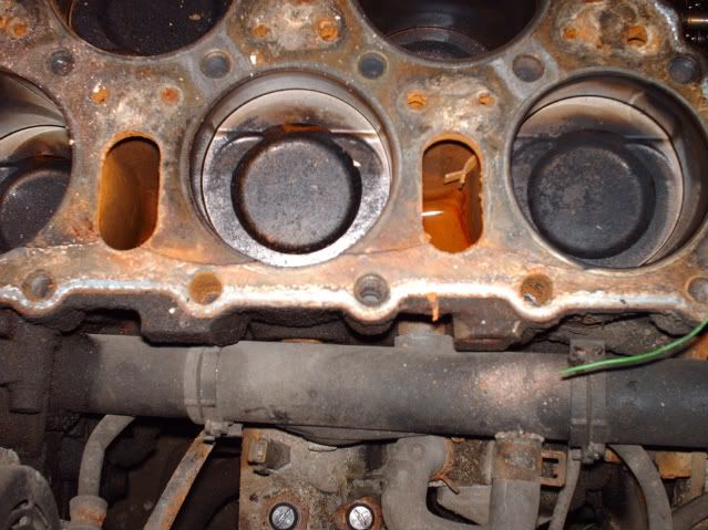

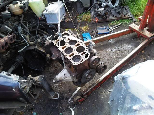

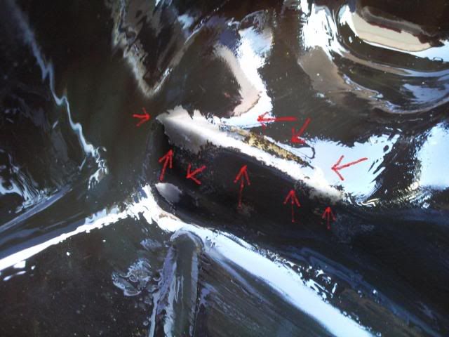

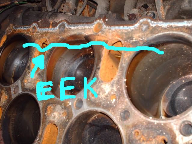

vardo 0 Posted July 13, 2009 well car is back ,minus the head,the block is cracked all the way across the 3 cylinders on one side and cracked across 2 cylinders on the other :OMG: shocking damage in my opinion!! some hours of work later lol it wouldnt run properly,rattling its head in,so noticed no oil was getting up top,so stripped sump off and guess what!!! red arrows point out the probs,sump badly bashed inside the sump.. oil pump housing snapped,and oil pump drive snapped... housing in block of the oil pump drive,snapped... well that was 2 days ago,and ive put the sump ,oil pump,and oil pump drive out the broken engine in,and its fired up and revving beautiful,let the rebuild begin!!! :D :D :D Quote Share this post Link to post Share on other sites

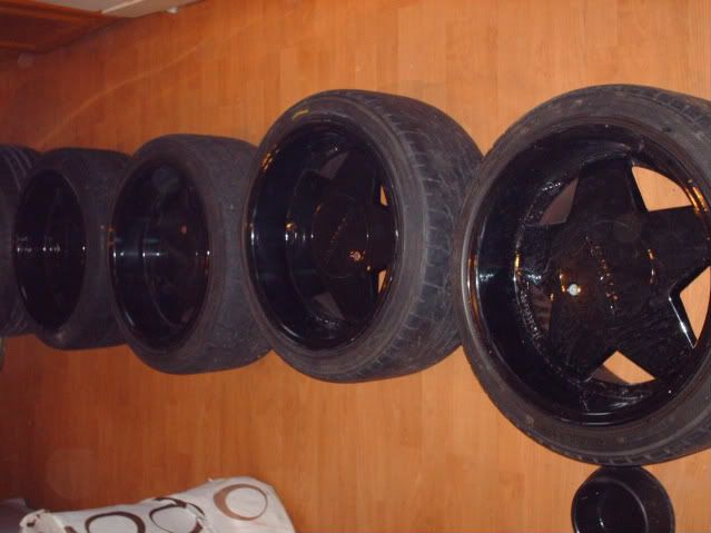

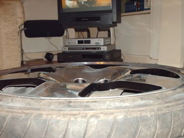

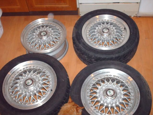

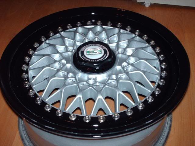

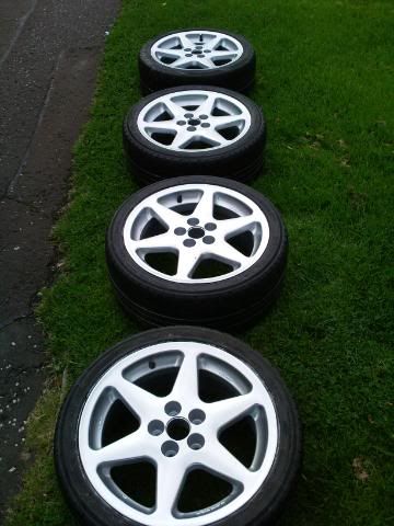

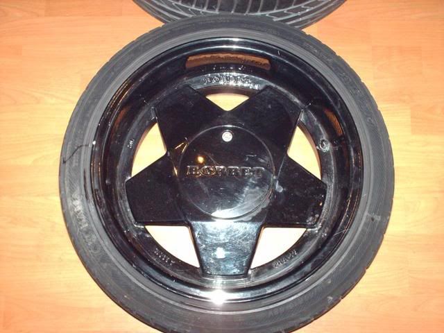

vardo 0 Posted July 13, 2009 i bought these rims 9x16 borbet as with flat caps and have started to strip them back,one done 3 to go Quote Share this post Link to post Share on other sites

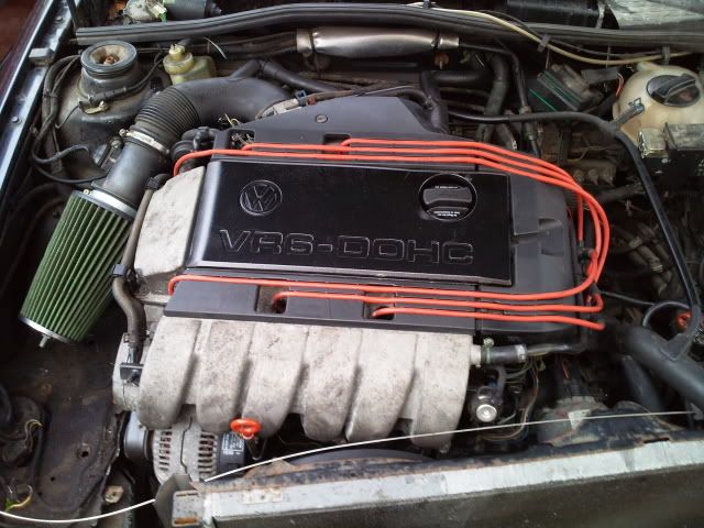

vardo 0 Posted July 16, 2009 got some solitudes for this,for winters till the borbets are ready started tidying the engine,gonna degrease it all and paint up as much as i can,spare inlet is getting painted,tomorrow Quote Share this post Link to post Share on other sites

veedubnutz 0 Posted July 17, 2009 I don;t think Ive ever seen damage like that to a VR block. :gag: Quote Share this post Link to post Share on other sites
mic_VR 3 Posted July 17, 2009 Great to see one getting put back on the road rather than broken, hats off to you sir. Hopefully after your first few issues you'll now have a smooth run. Couldn't help but notice that you never fitted those TT comps in the end? Quote Share this post Link to post Share on other sites

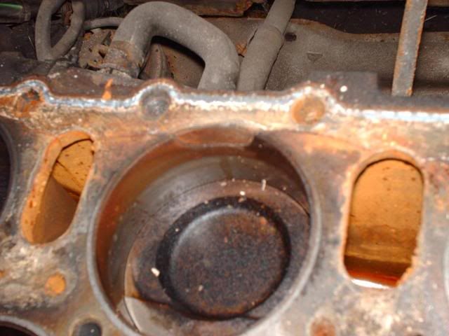

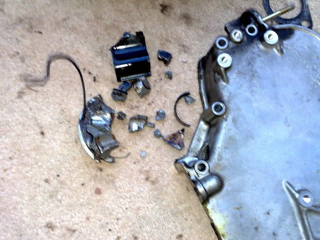

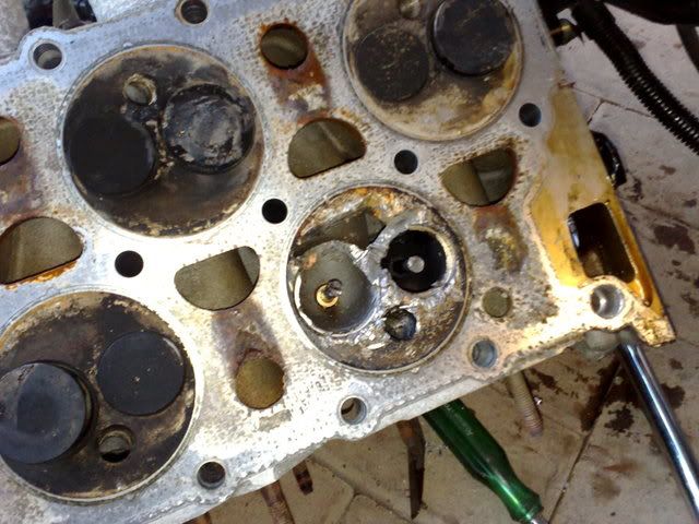

vardo 0 Posted July 17, 2009 :notworthy: :notworthy: :notworthy: Well done mate for getting it sorted!. Get it put back together and get some proper pics up :D cheerz will do more pics to follow Nicely done :) Keep us updated on the progress! thank you sir I don;t think Ive ever seen damage like that to a VR block. :gag: well as it goes,my golf vr started off like this too,nearly put me off vrs for life,check this.... piston missing missing valve ends some bits i found after stripping. Great to see one getting put back on the road rather than broken, hats off to you sir. Hopefully after your first few issues you'll now have a smooth run. Couldn't help but notice that you never fitted those TT comps in the end? also cheerz muchly,i couldnt break a rado,also got a 16v black one which i was gonna break for bits for my other 2 rados but,WHY,few things to fix and thats also another one saved,FOR SALE lol as for the comps,they are sitting here just now freshly polished today with black detailing,selling for cash for my other two Quote Share this post Link to post Share on other sites

CorradoVR6-Turbo 0 Posted July 18, 2009 great to see you getting stuck in,you must have way to much free time on your hands :lol: Ive also never seen a VR block cracked at the top like that before,bottem ends with rods out the side,mangled bore etc but never at the top......wierd :scratch: Quote Share this post Link to post Share on other sites

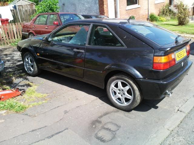

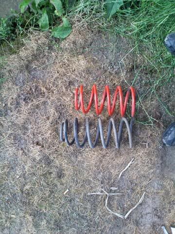

vardo 0 Posted July 26, 2009 had a good dry day yesterday for a change so got some work done.. shocks off and spax springs fitted(until monies for coilies) driveshafts connected,and some other wee bits quite surprised at how low its sitting ,just on springs :D Quote Share this post Link to post Share on other sites

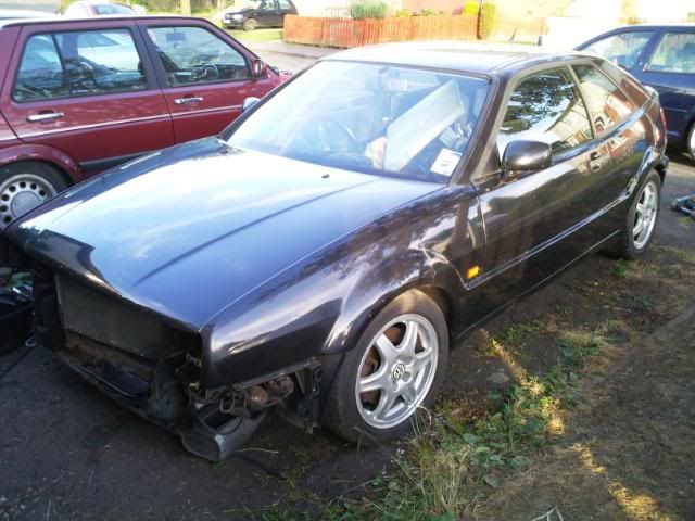

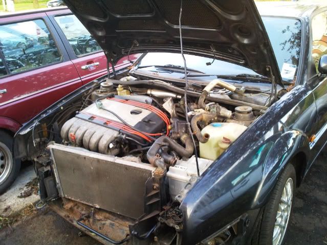

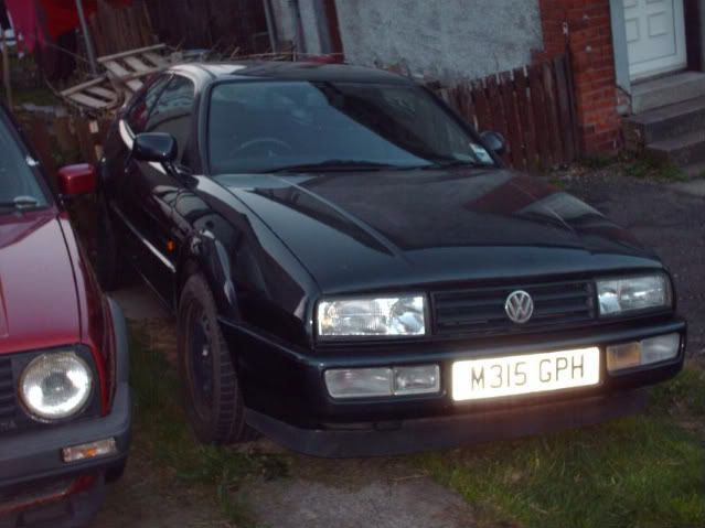

vardo 0 Posted August 6, 2009 im still having probs with this rado at the mo..... runs for 5 mins and then dies,wont restart batteries(4 tried now) wont keep charge power steering wont bleed up still trying to line up gears(but as engine wont run long enough,cant get them right) door handles are gubbed but ive built it back up,so its starting to look like a car again painted the rusty bits front end back on Quote Share this post Link to post Share on other sites

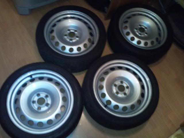

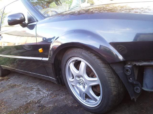

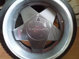

vardo 0 Posted August 17, 2009 cheerz, weather has been that bad lately,work is hard to progress,got the dash back in place,still to get all the electrics back in place.. swapped my borbet cs for my old 16"steelies,which were on my golf vr6 i sold. i really like these wheels,will get them on tomorrow weather permitting borbet cs for these Quote Share this post Link to post Share on other sites
